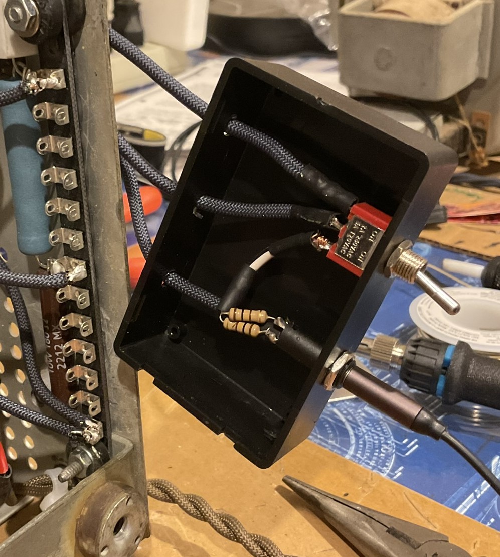

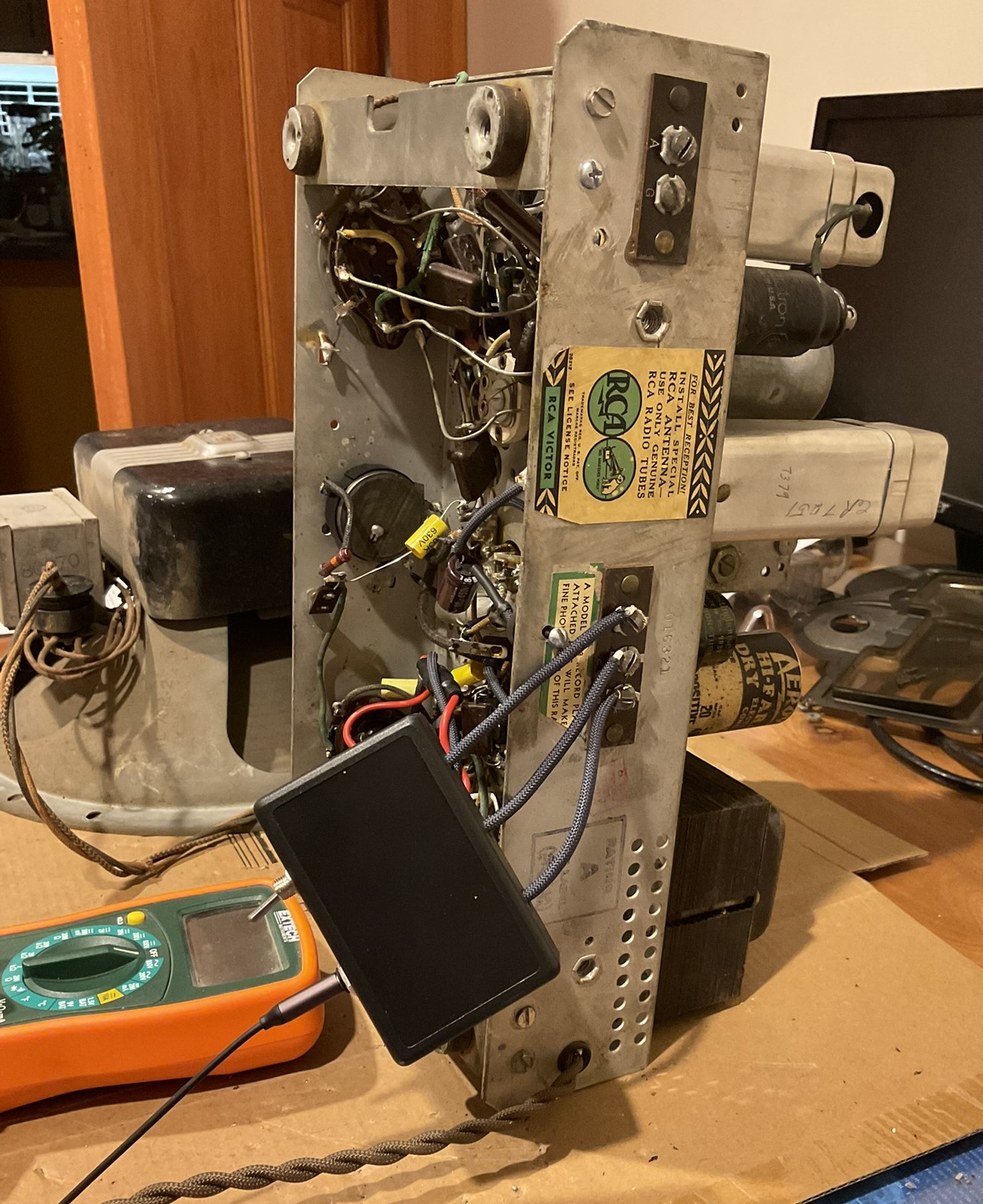

Also, I put in place a switching solution to go between radio and aux input, but this is simply wired to the radio in a removable way, photos below.

Photos of the input switch solution which will mount to the cabinet, directly behind the chassis. In this way, there's no modification to the chassis (for this) and is completely removable. It cuts out the output from the RF section beautifully (no bleed through that I can tell yet) and the audio from the aux input is very good quality. I know it's not a period-appropriate switch, but that's not an ultimate concern for me at this point and if it becomes so, I can simply remove it. The cover (removed in the photo showing the interior) will be screwed down to the cabinet and this will snap onto the cover.
