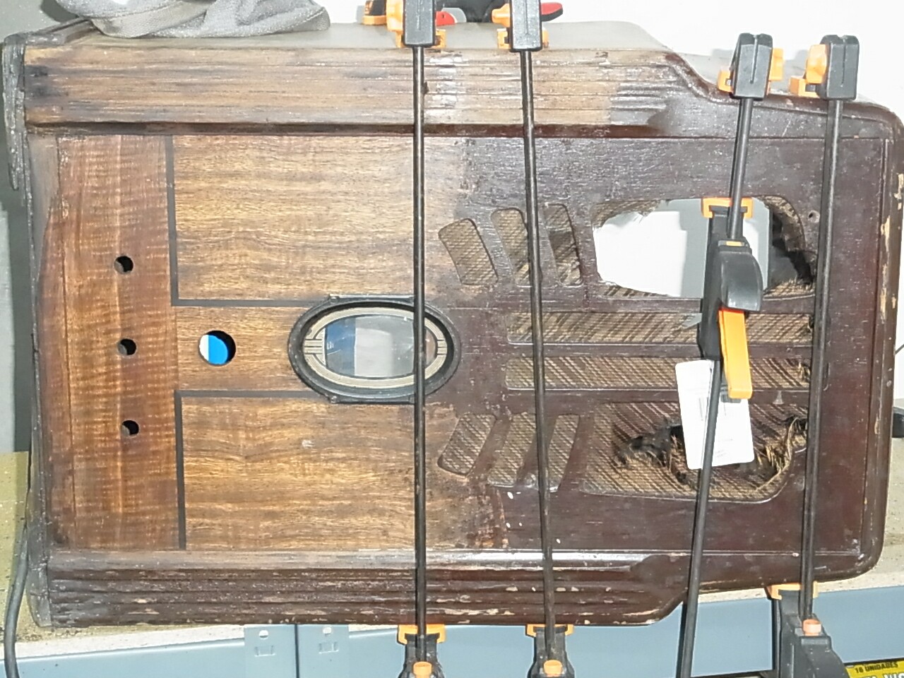

Started working on the cabinet for the 116B this evening. Got a good look at it. It was UGLY (see first pic). Someone had apparently painted the whole thing with some crappy flat brown house paint, then some sort of plasticized clear coat that flaked off into big flakes when I worked the stripper into it.

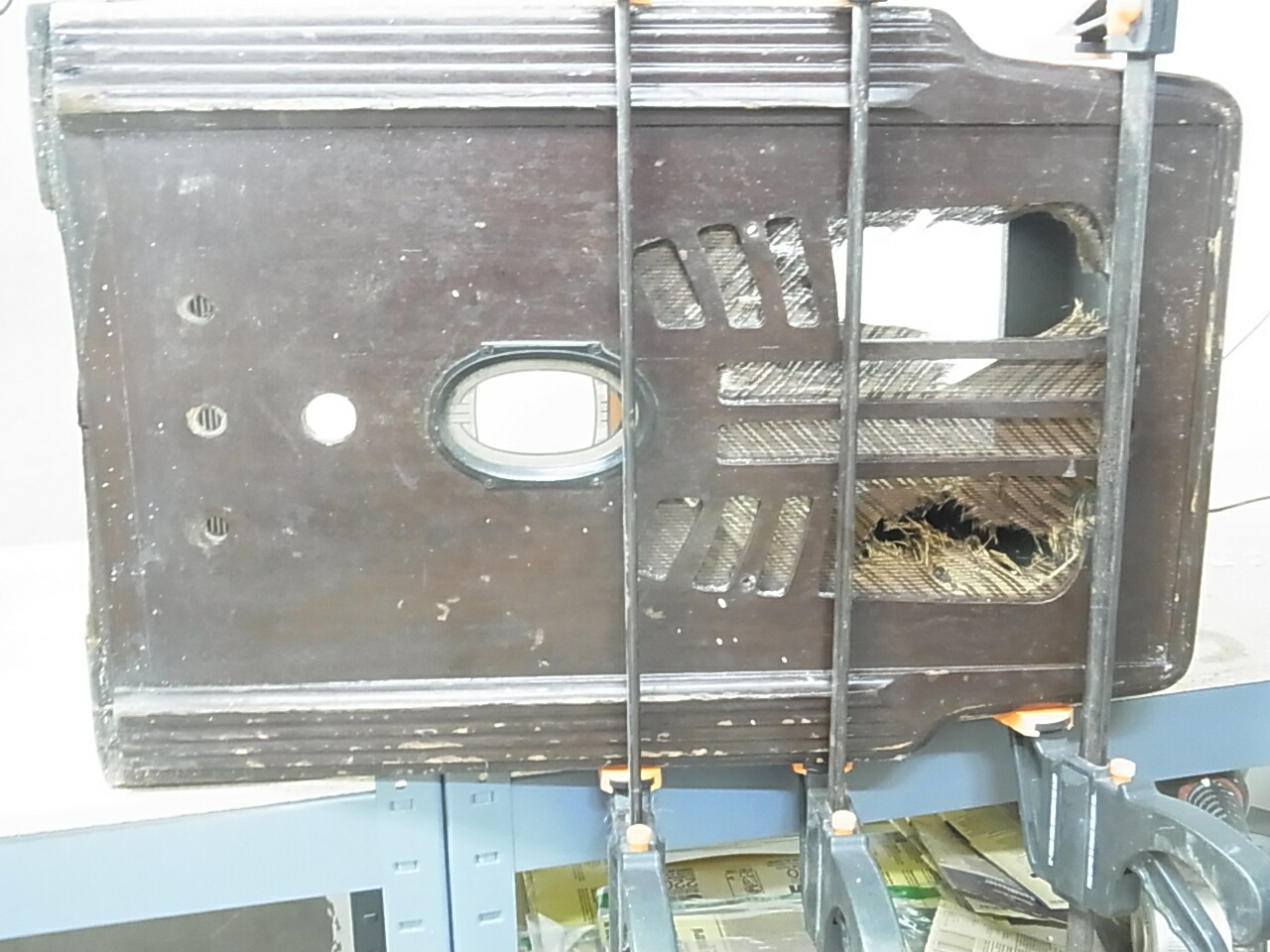

You can see in the second pic that after getting through the paint the actual grain started coming out.

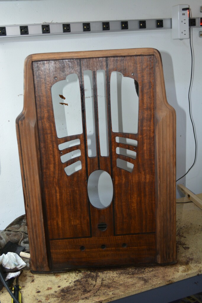

In the third pic, you can see that by carefully removing the paint I have gotten through to the pattern underneath. I'm wondering, is this photo finish? It seems pretty resistant to the stripper and my efforts to get the paint off. It would be nice if this were real wood/veneer that could all be saved and worked with.
Also, as can be easily seen, I've reglued the separated sides. I have some work that will need to be done to the bottom in the front, as the cabinet seems to have sat in water or at least a wet location for some time.

Hello Brenda, there is no photo finish on that set, one thing you have going for you is that the brown paint has actually protected the wood veneer from the elements. Stop where you are and let the glue dry then remove the clamps and dial frame along with grill cloth , then finish stripping. Be very careful not to damage the veneer when removing old paint and factory finish. If there is veneer already lifting do not get any stripper under the veneer. If you need help with cabinet I can walk you thru it

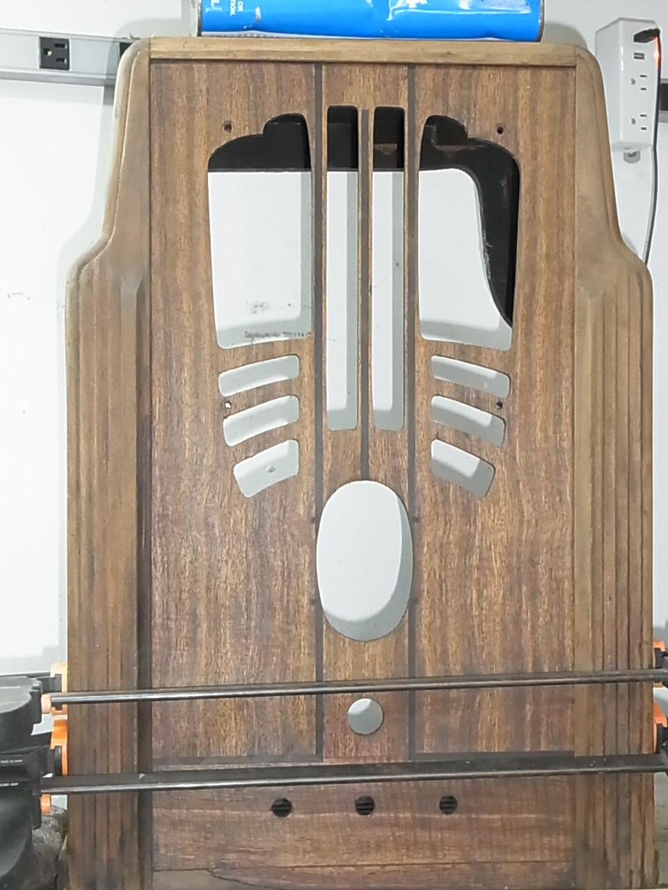

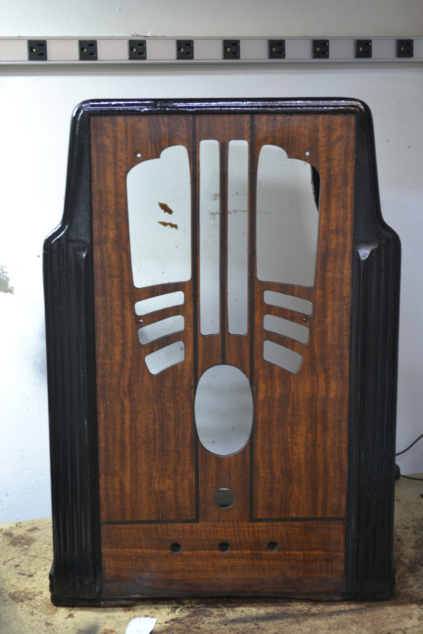

Have the cabinet almost completely stripped now, just a few small spots that are resisting my efforts, but they'll come along by and by.
Now that it's so close, I'm REALLY having a hard time understanding why they painted it that gawdawful color:
Tomorrow, I'll take my GOOD camera out there and get another shot. For some reason the cheapie Ricoh I use for snapshots is really making it look washed out, and it really looks much better than the above pic.

I see from other pics online that there seem to be two versions, one with a vertical grain and one with a horizontal grain.

Well, what do you guys think? Nothing done to the sides yet, and only a single application of stain on the front and sides, and a wipedown with paper towels.
Posts: 1,106
Threads: 88
City: Tacoma

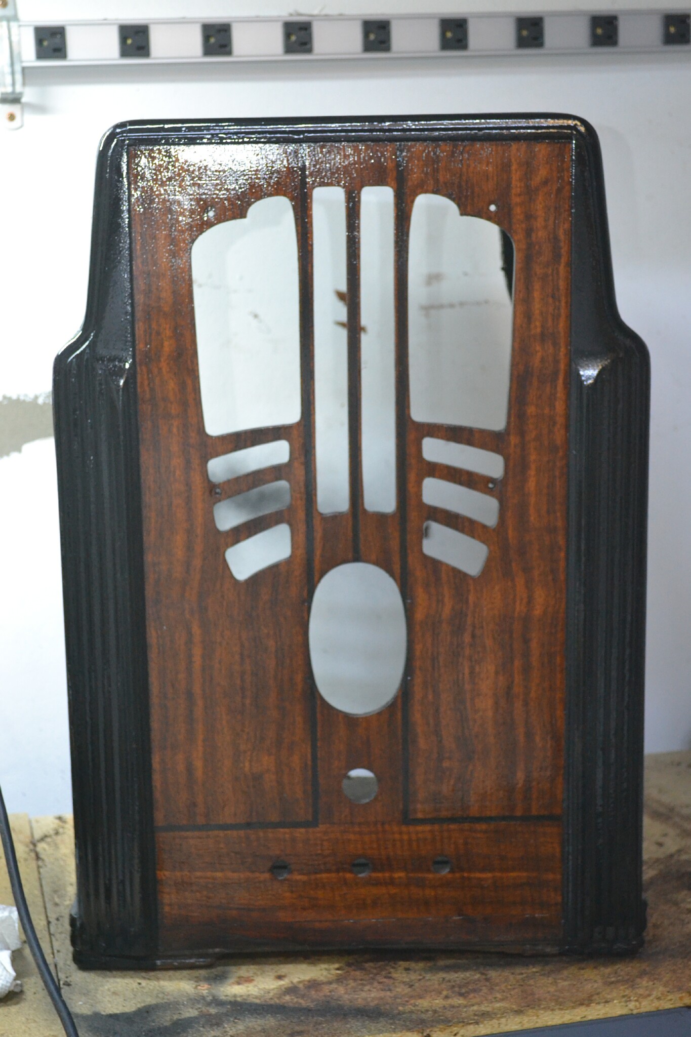

Gloss black on the trim.. what a pain to mask it off.
First coat of lacquer. Going to be putting on two more coats over the next few days.
Comments? Not too late to start over if I've really made a horrible mistake.

Also looking for pointers on how to smooth out the gloss of the lacquer once it's all applied.

Brenda
that's great looking
wonder why they painted match their décor ?
looks like it will be easy restore
sam
