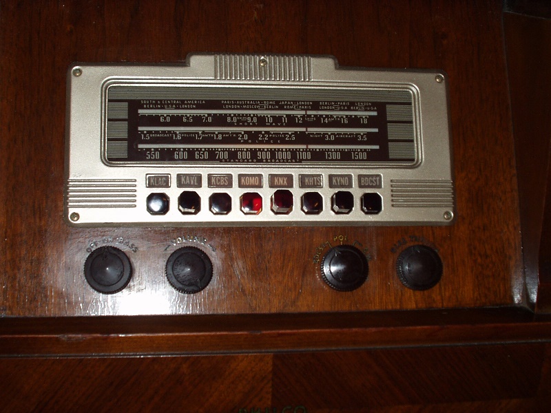

I made station call tabs from the sheet offered here, having to cut individual letters and piece them together for several local stations that weren't around back then. I applied oil on the backs of each, then wiped them dry. It makes the paper more translucent.
The only thing left is to try and renovate the lettering above the knobs (Off-On-Bass, Volume, etc.) which have a black coating over the lettering. The "Pol" for Police Band above that knob is almost legible in gold, but the rest are black.
I know I can get decals from Radio Daze, but if there's something I can use to uncover the gold lettering, without destroying it or harming the wood finish, that would be preferable.
Suggestions welcome.

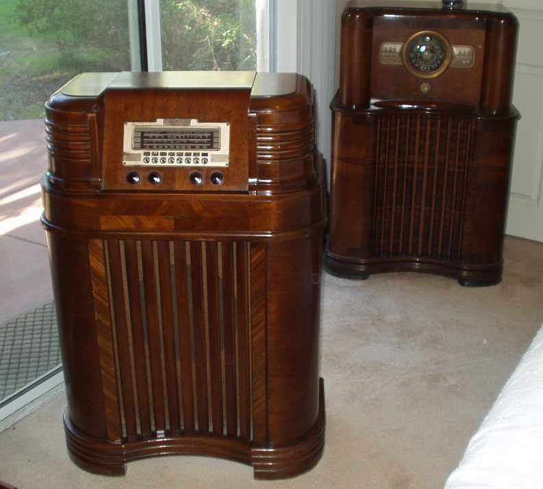

The first photo displays when I got it; notice the similarity under the belt-line with the Zenith 8S-463 in the background.   Philco was first with the styling.

Some of the guys who are really good at cabinets may have some different thoughts but if its still the original decals with original lacquer finish, a little GoJo (without pumice) on a cotton swab with a light touch should get any dirt and grime off.  After that you are down to the lacquer over the decal and I would think messing with that will only make things worse.  A light swipe with lacquer thinner would take some of the lacquer off and might do what you are looking for.
If it were mine and I wasn't going to refinish it, I'd just do the GoJo cleaning. (they actually look pretty good to me as is)
Thanks for the reply! Do you think that using GoJo alone would get them to look somewhat like the way yours do, or would that require new decals?

I think you will require new decals if you want the labels to look shiny. The lettering is made from metallic pigment. and it tends to corrode with age.
 I don't believe you can polish it to restore the luster once it has tarnished.

No, GoJo will not make them look like the ones on the photo you have of my 39-25, those are new decals on a refinished cabinet.
I kinda figured that, bright as they are. I'm gonna get some GoJo (I presume the hand creme W/O Pumice) and try that. If it still doesn't look up to snuff, then I may order the decals.
Got the GoJo, couldn't find any of the wife's Q-Tips, so used a toothbrush and Kleenex instead, but it did no good whatsoever. So, guess I'll be ordering the decals. At least I have the exact places to lay them on top of.

Actually I think that I'll just leave it as is.
 The brilliance of the decals is a bit stronger than I want.  If I could have "uncovered" the original lettering to a somewhat muted shade it would have been perfect.
