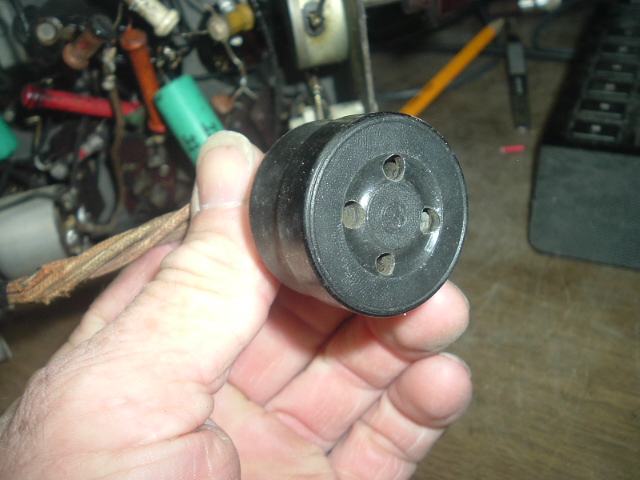

It does look like the cable carrying power to the SW converter chassis, coming out of the 51 chassis, was added at a later time. I don't think Philco would have used a rubber grommet - I think they would have used a fiber grommet, like the one which the AC cord goes through.

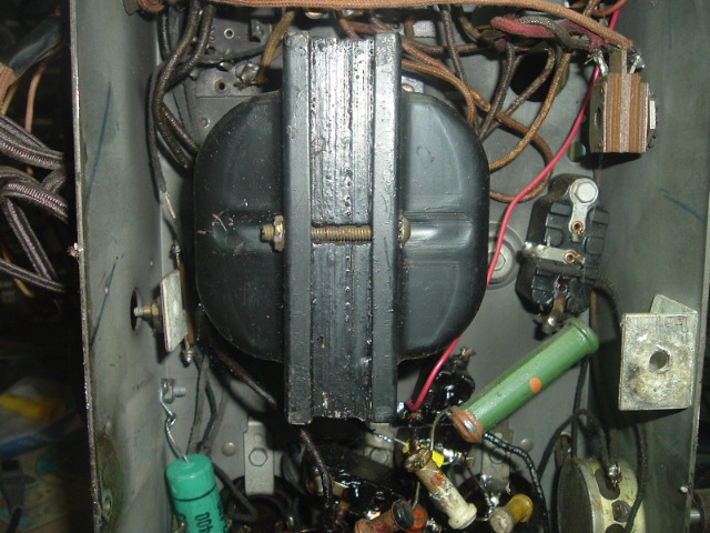

cant see the part number on the 51 but here are some more photos it looks like what some one did was add the original cable to the 51
(07-19-2016, 08:51 PM)mg34.42 Wrote:  ...it looks like what some one did was add the original cable to the 51
Based on your pictures, I am now inclined to agree.
Well, whoever made the conversion did a very good job with the cabinet; it's too bad they weren't so careful with the power transformer.

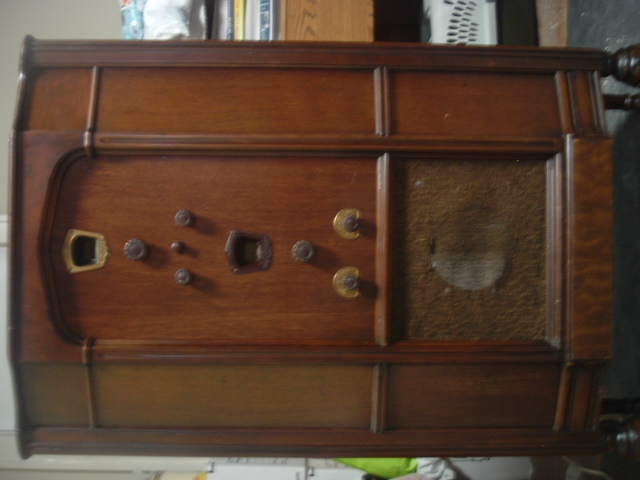

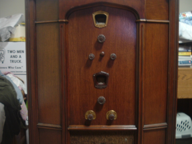

ok guys here is my progress I have used one of the original escutcheons that is the metal one I am now hunting up anther original metal one my wife accidently step on one and it has been rendered unusable dose any one know where I can find one. I have installed a 70 chassis but have not had time to change the power supply I would really like to find anther escutcheon still have not figured out how to rotate the photo  the photo that is sideways I had turned my camera
ben
The bottom (SW) escutcheon might be hard to find.   If I remember correctly it is different from the 70 or 90 escutcheon because while it looks the same it says "Made in U.S.A." on it.  A regular brass model 70 escutcheon will look pretty good while you search for the correct one.
