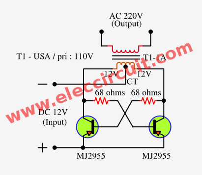

Good Morning will try and add two ways of building a replacement vibrator. The first one I have posted before the second is for powering a light at 50-60 Hz. You would use the transformer in the radio I do not understand how they work!!!
Thanks, David! All good alternatives that may very well be used.
