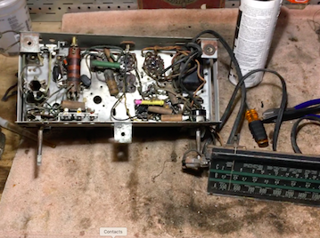

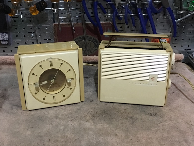

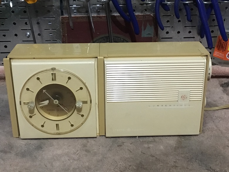

The first is a real neat but cheapo GE 682 clock radio that splits into a separate clock and a portable radio run on batteries! I redid the 4 tube chassis just fine but I screwed up the Selenium rectifier replacements  Icon_redface
After 2 hours on the phone with Terry, It came to life and it is actually really sensitive ... It had 2 800uF ecaps in it!!
Plus 3 others.. 5 Ecaps in one little radio... I got burned twice but no shocks  Icon_thumbdown  Icon_thumbup

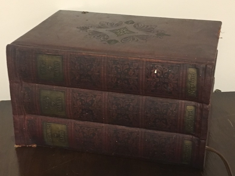

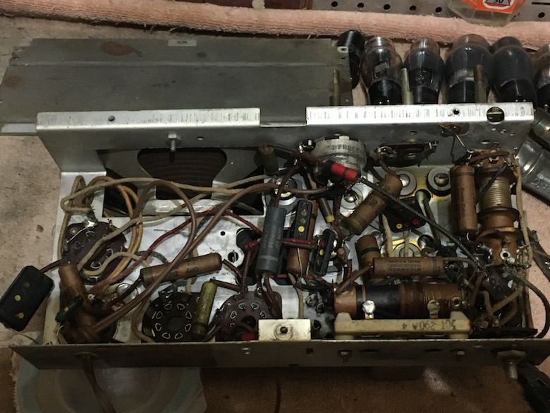

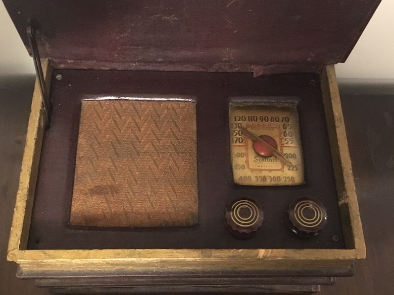

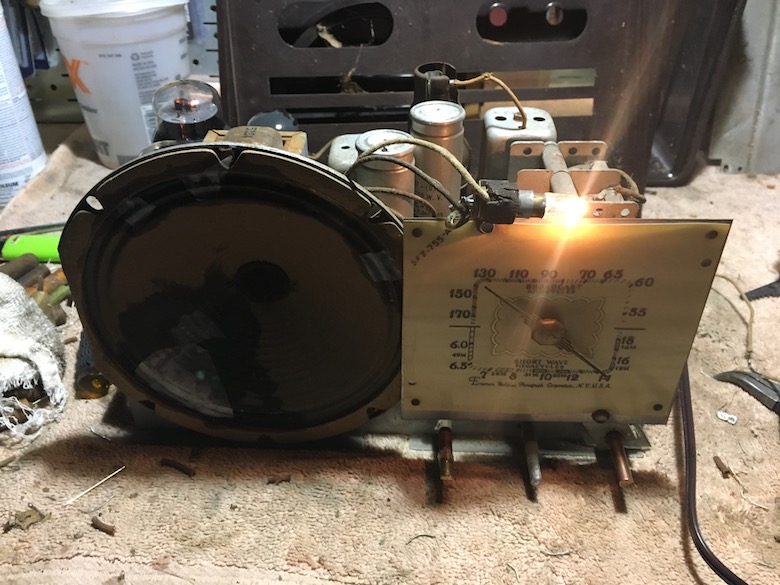

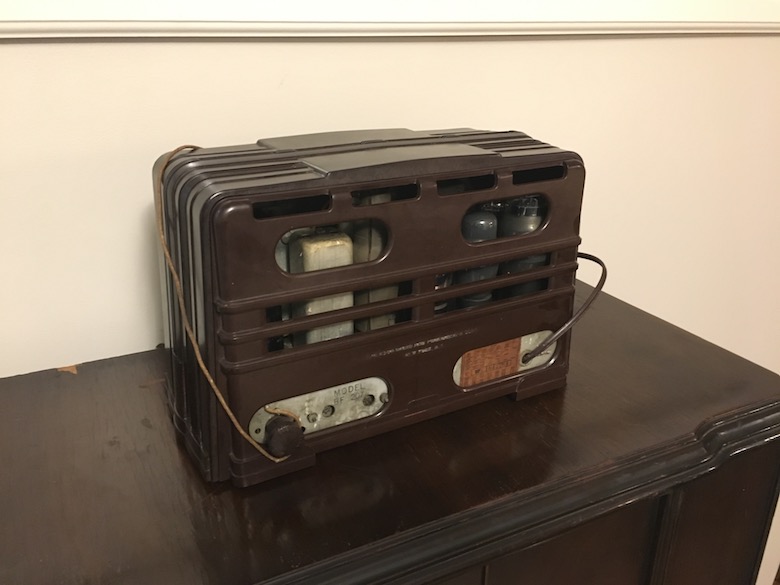

The second radio I got off eBay recently for a steal... I love hidden compartment items and this Sentinel 238-V is a stack of books on the outside! IT was sold untested because it uses a cheater cord and he did not have it. I recapped it, changed 2 resistors, and it came to life... The cabinet is in real nice condition so I only wiped off the crud with GoJo...
 No burns or shocks  Icon_thumbup Icon_thumbup

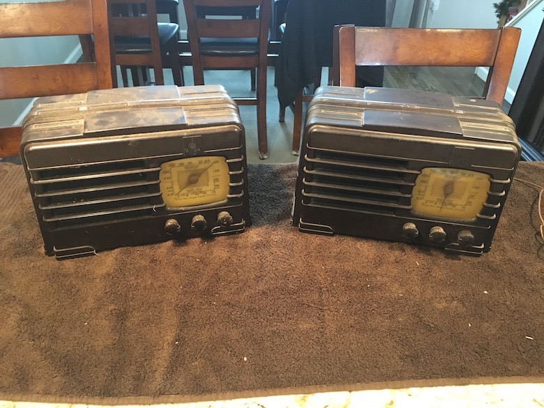

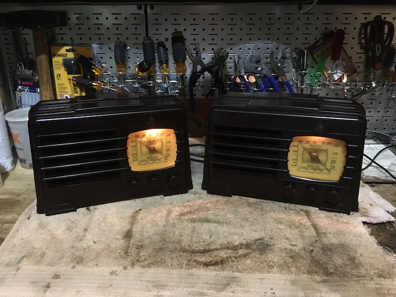

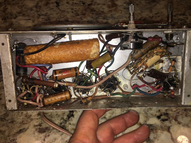

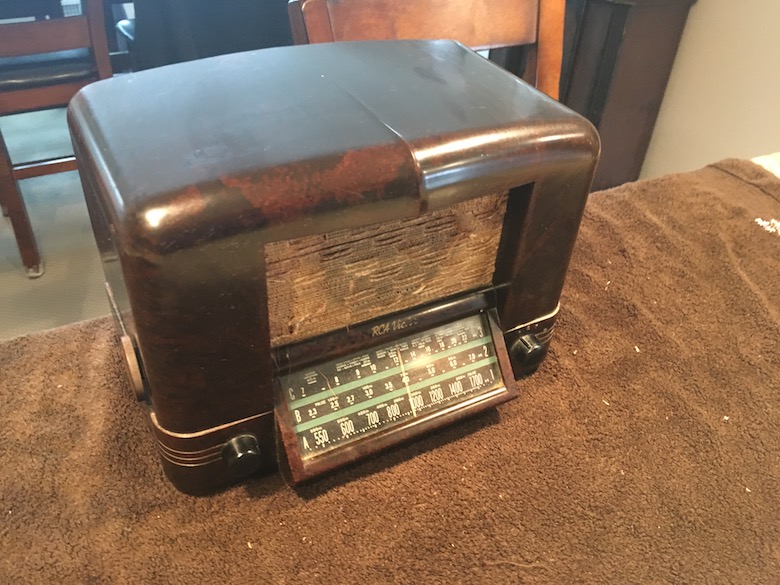

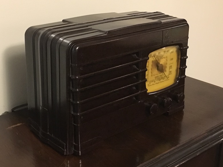

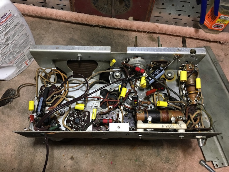

  The last one I just finished tonight.. This was from our trip to Skips friends house. I bought 2 Emerson BF-207's in extremely gross but undamaged cabinets... I took the first cabinet and scrubbed it to death to get all the sticky out of the grooves and then waxed it. I recapped the chassis all by myself and it works pretty nice. I got a little stuck with the Ecap cans pos and neg but figured it out by actually understanding that they were chassis ground... I also has some micamold paper caps and found a website to read them.. There is so much interference in my shop and house that I have to use an extension cord and test it in the yard...  Icon_crazy
No shocks or burns  Icon_thumbup Icon_thumbup

I sure do like the Emerson, I have a thing for bakelite sets with a complete bakelite back.
Gregb
I'll second that the Emersons in bakelite are very nice.

I also like the Emerson's with the front and back. I had the clockette but got rid of it last year... That one had a curtain burner on it. Weird that these don't have RLC's...
Joe had a 3rd one but the back was missing on it... I am hoping to give one to my friend but I want to see how he likes it first..
I should probably see if the other one is ok before I give away a restored one.... It has the cord cut and there are things rattling around inside... I'll check it out tonight....

< Weird that these don't have RLC's...
These have a bigger chassis/more toobs and newer 150ma heaters. The Clockette is a 4 toob TRF set w/3ooma heaters.

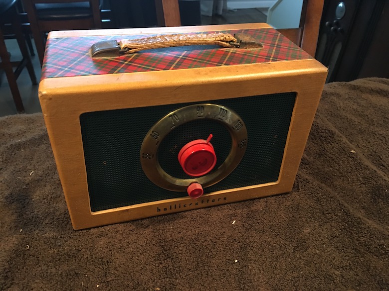

I finished the other Emerson tonight (found a hairline crack on the back side top Icon_sad ) I even got my Halli TW-25 done.. I needed a little guidance for the Selenium rectifier...

Good job Kirk!  My favorite is the book radio... great find!
It was!
$49.99 shipped off Ebay...
I really want the upright stack too....
One is RCA and another is GE...
