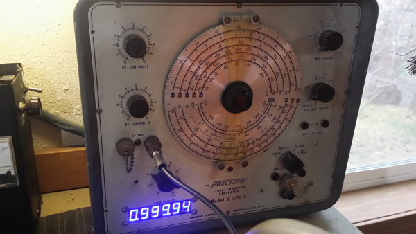

Well it arrived today and proceeded to try it out.
Must say that I am quite impressed. Reads dead on in frequency up to 70 Mhz or so and sensitivity is very good. In the photo it is reading a 7 Mhz signal at a level of only 10 millivolts.
It also uses very little power. I measured only 25 mA at 9VDC supply.
One of these counters could be incorporated into an inexpensive vintage signal generator for less than $10.
It really does not need an external supply, as all that would be needed is a diode and filter cap connected to the 6.3VAC filament winding to supply around 9 VDC for the counter. The counter input could be connected through a small value (470 pF) cap and series resistor directly to the signal output before the attenuator. That way, no matter what the output setting, the counter would always read the full level signal.
The module is tiny and it could be built right into the generator box, or if you didn't want to modify it you could mount it in a small case and put it on top.

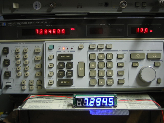

I tied mine to the cathode of the 76 osc tube in the 660 and used it to set the lo. worked fine from bc to 18.460. This model only goes down to 1mc, which is ok for bc osc 550+460kc. Also didn't notice any noise generated by it. Don't know what it uses for a time base.
One thing to be careful of is input loading. The counter has a MOSFET front end and a pair of back to back protection diodes from input to ground, so if the signal is more than 0.7 v peak the diodes will conduct and load the measured circuit. Better to add a series resistor to reduce signal if it is at high level as in a tube osc circuit.
Actually, the time base is very good. It has a TCXO designed for use in cellphones, rated at 2.5 PPM.  Amazing the quality of mass produced parts these days. Better specs than expensive counters of a few years ago, and all for $9 including shipping!

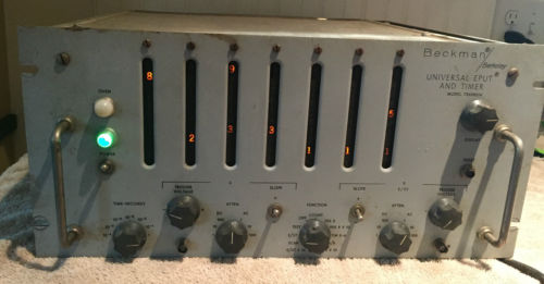

Dad had one of these. Darn thing probably cost 6 million buck back in '57.
Each digit had it's own 12AT7 to control it and would count up to 100kc.
Now only $10 and much lighter!!
Now, that counter is the definition of a boatanchor!
