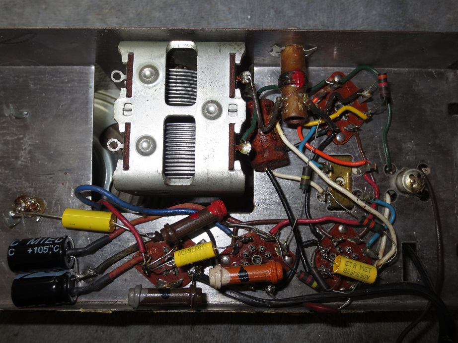

Hey Mike, I have one of these radios and it is hum free. If you need a picture of the layout or any other info let me know.
Gregb
Greg
Would be much appreciated. By chance do you have the exact schematic of it? I mean, the Sterling? I am going by that Teletone documentaion, it is 98% the same with minor differences that I do not think account for what I am seeing but still.....
Mike
I don't have a schematic for it. Tonight after supper I will get a picture of the chassis layout and post it here.
Gregb
Here is picture Mike, hope it helps.
Gregb
