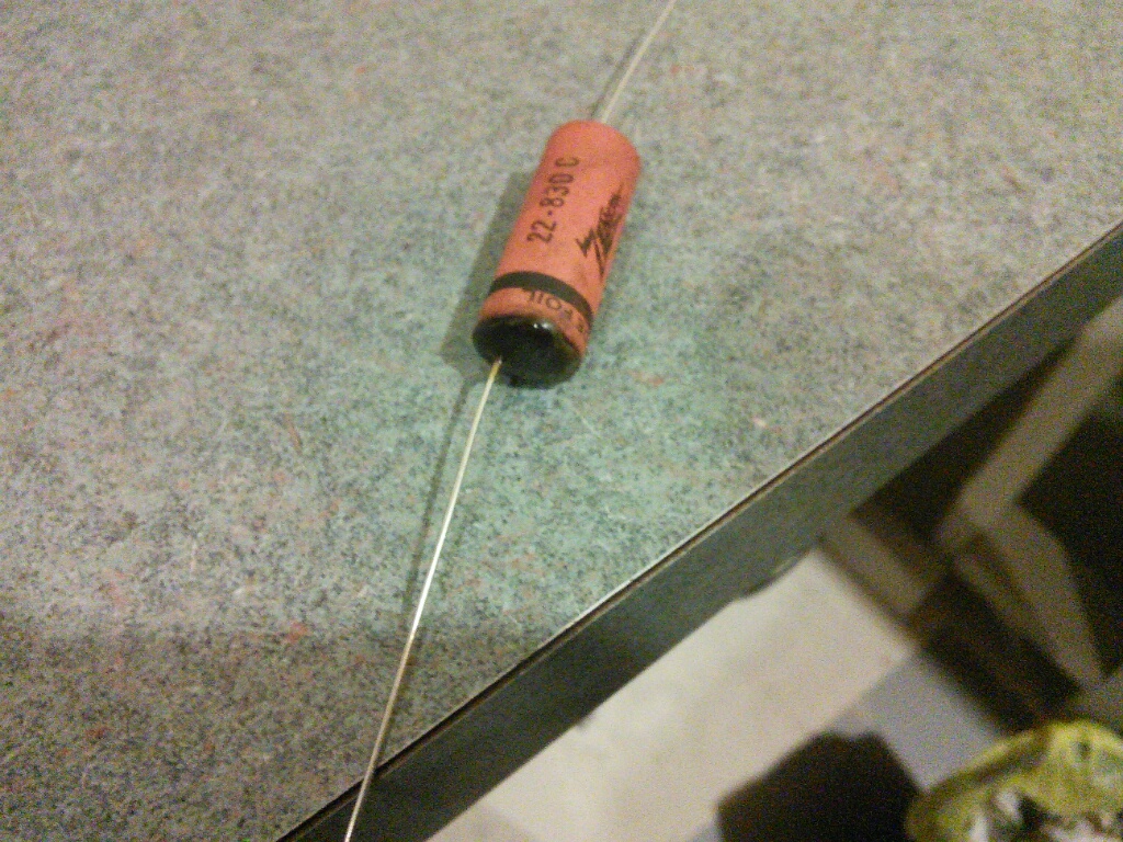

Yes, I use my heat gun. Gut'em, stuff'em, pot'em.
I first grab a lead with needlenose pliers, heat it on low (or else it might burn it) 'till it melts and bubbles, pull one side, heat another side, pull it, and then push out the roll if it did not pull with the second lead.
I thought of using the colored hot glue for potting but then called the Hobby Lobby and their glue sticks are 1/4" diameter while my gun is 1/2". So I settled for my usual milky white; still looks good.

I use any hot glue (clear) to hold the cap in place and then fill the end with the original wax - or other colored wax.
OR in some cases, I use the original wax ends. This requires a specific method of disassembly and won't work for all types of paper-cap construction, but the results look like the original.
(This post was last modified: 01-26-2017, 01:33 PM by Phlogiston.)
yes it would be easy. Usually the wax comes out (in my cases) as a block or large chunks so it would not be difficult to fill the space with a little of the hot glue, let it dry and then put in some small chunks of the wax and melt it with a heat gun.
Here it is. Own native wax over plastic.
