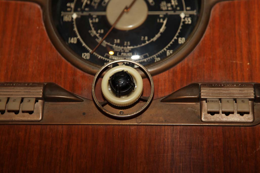

The belt came yesterday, I have just installed it, the vernier now works well, I can tune the cap by the tuning knob (which is quite mishapen but... Can't have all at once).

2. Ordered the new tuning knob from Ed. Mine was really warped.

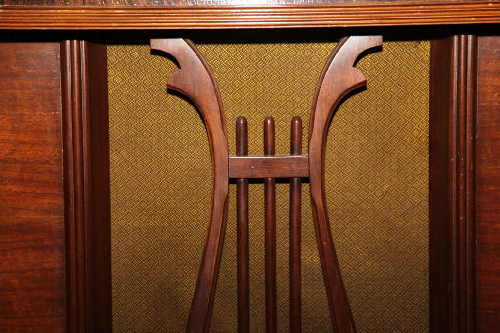

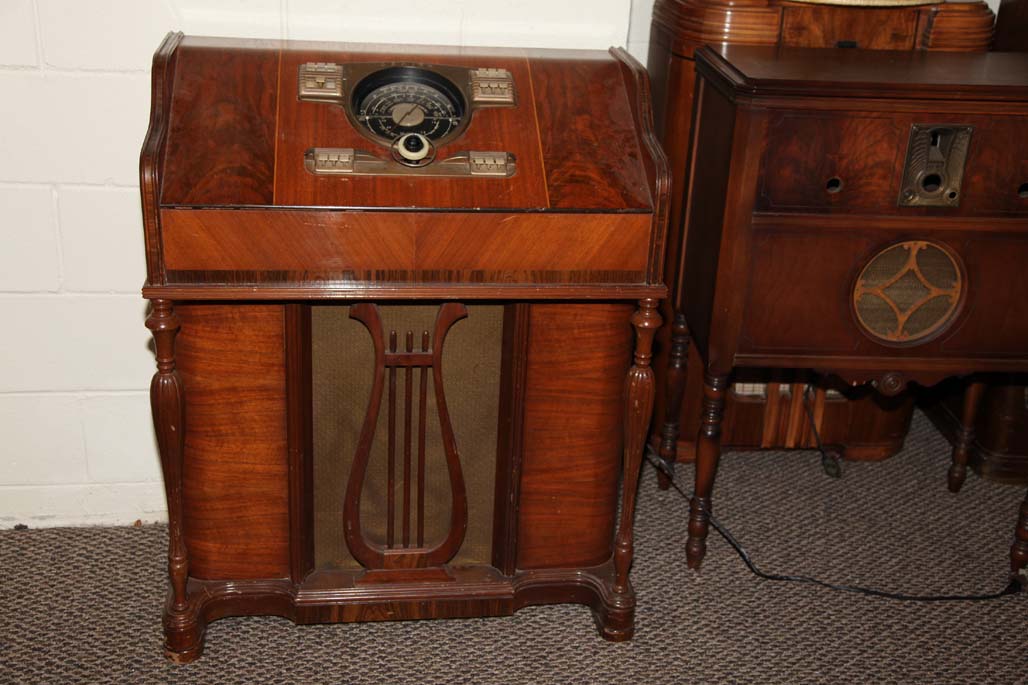

With a new knob and grillcloth.
#98
Very well done Mike Icon_thumbup . That's a really nice looking cabinet. I wonder if the big bass sound is inherent to the type of speaker used in it.

If you will be re-clothing the grill, here's what I experienced:
The cloth does not go around the board on the sides: the board has no space in between it's​ sides and the board surrounding​it, so the cloth should be trimmed to the size.
At the bottom it can go around but the original doesn't​.
The only place where it goes over is the beveled top.
The cloth is glued, not stapled.
The board's surface is not smooth and, given the size of the cloth, it does not move freely when you try to stretch it.
If on top of that you are using the fast drying spray glue, you are racing against time.
Be aware.
