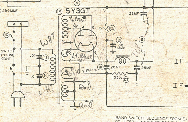

As I understand it, your replacement transformer has a 6.3V winding for the tube heaters (filaments), but no 5V winding for the rectifier 5Y3GT. Is this correct? How did you have the present transformer connected to the heaters when the radio was working?
If you can't find a suitable transformer, you can use your present one by replacing the rectifier tube with silicon rectifier diodes and leaving the 5Y3GT tube with its socket wiring unconnected. It won't light up but will at least look original

Based on the way it was wired, it was missing the 2nd 6v (12v ct) secondary marked H (Heater?) on the schematic. The way I got around that 45 years ago when I replaced the transformer was to use the existing 6v secondary to drive the heater circuit and ground the other side of the heater. I also had replaced the rectifier tube with solid state diodes. I'd really like to put this back to the way it's supposed to be but will consider all options.

OK, but both windings of the original Philco transformer are 6.3 V. There is no 12.6 V winding. The center tapped winding is 3.15 V each side of the tap. Otherwise, with a 12.6 V winding you would be applying 12 V to the 6 V heaters.
That one winding is only center tap grounded for hum reduction, feeding the low level audio tubes and FM detector. Grounding one side of an untapped winding for the heater supply, and feeding all the heaters is OK, but you may have a bit more hum.

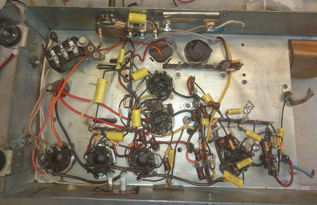

Today's progress. It's amazing how much cleaner it looks. Still need to rebuild the caps/resistors on the terminal strip toward the top, and then re-install the electrolytic cans, but then the main chassis will be done. Well, other than some wiring. Now the fun part...the caps in the tuner sub-chassis  I'm considering taking the mounting nut off the band switch to see if it gains me some access to the 3 caps in there that need to be replaced, but concerned about doing some damage. Thoughts?
Rich

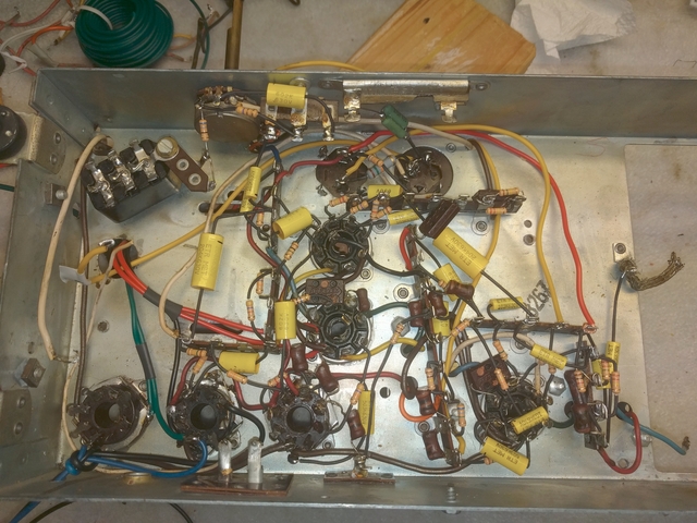

More progress. I have 2 more caps to re-install. Just waiting until all connections that will be below them have been made. I've been putting off working on the tuner sub-chassis as long as I can, but it looks like I'm going to have to attack that in the next day or two.
Rich

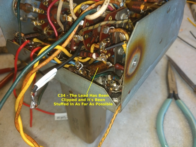

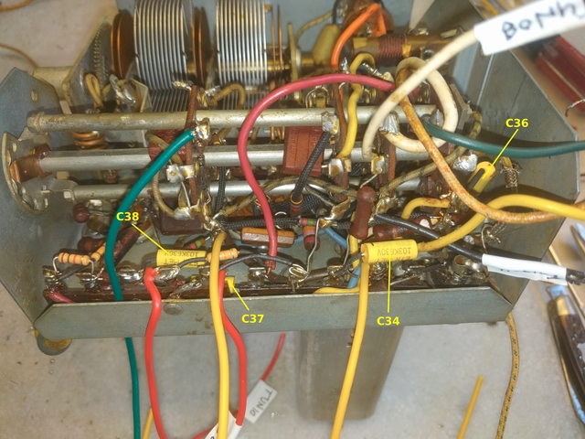

Ok, I finally did the tuner sub-chassis today. It was difficult, but not as bad as I expected.
I really HATE leaving old components in place, but one of the caps was really buried and I couldn't even SEE the ground lead, let alone get cutters or a soldering iron on it. So after measuring it for my documentation I clipped the other lead completely off and stuffed it down into the chassis as far as I could and it'll have to stay there.
Now I need to do some cleanup on the top side of the tuner sub-chassis, finish attaching wires for the power transformer, wire in the output transformer and the speaker connector, then figure out what I'm going to do about the power transformer. Plus I need to order a few parts. I had some brain fade and ordered a 0.47uF electrolytic instead of a 4.7uF, plus there are a couple of mica caps that are missing from the circuit. I'm pretty sure I removed one of them when I worked on this set many years ago and never replaced. The others appear to have never been in the circuit so don't know if I'll put them in.

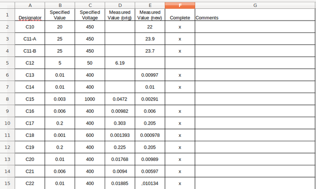

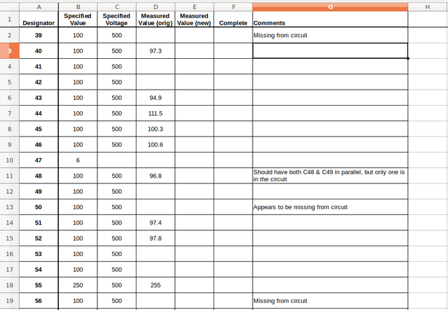

Today I want to share my process for documenting my progress. Perhaps it will trigger a discussion where others can share their methodology and help anyone that struggles with such things.
First and foremost, I've taken tons of pictures...263 so far. On most I've made comments to help me remember pertinent info. I'm a Linux (Ubuntu) user so I use gThumb to crop, resize, and enhance photos. Then I use Gimp to make comments or other markings.
I've also made hand drawings to keep track of what should be attached where. I like to remove all parts from a terminal, clean it up, then re-attach them. The drawings help a great deal since everything is so intertwined and it's difficult to see what's on each terminal in a photo.
I created 3 spreadsheets (I use Libre Office), one for caps, one for resistors, and one for mica caps. Here is a sample of the caps spreadsheet:
For each part I take a reading of the value for the current part, and if I replace it I document the value for the new part. Then when the replacement is complete I put an 'x' in the complete column. The spreadsheet for the mica caps is purely for info, although if I come across one that is way out of tolerance I'll replace it. Here's a sample of that spreadsheet showing how I use the comments column:
I hope this helps someone and look forward to seeing how others do it

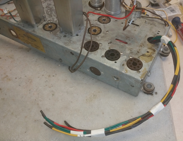

Now that I have all the power transformer wires connected
I decided I should check to see if the wire I'm using is heavy enough. I'm using 18ga stranded. According to the chart on this page: http://www.engineeringtoolbox.com/wire-g...d_419.html it should be able to handle 4.9 amps. The Sam's info says that the one of the 6v secondaries is rated at 2.9A and the 5v secondary is rated at 1.8A. Will my 18ga wire be heavy enough, or should I swap it out for 16ga?
Thanks
