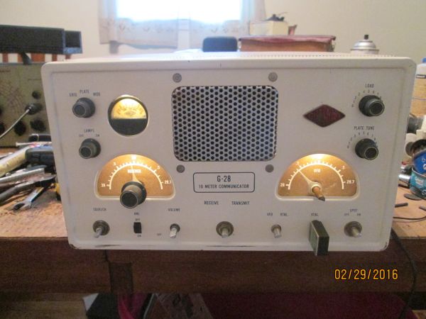

In honor of Skip's project I grabbed a Gooney out of the garage and started on it. Replaced some caps cleaned it up a bit and was rewarded with a working set that makes about 30w of AM. A buddy has some knobs for it. Still needs some more cleaning and a volume control. Band conditions up on 10mtrs are pretty poor so I'm in no big rush. It's circa 1958, that's a change most of the time I'm younger that the sets I've been working on!
Looks great Terry.. But its a 10 meter one. Mine is a 6 meter one. Joe has a 6 meter one in the house that we went up to. Will probably get that one too..
