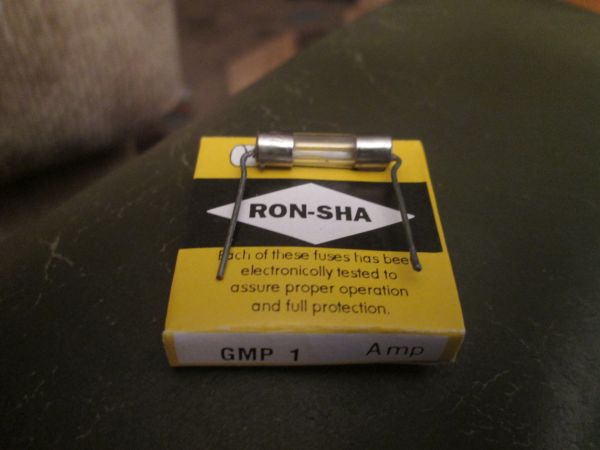

Just as an aside I found these online. Physically they are fairly small abt 3/4"long and come in .5,1,and 2amp sizes among others. .79c for a box of 5. A bit of tubing over it and it's good to go, no holder to mount.
