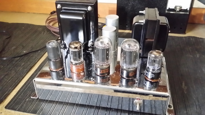

I also just completed a small stereo pre-amp. It uses 2 12AT7s which may be replaced with two 12AX7s for more gain. One triode drives the second, but a switch allows the injection of a signal at the grid of the 2nd triode if less gain is needed.
It has its own PS with B+ at 180V and the filaments running in parallel at 6.3V. It measures 7 1/2 x 3 x 3" including the veneered wooden cabinet. I tested it with a HK audio generator (a very cool device in it's own right) and it can pass signals from 1hz (no gain - probably some loss) up to 50,000Hz (and beyond). It is +/- 3db between 20hz to better than 20khz depending somewhat on input level and the gain adjustment which is a 650K stereo pot between the triode sections ( wanted a 1M pot but didn't have one). Two sets of RCA in (one high level, one low) and stereo RCA out.

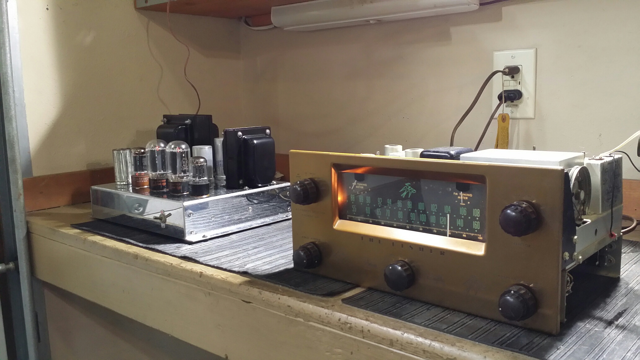

I have added both of these devices to my work bench. Now I won't have to go dig up an amp when needed to test a project. It has already paid off in testing a Fisher receiver last evening.

So was that built on an old Scott chassis?
Neat Fisher Series 80. I have its little brother, an AM (only) tuner that I picked up at Kutztown back in May of this year.
It is a Scott 510 PS/Amp - rercapped and rewired to use the unneeded choke and rectifier socket. The choke makes the PS quiet enough for 3 stages of amplification and the unused socket became the preamp/mixer 6SL7.
Also, keep in mind that none of the modifications are permanent. If one day somebody needs a real 510 amp, a few wiring changes will return it to original.
