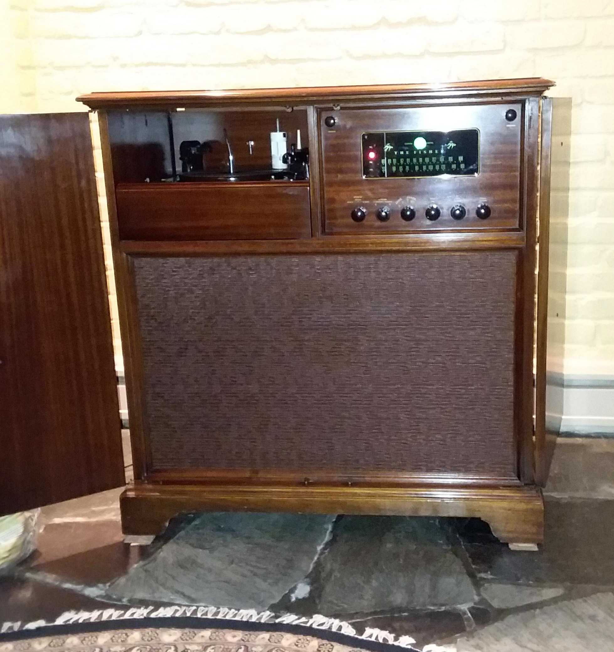

Hi,
I have a Fisher Custom Electra (mono) with the K15 chassis (1956). I have enjoyed this for the last 15 years.  During my ownership I have had capacitors and resistors replaced to the point that "we got 'em all". I use this instrument primarily for playing my 78s and older mono LPs and 45s (Garrard RC 88/4 changer with a GE VR cartridge).
I wanted to listen to a local FM broadcast on the radio and noticed that there is a "hum" that occurs between about 90 and 94 on the FM band. The station that I wanted to listen to was at 92 and the hum was annoying. If I go below 90 on the dial it disappears as well as above 94. No hum on either the AM or the phono. The volume of the hum increased as I advance the AFC control knob. I was using the factory dipole antenna and switched to the roof antenna connected by coax. This made no difference.
I'm at a loss as to the origin of the hum and I was wondering if anyone might have any thoughts as to what might be causing it. btw, no light dimmers, computers or any other electronics within 30 feet of the receiver when it was operating.

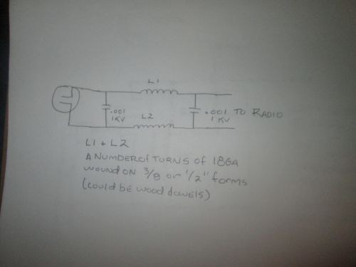

More of an experimenter than a break out the slide rule and calculate kind of guy. If that being said I think something that looks like this may be  helpful:
In terms of turns would start with about 5 and perhaps up to 20 choosing the number that give the best attenuation. You can also try connecting a wire from chassis ground to earth ground. This is made simple if you have hot water baseboard heat. You can just clip the ground ware on the one of the heater fins. Using the 3rd wire on the outlet isn't a good idea as you'll probably find more noise there. I'm sure there's someone smarter than I that has some better ideas.

Terry,
Thanks for the schematic for the "experiment"! I will pull together what I don't have and hopefully will have a reportable result within a week. I have as yet to try the chassis ground to earth ground, but the room that the Fisher is in has cast iron baseboard type radiators all around the room, so that should be easy.
