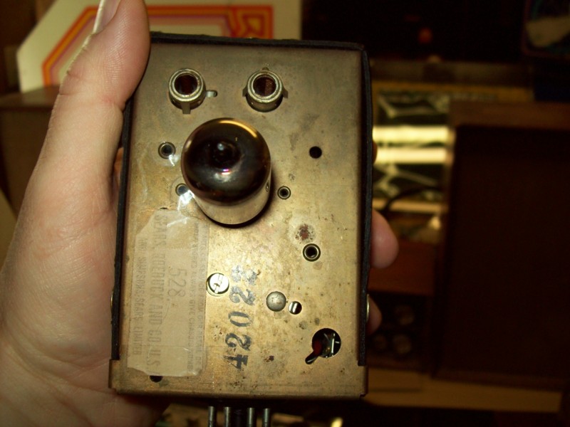

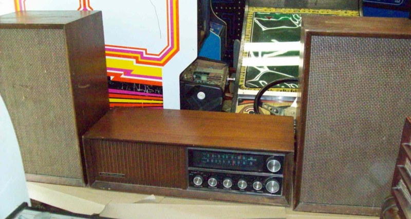

As promised, I finally got a couple pictures here. After confirming the one unit has bad IFs in the AM stage and a broken amplifier plug wire, I finally combined what I had into one good unit. It plays quite well now, though I would say it's only 95% there. For one thing, I need to redo or have one of the muliplex boxes redone. Turns out these have two little electrolytics in them that go bad and they are buried behind everything else! Of course..  Actually, I could probably get to one of them if I had a true soldering pencil, but I lack one of those right now. So, redo one of the boxes, get some new #49 and #51 type bulbs and I should be in business. The amp and tuner out of the beat up cabinet look really clean and good. I think I saw a few new parts on the tuner and it definitely appears my late friend recapped the amp on this one. Put in a more matched set of tubes into the amp (though one 12AX7 is a bit weaker than the other, I couldn't find a matched pair.) and I think I can label it as stable for now. I just wish I had something to test the phono input with! Cost on this project so far, zero dollars! I was given the stereos by my friend's dad and most of the tubes were also given to me. Really, the only think I have money in are the 12AX7's and the 6BQ5's and all those were from a trade with spares left over.
The FM multiplex box.

Yeah, you don't really want to collect too many of these! Though, like I said, I had three of these to begin with. Sold the worst off put the other two together into this cabinet to make a working unit with spare parts left over. Really, the only issue now besides the MPX box is it gets into moods where the FM gets weak. It doesn't cut out, just gets weak until I flick the band switch back and forth. Not sure if its a true issue or if the contacts in the band switch aren't happy. The switch is semi-sealed, so hard to get any cleaner into the contacts! If it is an issue, I only have to take the 'head unit' in to be worked on instead of speakers and all. The shop I know keeps two sets of large speakers on hand just for working on units like this. Basically, any decent set of 8 ohm speakers will work.(Actually, getting the MPX boxes repaired will probably help in any case).
