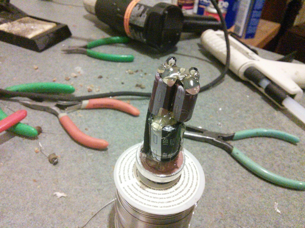

The second twistlock cap. 20uF abd 2x10uF. ItsI a bit challenging to fit it in the 1" can, so the precision is required when positioning: a millimeter off and the can won't go over. My 10uF were too fat so I found two last 12uF caps I had, slim&tall type. They gave me a couple of millimeters space to the can, but as I said, with due accuracy.
Yesterday I glued the cap back together, have just installed it. The underchassis drawing is pretty detailed and together with labeling and good layout (this one is not overcrowded) it wasn't difficult.

I hope that your three section electrolytic holds up OK. I have not had good results using hot glue on electrolytics. It ruined some for me once...so I won't use hot glue on any of them anymore. They were Nichicons.
Ron
I never had problems with hot glue and electrolytics. I used just a dab, I dd not flood them. It holds well: when first I glued them a tad off, to take that stuff off them was a ask, it sticks real well.

[Image: http://philcoradio.com/phorum/attachment.php?aid=16613]
This is what I was referring to. Correct me if I am wrong, but isn't that hot glue on the lead ends of the two top electrolytics?
This is what caused failure of a couple Nichicons for me. I used no more than this. Probably less, in fact.
But hey...good luck to you.
RE: Warsteiner...unfortunately Schnitzelbank's lager list did not specify whether the Warsteiner they carry was Dunkel, Schmunkel, or what variety - it simply read "Warsteiner." We ordered based upon my recollection of your beer, and Paul ordered the same upon my recommendation. I felt badly for Paul when it was not the same as what you had given to me. Although if he was disappointed in the beer (as I was), he didn't let on.
Ron
Yes, I simply put a bead on top of the soldering joint to gve it some extra insulation, and while hot , some ran off to the surface of the cap. Well, hopefully it'll be ok.
Did yours failed immediately or over time?
Immediately.
Strange. Nichicons too..... I'm not even sure I could guess why....some thermal damage, obviously, but two at the same time from a small dab of hot glue.... interesting.
For me it's a usual practice. I don't flood them, just stabilize the assembly and insulate the soldering spots. Haven't seen anything like it so far. Though I mostly use Panasonic ones.
