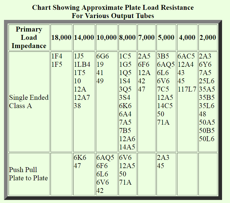

Will this help??
Good reference. I'll keep that. Thanks,Stan.
