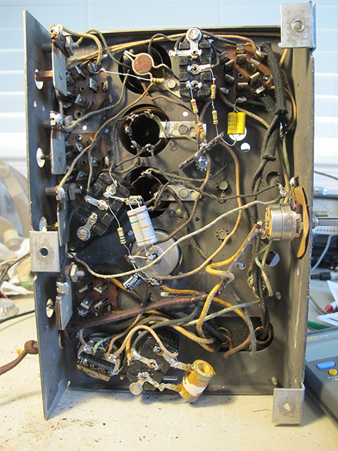

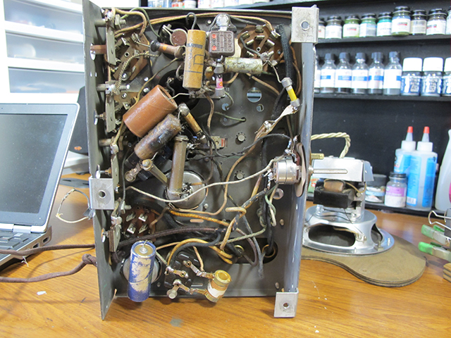

Have worked for over 40 years in Electronics, I thought this would be a fun hobby Icon_smile
This radio was "restored" back in 1990, noticed one of the tubes was a 44, not a 36
Here are before and after photos. I opened up the Bakelite caps and replaced the old caps.
