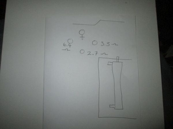

Here's a pinout/resistance of the coil in hopes this will aid you to troubleshooting and repair. Resistances are measured from ground to each terminal. Look at the good side if it #38 wire it's only abt 6' long.
The output transformer seems like one side is open. The good news here is that there are a number of Philcos that use the same transformer. What you want to look for is a set that uses the p/p 42's triode connected or a set that has three #42tubes.
Dare I ask how is your shadow graph coil? That one is abt 1100' of 38 wire.

I think its just the 6.4 ohm section that is open although I did not write down the others they were low ohms, not open.

So Terry, I think this is where my open is on what the schematic calls the #4 "Transmission Line Transformer" and that seems to make sense with the coil pin out you provided.   The antenna transformers are #5 "Antenna Transformer (Long Wave) and #8 Antenna Tranformer (Standard, Police, Short Wave).  What does #4 coil do?  I've not seen a "transmission line transformer" before.

Well I'm not quite sure. Section 6 of the band switch mostly is switching between the two antenna connections. On the back of the set there are two screw terminals these are for the LW ant. The two fastenstock clips are for the BCB and above. #4 isn't part of the tuned circuit for the ant so I'm thinking that is not particularly critical (that's what #8 does). 4 is connected when the bandswitch is set to the BCB but the signal from the ant can go thur 6 and feed the ant coil.
Like I said don't think it's a show stopper. If I had an inductance meter I could measure the one I have and you could add a small value choke to emulate your open section. Another possibility would be the add a small cap across the open section. This would apply the rf signal form the top of the coil to the second second section.
Thx Terry. the small cap value to try would be something like.... 100pF, larger?
Lots of caps and resistors to do yet... Icon_thumbup
Probably smaller 25-50mmfd.
