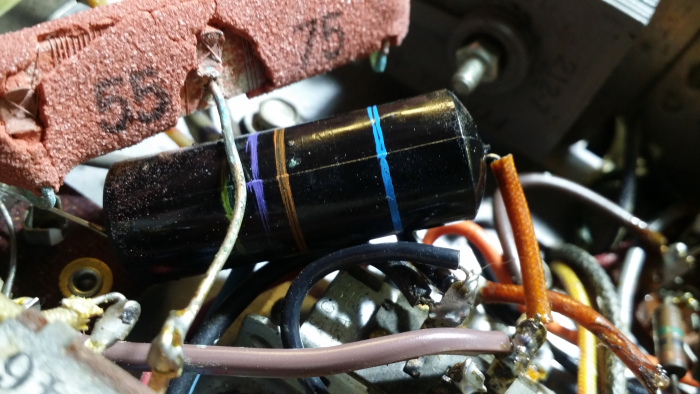

BTW, here is a picture of a CAST replacement (not made as above but cast in the red mold). This is the "death-cap" replacement and is rated for Y2 or X2.
Yeah, my sanded resistor needs new sand, but, is otherwise OK.

Do you add a note anywhere noting the caps have been rebuilt?
I would probably cut that cap out you show, thinking it was old and had to go.
I put a business card into the battery area stating that it has been recapped.
On larger (expensive) projects, I will sometimes tape a card to the chassis - sometimes.
