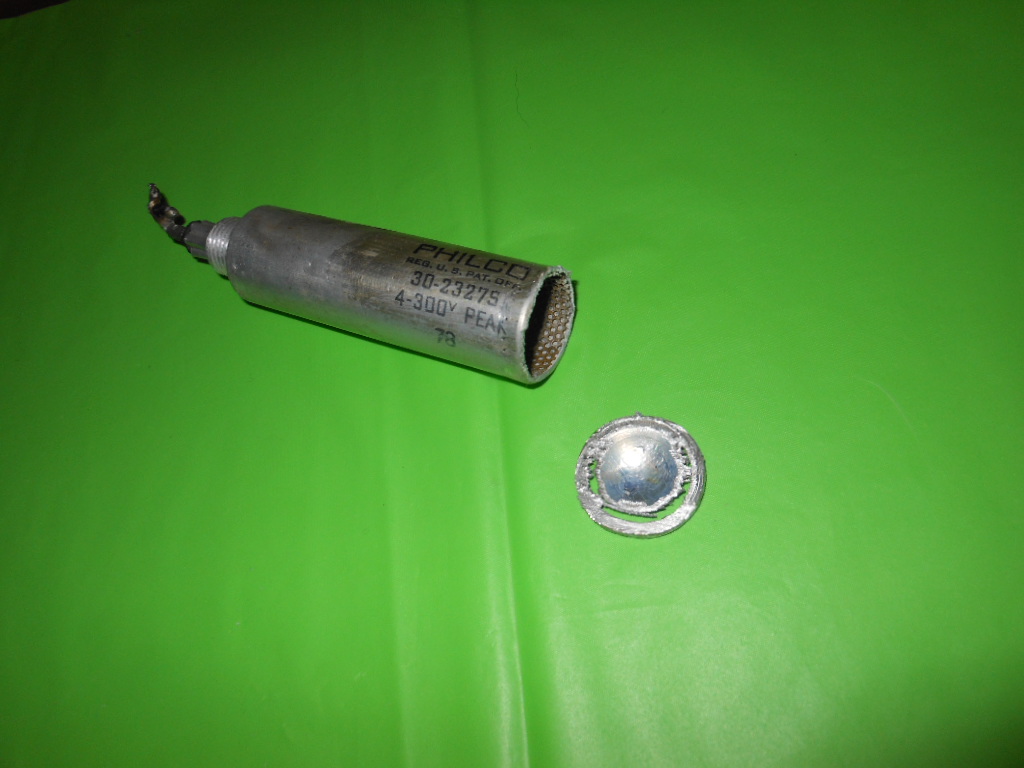

The mounting threading is integral with the body of the can, ( and there IS NO mounting bracket to hide a cut down low), so the logical choice left was cut at the top of the can. Someone else suggested cutting right inside that groove at the top, . . .  and I agreed. But when I did, I ended up slicing into the concave top, . . . and ruining it.
I've decided I agree with Chas now, and am going to forget stuffing cans.  It was a learning experience, . . . I didn't dream of what I found in that can!    But now,  I have to find an old replacement to occupy the hole left by the missing destroyed 4mfd cap.

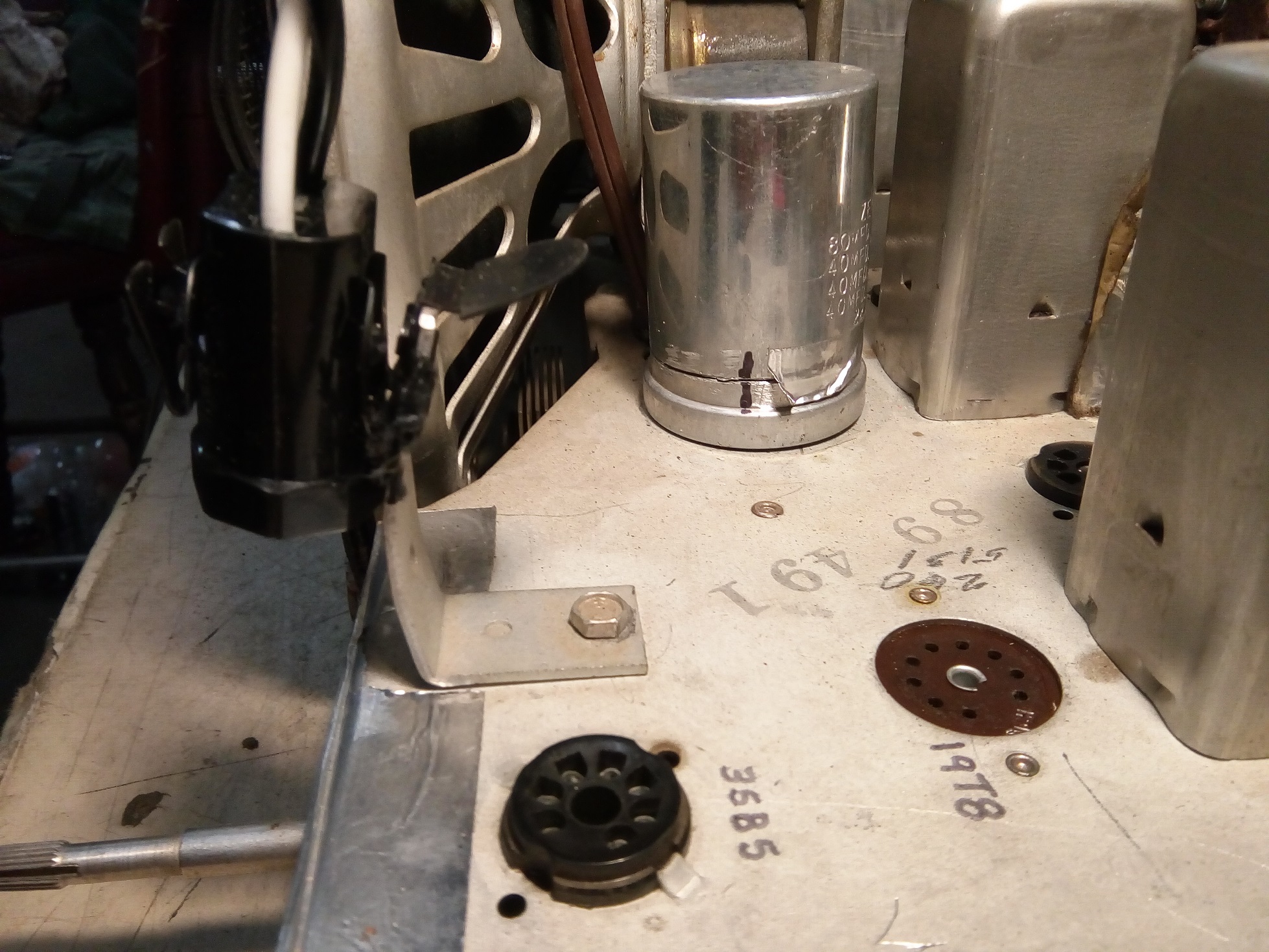

The odd time that I restuff those wet electrolytics I cut them off about 1/4" above the bottom and as Arran said ... remove the wiring stud. Then I restuff, passing the wires down thru' the old wiring hole. I crimp the sides of the bottom part in slightly, clean all well and then glue it back together with by sliding the top over the crimped bottom with a coat of JB Weld between them to hold it together. Ya' cain't see it.

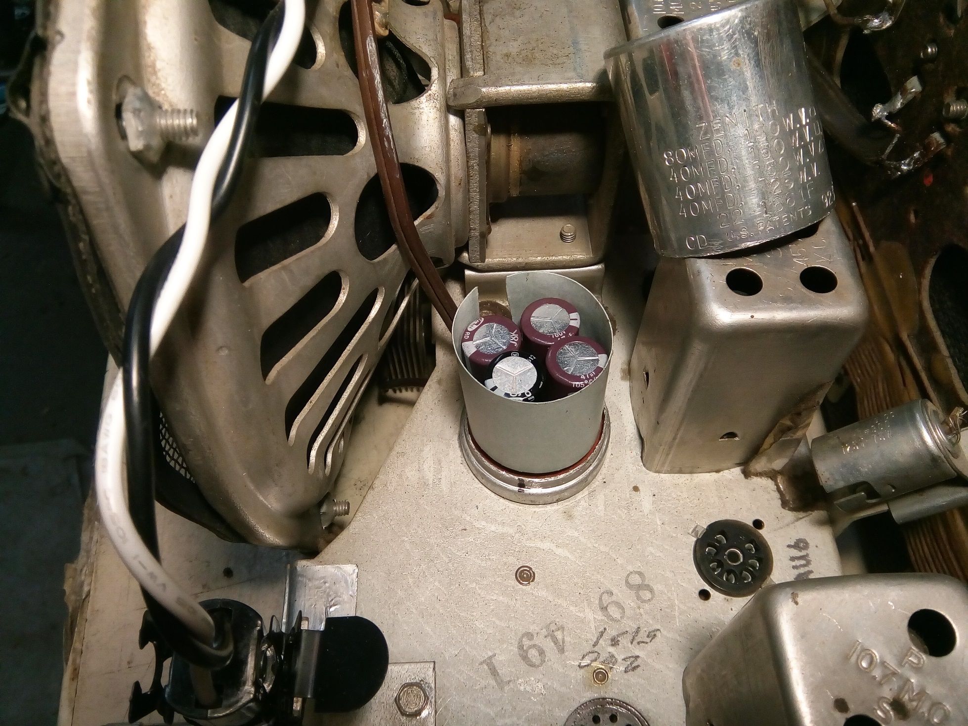

The stud is often made of AL. I replace the stud with a steel 1/4 X 20 and then solder to the top. This make for a more original look and the original connector/connection at the base can be reused.

I use a Dremel tool with a thin-cut wheel and am careful to only cut through the AL skin- not deeper.
I too cut them at the top. You would have been okay if you didn't cut straight through and only nibbled at the circumference.

If you will cut that cap at the factory crease, just above the base, smooth the cut a little with a grinder (very little) then glue it back together with silver silicon, no one will ever know it was taken apart.

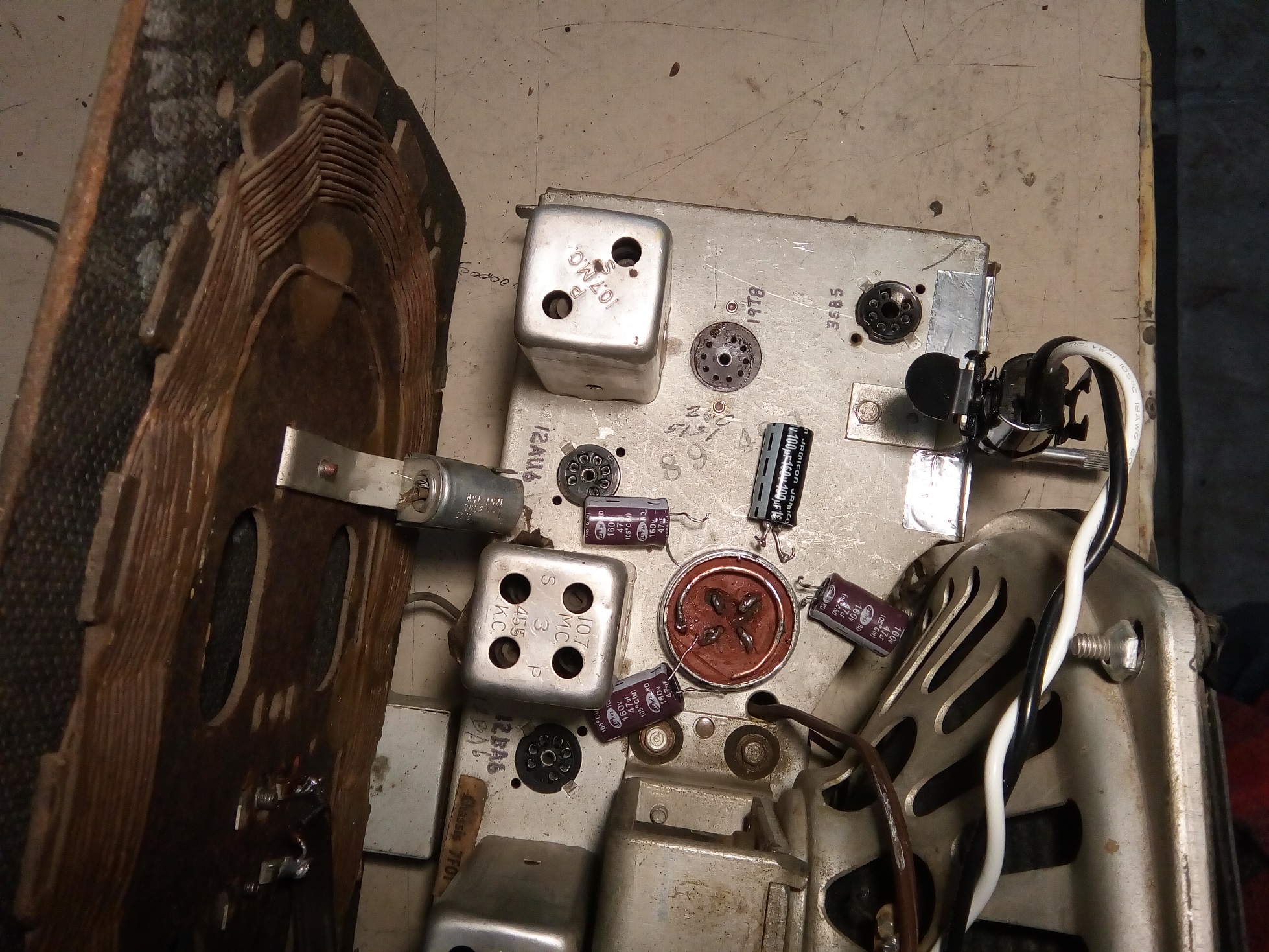

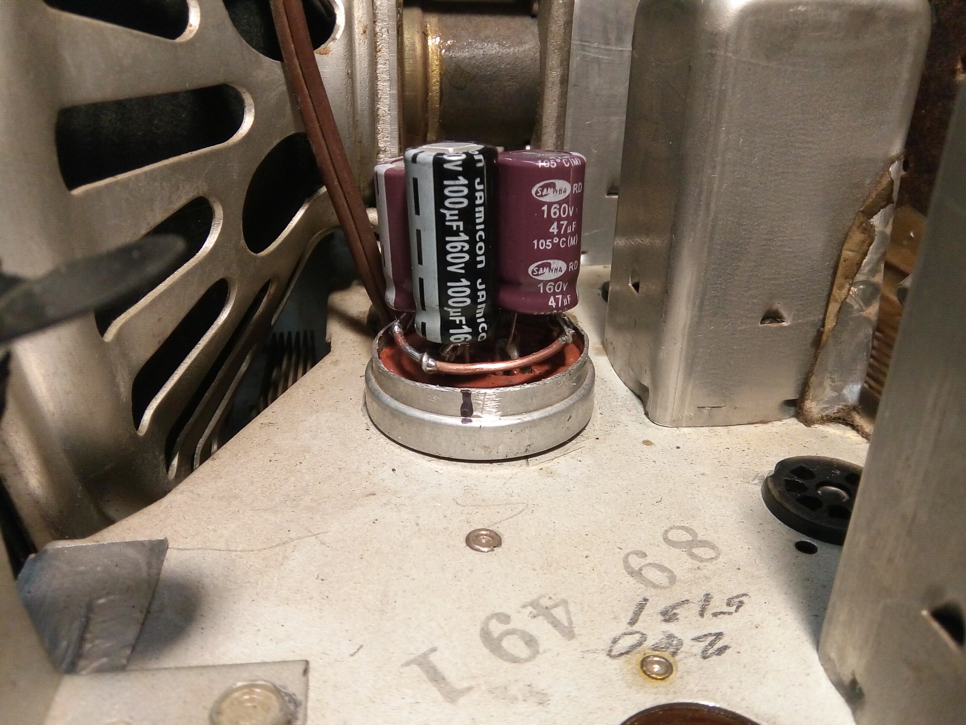

I am doing one right now - usually this style of cap is newer than the radios I prefer to work on - anyway if you would like to see pictures - - -
(04-20-2019, 06:20 PM)Phlogiston Wrote:  If you will cut that cap at the factory crease, just above the base, smooth the cut a little with a grinder (very little) then glue it back together with silver silicon, no one will ever know it was taken apart.
Yes bud, one pic,... a 1000 words.  I would appreciate it.
...I'm a little confused at what you just said. The crease is at the TOP of these caps, not the bottom. . .  .but I thought you indicated cutting at the base. If I attempt this again, I'm leaning toward favoring cutting at the bottom, which looks like it would facilitate the working of the new caps, as well as enabling a crimping of the base , then fitting the top over the base, covering a lot of sins.   It's clear my drawback was not having a Dremmel-type tool.
