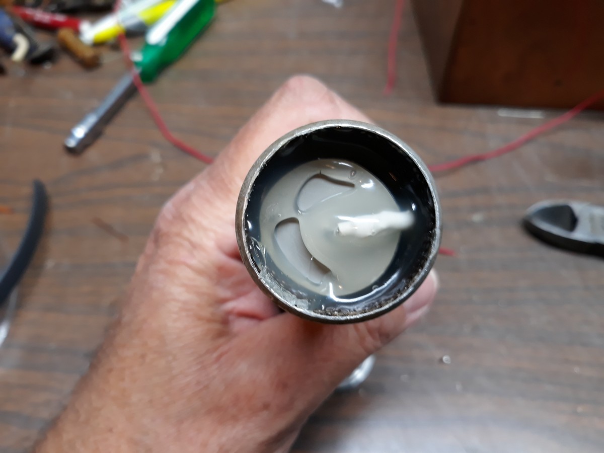

I opened up the 16 uF wet electrolytic can, cleaned it out, and installed two Solen 8.2 uF caps in parallel which will equal 16.4 uF:
Next, I stuffed everything into the can:
Finally, I glued the top back onto the can with J-B Weld.
Now this restuffed electrolytic is ready for reinstallation into the chassis.

is this hotglue I see you put on top the Solen cap?
If yes, when I pot film caps (they are plastic film and I do not know how they react to hot glue if applied straight on) I put a cut to size fitting piece of thin cardboard on top. This will stabilize things without directly heating the cap.
It's the same as when restuffing tubulars with film caps, when we put some wad material before potting the leads (depending on the space left I either roll a strip into a spiral and then put in if there is space, or cut a circle, poke a hole and slide it down the wire if there is little space left). This way even i some hot glue makes it down to teh cap, it is little and will cool fast without potentially harming the cap inside.
John, Mike,
Thanks.
Mike, I have yet to have any issues with hot glue on film capacitors...although perhaps I should be more careful and do as you suggest. I do know better than to get hot glue on electrolytics. Don't ask how I know. Icon_eek Icon_redface
The top of this assembly is a positive lead, as is the bottom - the middle is negative as the caps are connected in parallel to add up to 16.4 uF. A Solen 18 uF 630V cap is too large to fit in these aluminum can electrolytics. So I wanted to make sure the top lead did not make contact with the top of the aluminum can. The hot glue serves as an insulator (along with heat shrink tubing) to accomplish that.
A noble cause indeed Icon_lol
Here's how I see it:
1. Cut  a circular piece of dense paper (backing from a sticky notepad etc) diameter of the can. Should fit in the can snug and definitely be larger than the cap itself.
2. Make a hole in it for the top cap's conductor to go through before you bend it and route it down the can to the positive pin. You could cut a little notch in the cardboard circle for that wire to easily go where it should without having to bend the cardboard. Make the conductor protrude a bit through the center hole in the washer so the hot glue catches on it and thus stabilizes the cap a bit. It is not the kind of assembly that is subject to vibration so you do not have to be overzealous with the stabilizing. Just so it doesn't bend due to gravity back and forth.
3. After assembling everything put hot glue on top.

One more thing. I did measure the (formerly) wet electrolytic after restuffing was complete with the capacitance meter function on my DMM. 16.4 uF, just as it was supposed to be. So the hot glue must not have hurt it.
However, Mike, I think I will go with your suggestion henceforth for that extra level of safety.
