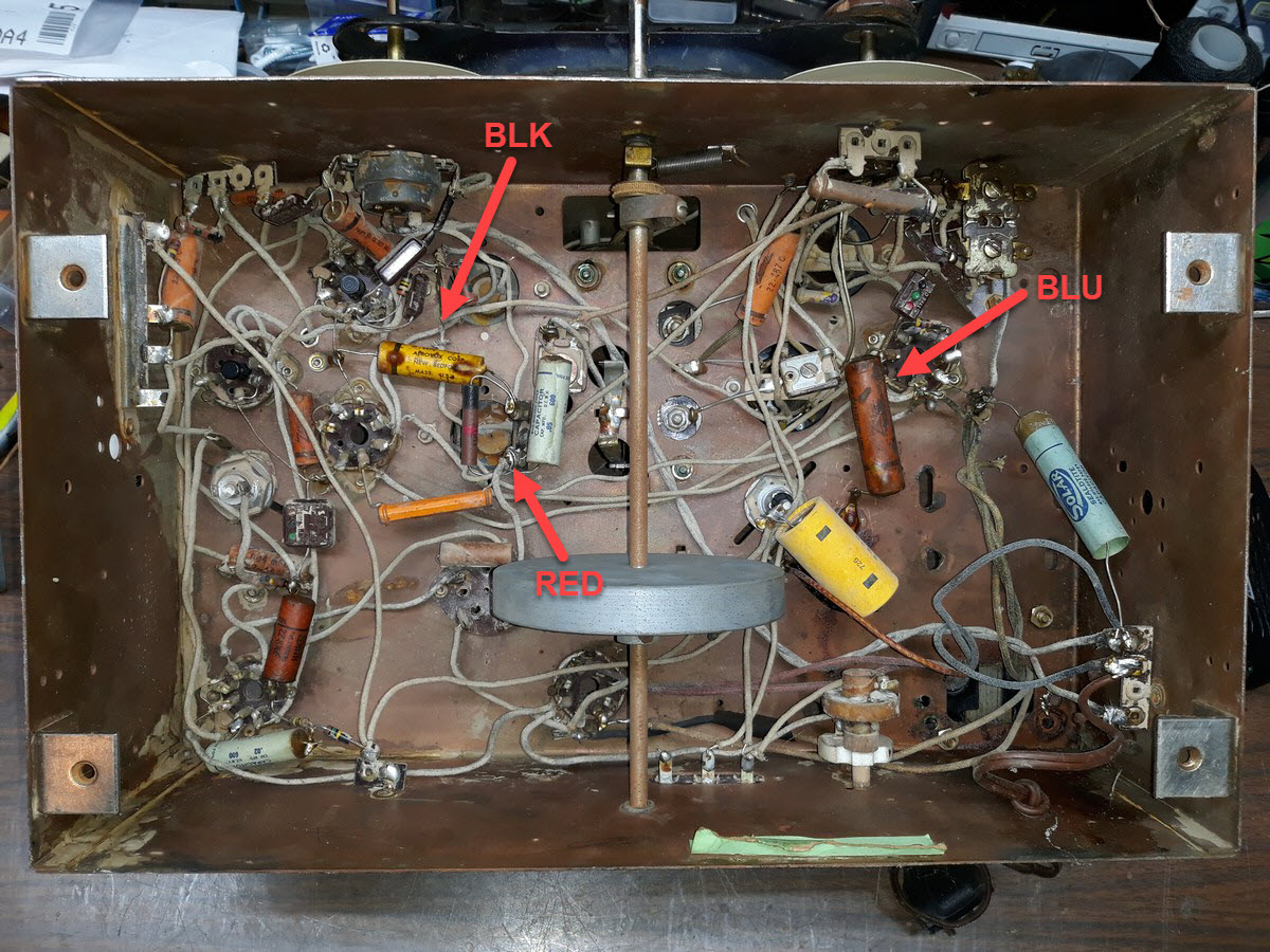

Finally, before I completely disconnected and removed the 1st IF transformer from the 6-S-128, I took this photo to remind myself how it hooked up under the chassis.

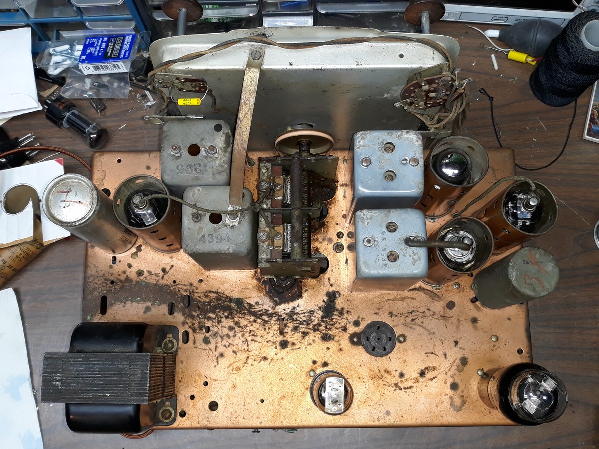

Now, two photos showing the original 1st IF can mounted back on the 6-S-128 chassis.
I failed to mention above that I had placed the mounting nuts and lockwashers in an Evapo-Rust bath and left them to soak all day, so the 1st IF, the 2nd IF shield can, and two nuts from one of the RF coils were not reinstalled until this evening.
