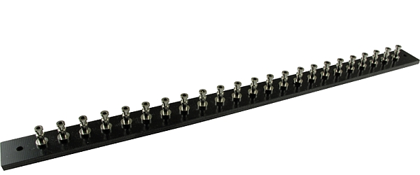

I accidentally stumbled onto something on eBay that I think will make a dandy replacement candohm, a turret strip:
Easy to mount the power resistors and connectors and you can just push out the unneeded turrets and cut to length. As soon as I saw those I decided to forgo terminal strips and just replace the whole candohm. Hopefully if it works as planned I'm going to replace the one in my 9-S-262 later when I change the belts and freshen up the electrolytics. I think it might look a little neater than terminal strips also.
https://www.ebay.com/itm/Turret-Strip-24...2749.l2649

Are the posts through or blind?
How flexible is the board?
Posts: 3,231
Threads: 59
Joined: Apr 2011
City: Lexington, KY
Mike, they are through holes and the board is fairly thick and not very flexible.

I was asking about the posts being through because I want to understand if this has to go on standoffs or not.
Posts: 3,231
Threads: 59
Joined: Apr 2011
City: Lexington, KY
I don't think standoffs are necessary, but I was thinking about gluing a piece of fish paper on the back. In addition the two or three screws that will mount it to the chassis will also go through the fish paper insuring it can not dislodge.
Yeah...that would work...provided there is no or little protrusion.

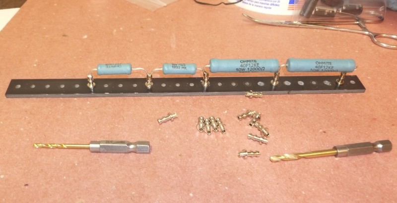

I took the turret strip and power resistors and made my preliminary candohm replacement. I still have to cutoff the excess length, but the finished strip will be almost identical in length to the original candohm, which has at least two bad sections.
A few notes: I used 10 & 5 watt resistors per the recommendation of John Goller (K9UWA).
I decided to remove the unused turrets and found the easiest way was to use a 9/64 drill bit on the bottom and just lightly remove the small lip on the bottom of the turret.
To get two resistor leads to fit in the turret I had to gently enlarge them slightly with a 3/32 drill bit. There are ways around this but it would not be as neat. If you do this drill slowly and practice on a couple of the unused turrets because the first two I tried did not go well. As you can see I wound up with several extra turrets that I could glue back if needed, or if I found a similar piece of base material drill it and make a custom turret strip for a candohm replacement.
All-in-all I'm pleased with how it turned out and my connections to the candohm can just be wrapped around the applicable turret and soldered.

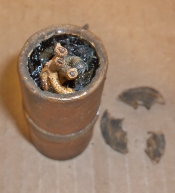

The first is a wax cap under the chassis that contains three 10 MFD caps @25 volts. I replaced these with 50 volt caps. I cut the top of the cap into 4 sections with a utility knife so I could remove it without doing too much damage to the rolled lip of the capacitor:
I was then presented with a very hard black tar. I heated it with my heat gun on low to prevent scorching the cardboard sleeve of the capacitor. Unfortunately the tar never got soft enough to pull out, but since the replacement caps are so small I just dug out a little cavity big enough for them:
I set them in hot glue to hold them in place and then finished with brown hot glue, and have since trimmed off the excess heat shrink with an Xacto knife:

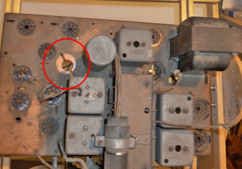

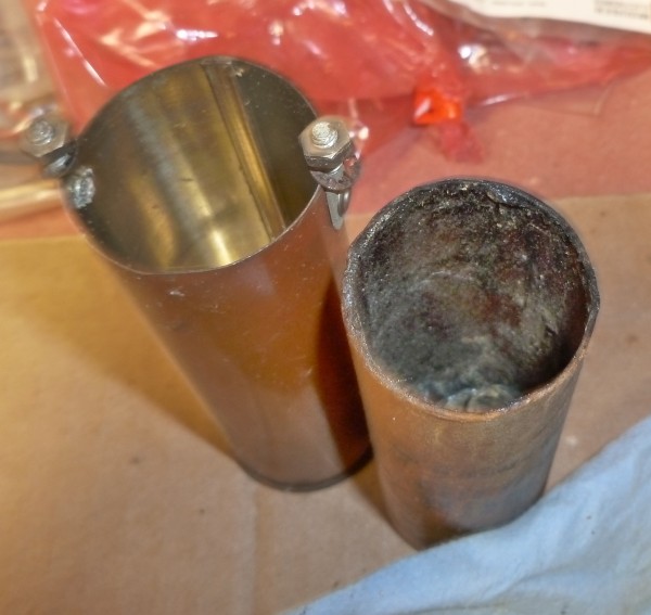

The next electrolytic consisted of a 4 and 8 MFD mounted above the chassis. When I removed this capacitor it became apparent just how filthy this chassis is  :

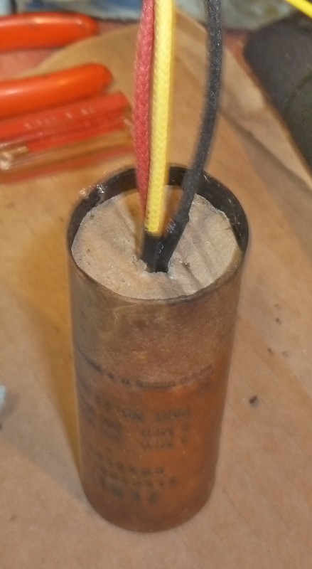

This dual section cap was just a cardboard tube that slid inside the Zenith orange can that mounted on the chassis:

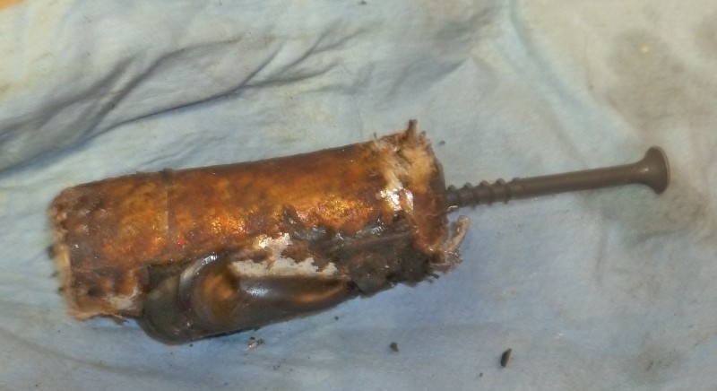

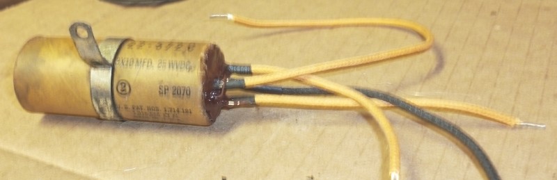

Presented with that same hard black tar I decided to take a different approach and stuck it in the freezer overnight. I then wrapped it in a shop towel and smacked it with a hammer (several times) and all the black tar eventually cracked and fell out. I did have to sink a drywall screw into the actual capacitor to yank it out:
I put some filler in the tube to take up space, shot in some hot glue to anchor the capacitors in place. I then made another cardboard disk to keep from having to use so much glue as filler:

I did take an hour or two to wipe off most of the dirt on the chassis, but I'll have to remove items to get everything as clean as it should be.
