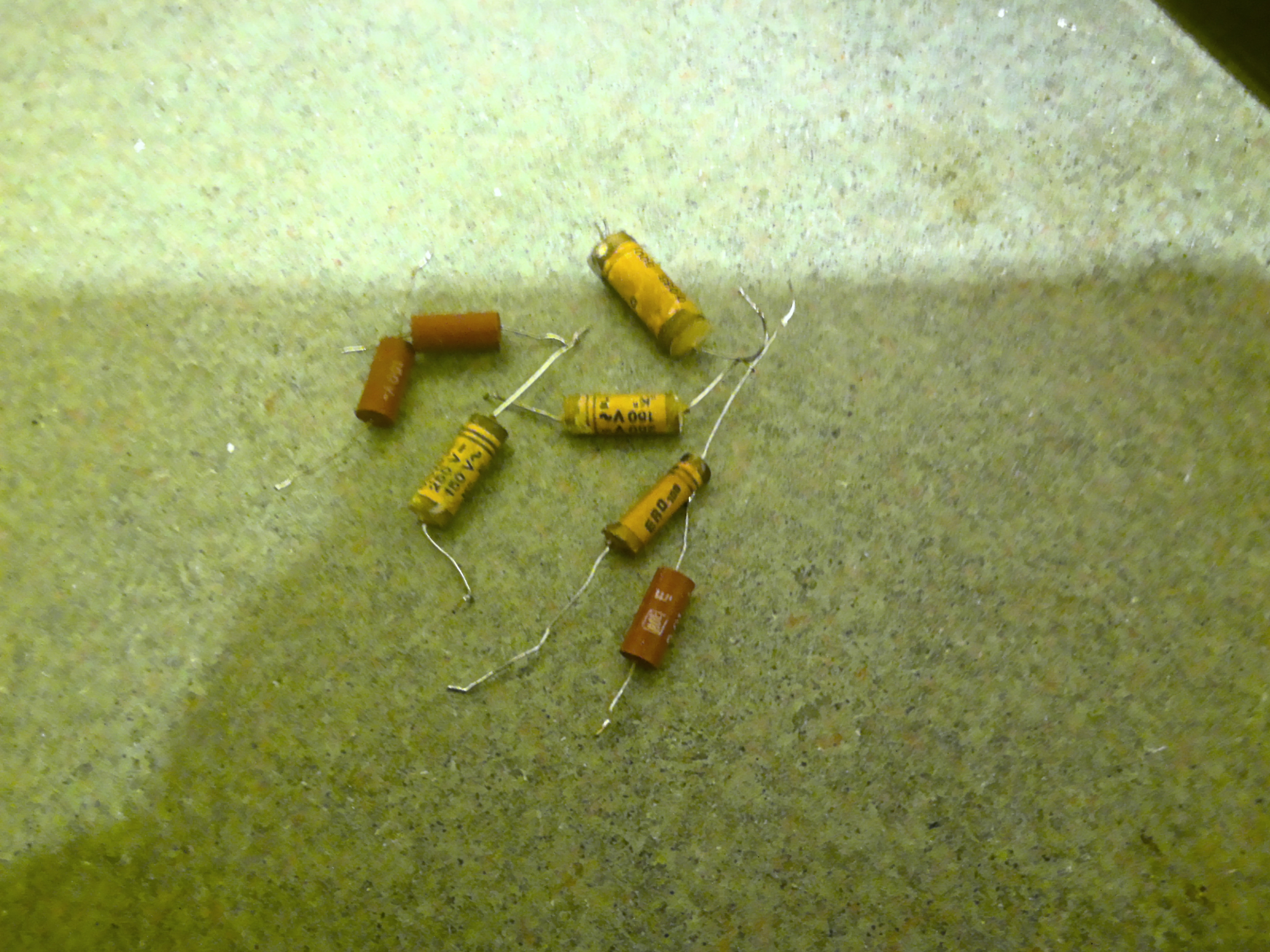

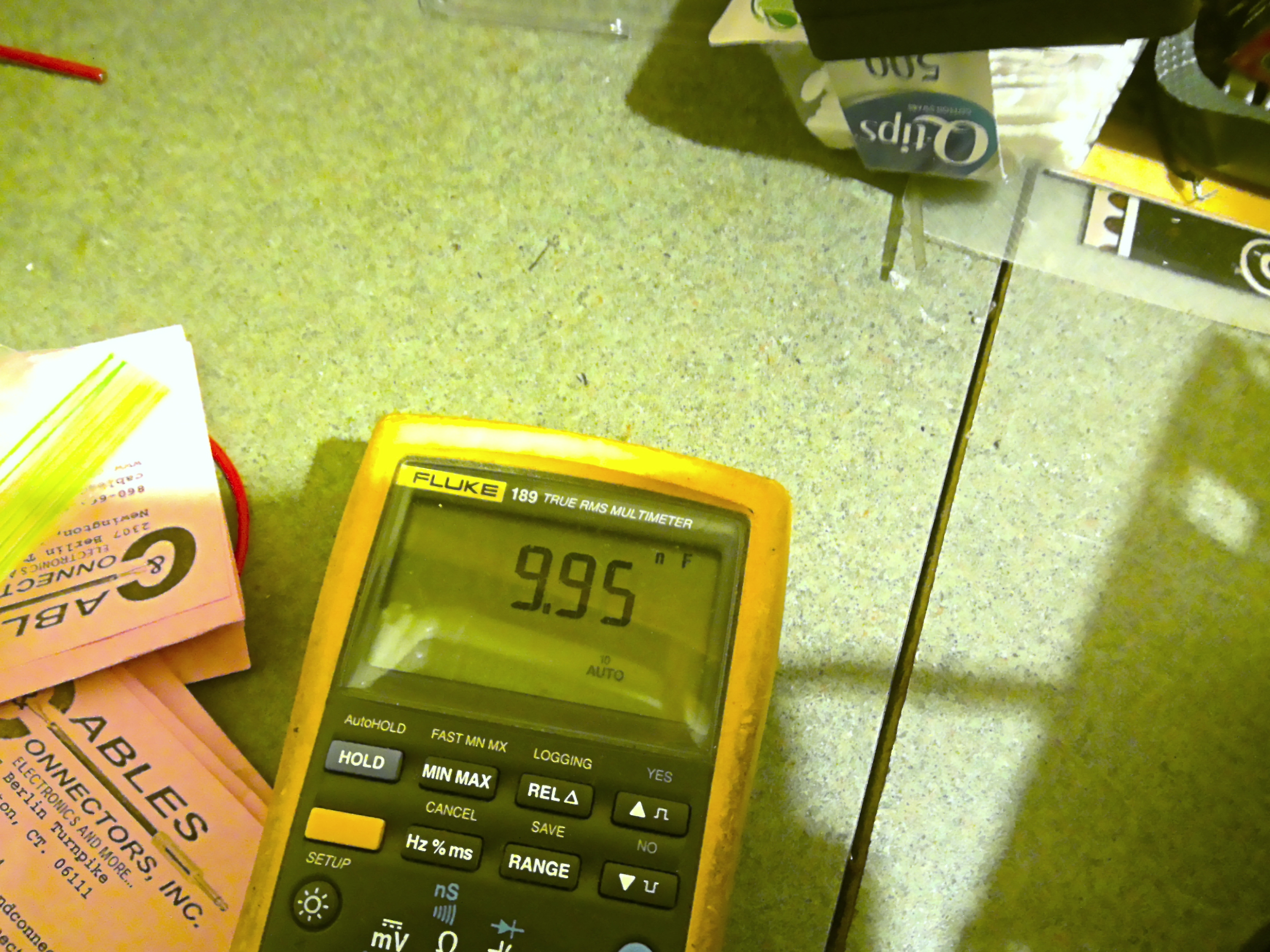

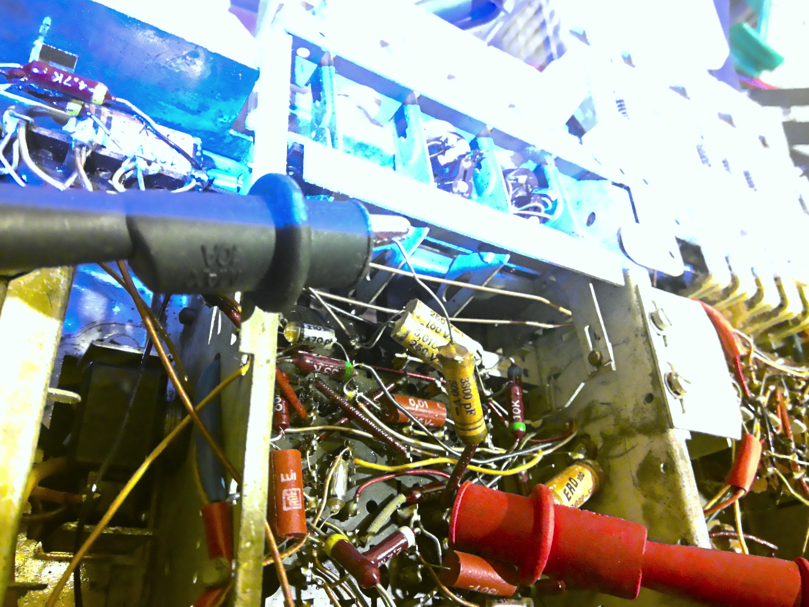

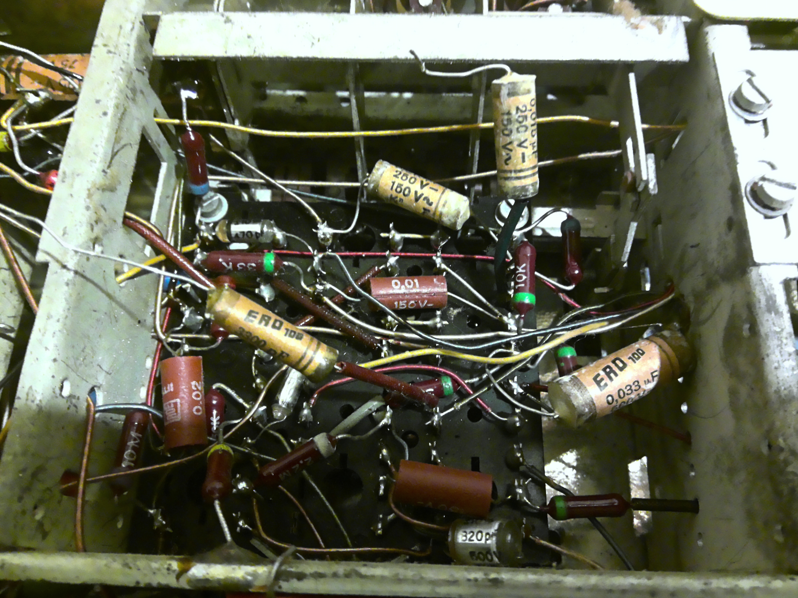

It seems the radio employs a multitude of paper caps. Or they look to me like paper caps, so I decided to check.
Here is 3,300pF cap being measured out of circuit.
The one marke 0.015uF is 0.059uF.
So it seems like a recap is in order. I was hoping to avoid that.
Those brown plastic-molded ones are also way up. About x2. The paper-looking ones are x4.

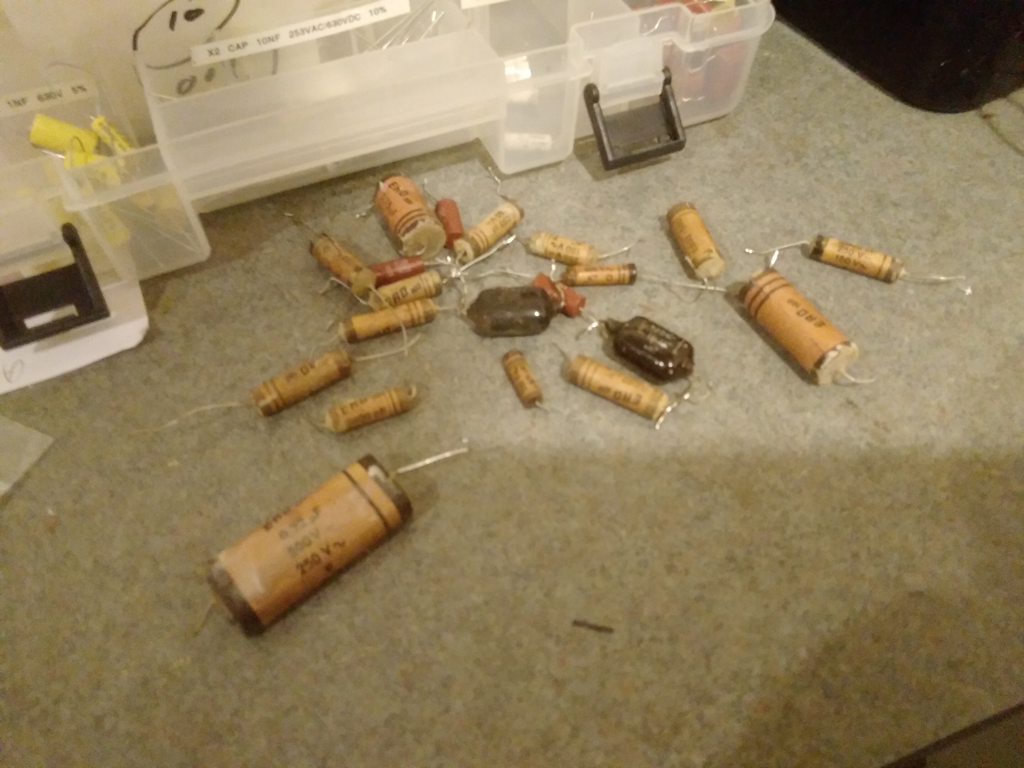

Rod, yes, ERO caps.
All gone.
Before
Extracted
After
This is just one compartment. There are many more.

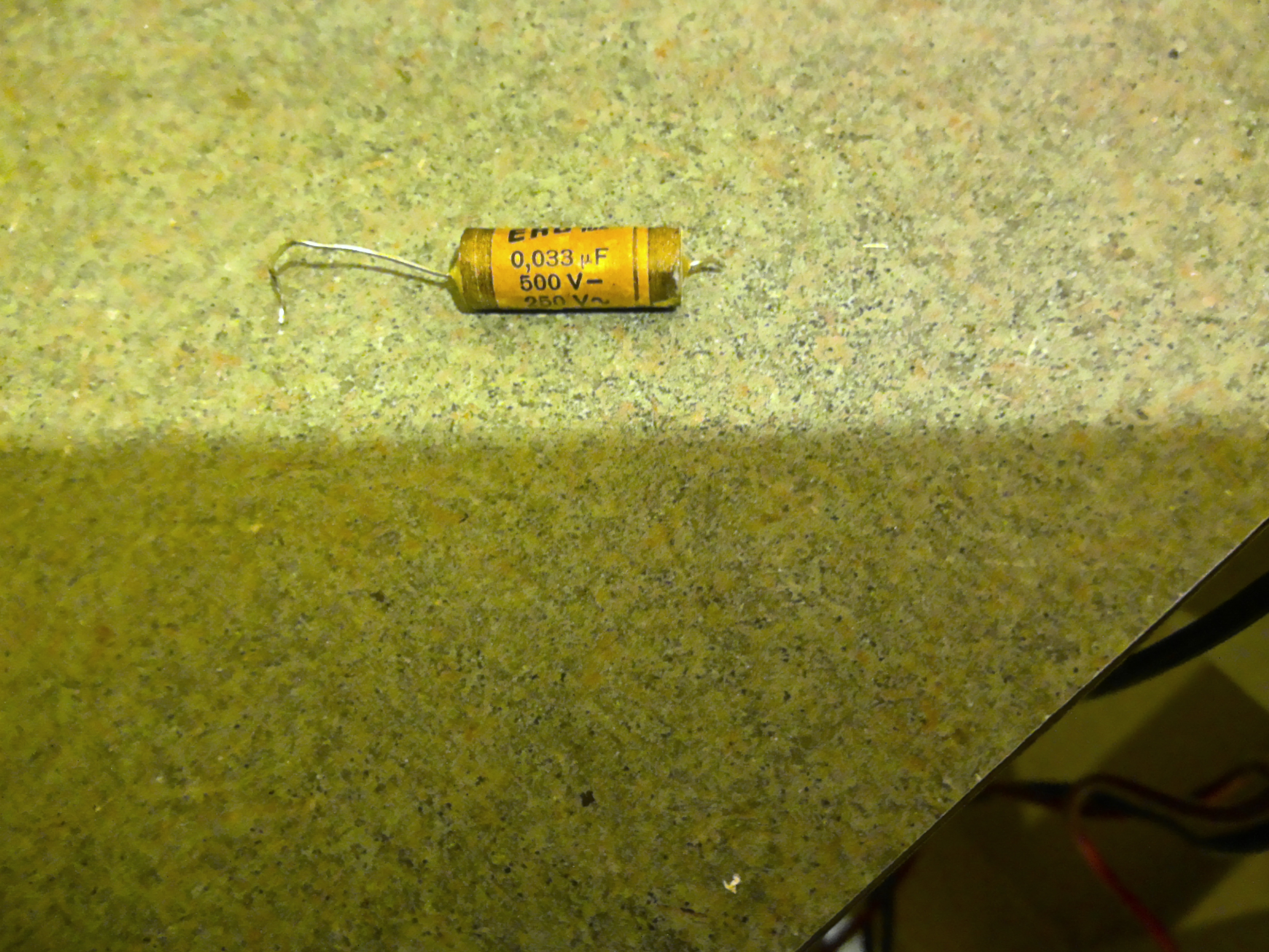

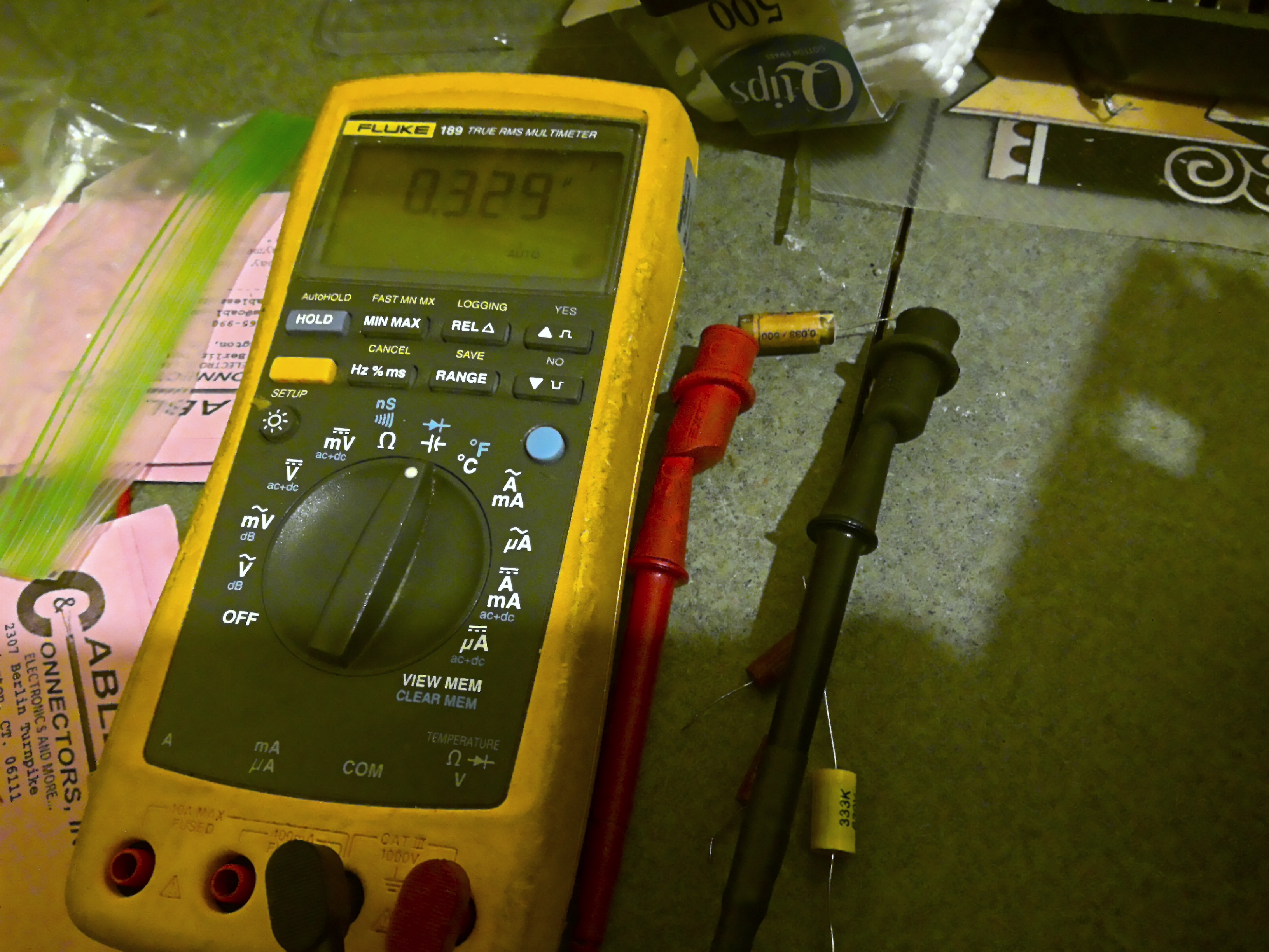

The testament to the leakiness is this cap:
0.033uF
Measures this:
0.33uF, that is exactly 10 times more. Imagine what leakage causes this.
With this kind of leakage AND weakening tubes, I could only imagine why this radio was never played for the last 30 or more years.

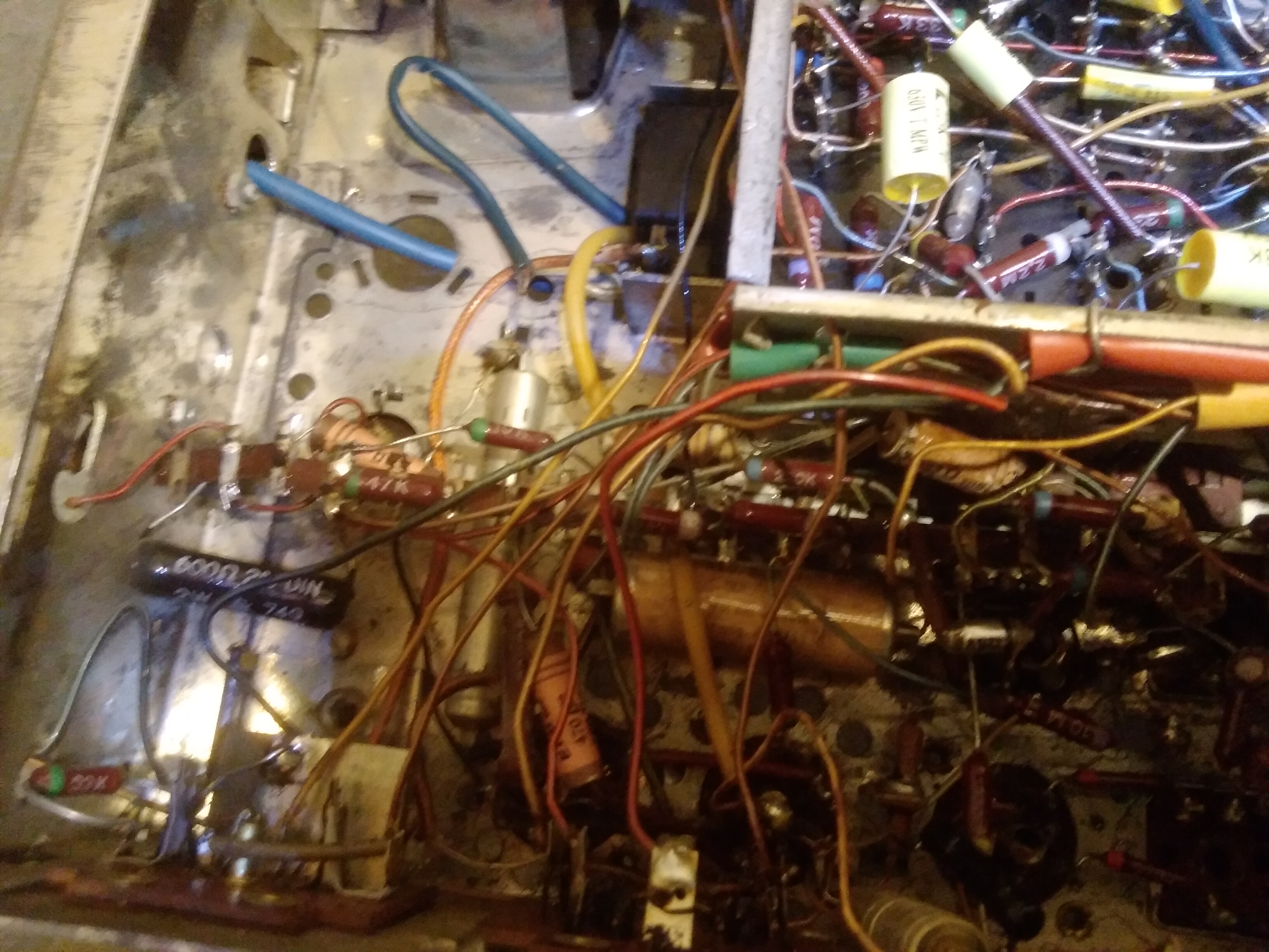

I keep extracting caps. It looks like every single cap except tube ceramics will be replaced as they all exhibit x4 to x8 upward drift. This is promissing to become the largest recapping job so far for me.
Some caps are under the output transformer, so I had to extract it; no small effort.
But it will afford me the chance to also replace the filter electrolytic, plus some real long slim axial one, plus some paper ones.
There are some caps I had to parallel: 0.068uF became the 0.022+0.047, or 0.15uF = 0.1+0.047.
Most caps are soldered in such a way that they come out easy. But a couple had the leads looped.

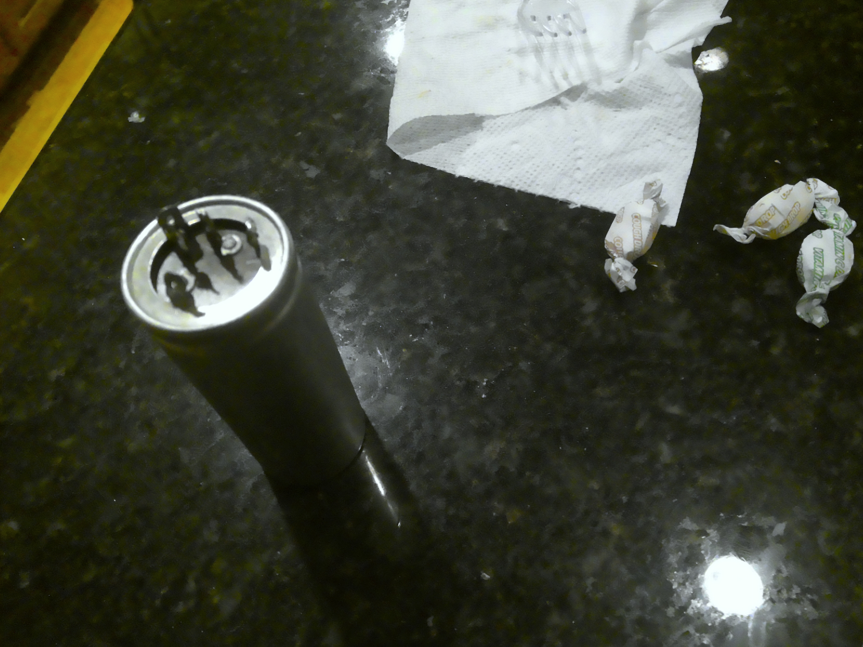

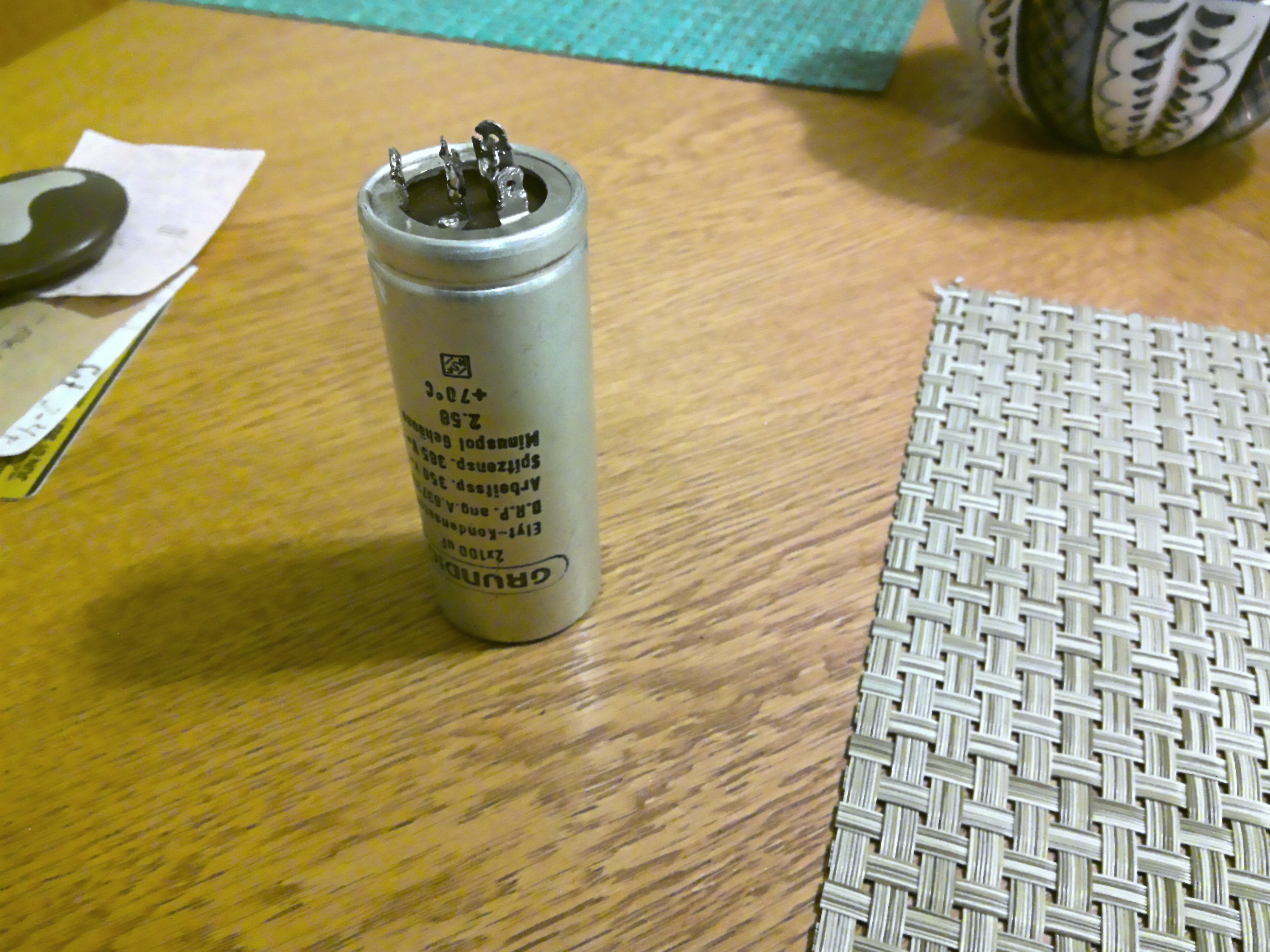

Removed the twistlock cap.
It is a dual electrolytic 2x100uF, 350V WV.
It also has raised leads panel, as the opening in the chassis is small and were it not for the panel being raised, the leads rivets that hold them to the panel would be touching the chassis.
I doubt this exists as exact fit. Ordering from Hayseed is an option if they could replicate it to it exactness.
Or.....restuffing.
Surprisingly the caps measure about right but the measurements fluctuate, and I am reluctant re-using it the way it is, considering what it takes to extract it should something go wrong.
There is that
https://www.tubesandmore.com/products/ca...v-100100-f
But I have to see the twist tabs and connections drawings before I could decide.

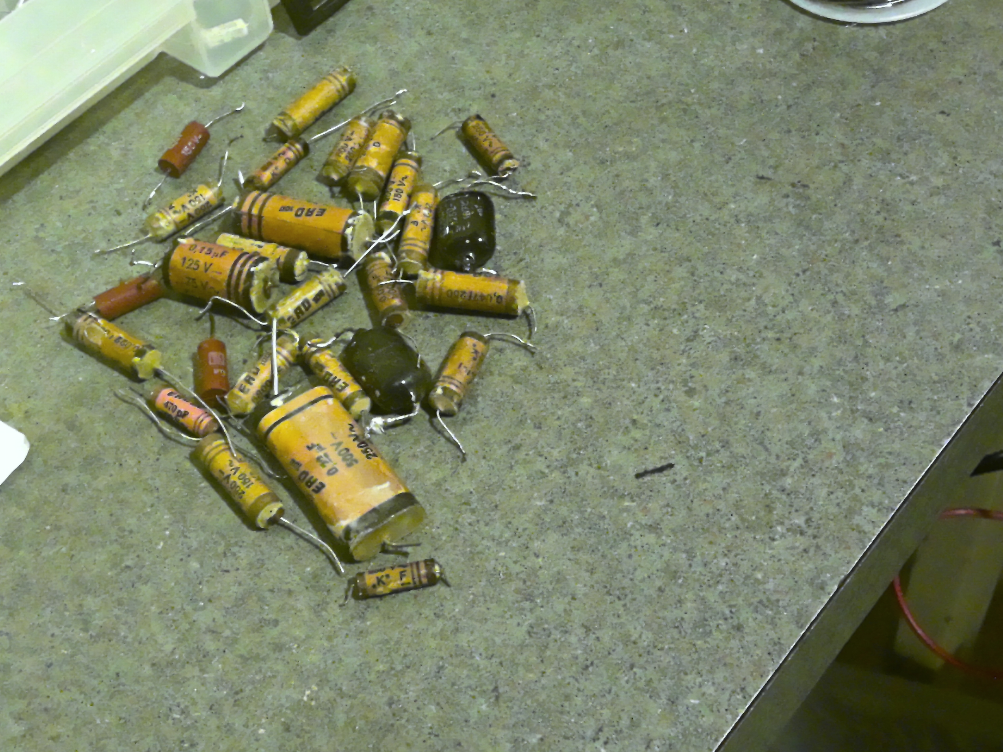

This represents about 2/3 of what is there.
Not counting the electrolytics.
There are a few polyester caps, they are ok.
EVERY SINGLE paper cap is SUPERBAD. The drift upwards is up to 10x in some.
Posts: 16,533
Threads: 573
27 caps.

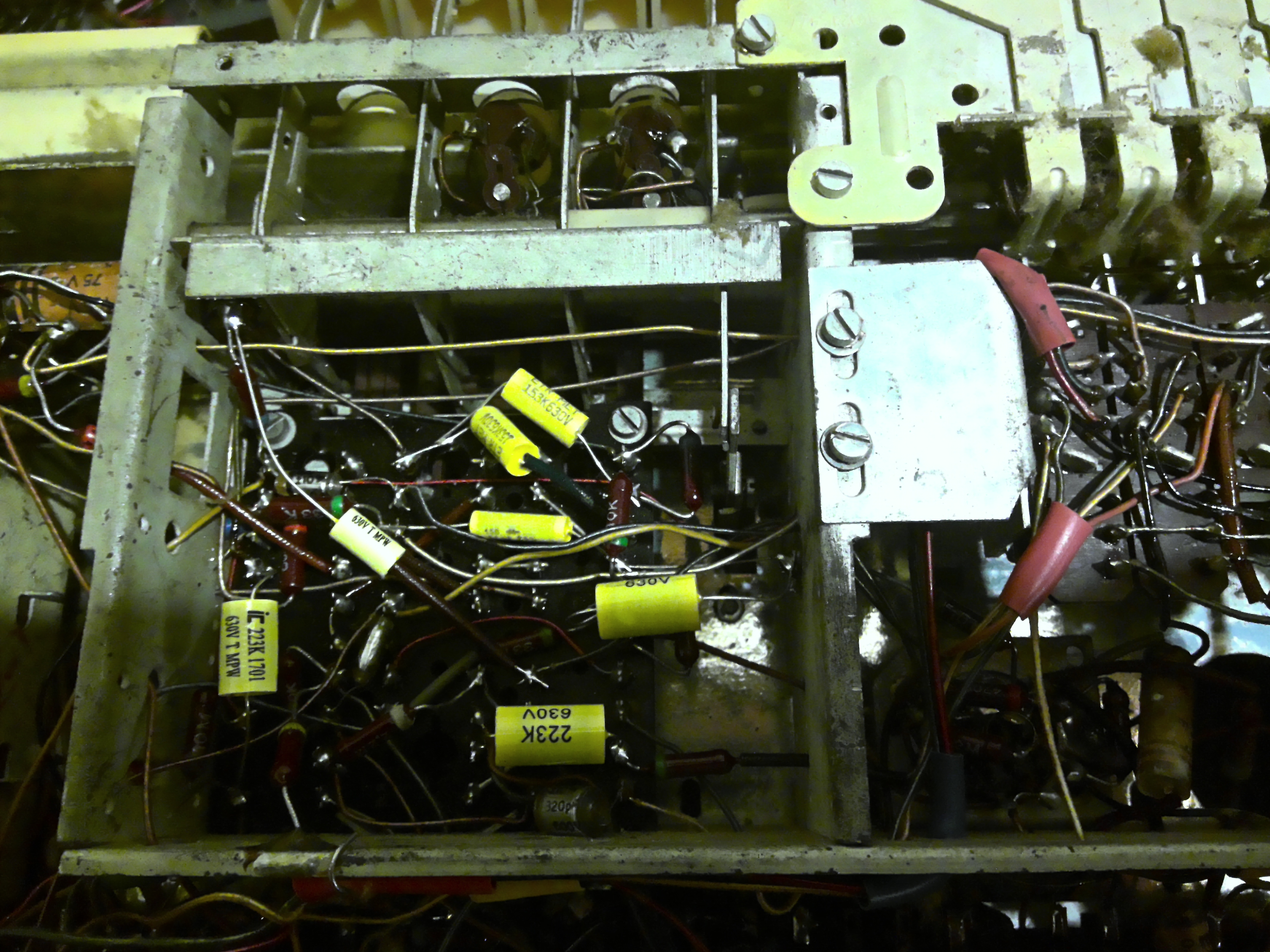

Capacitors came in yesterday - Mouser continues free upgrading of USPS to UPS Blue.
So I finished all except the main cap, which I cut open today and it is being soaked in vinegar to neutralize whatever it is there to neutralize.
Then it will receive two high ripple 100uF 400V caps.
Then I pray God I remember how all was connected - the photos should help - and then I have to re-install the output transformer.
