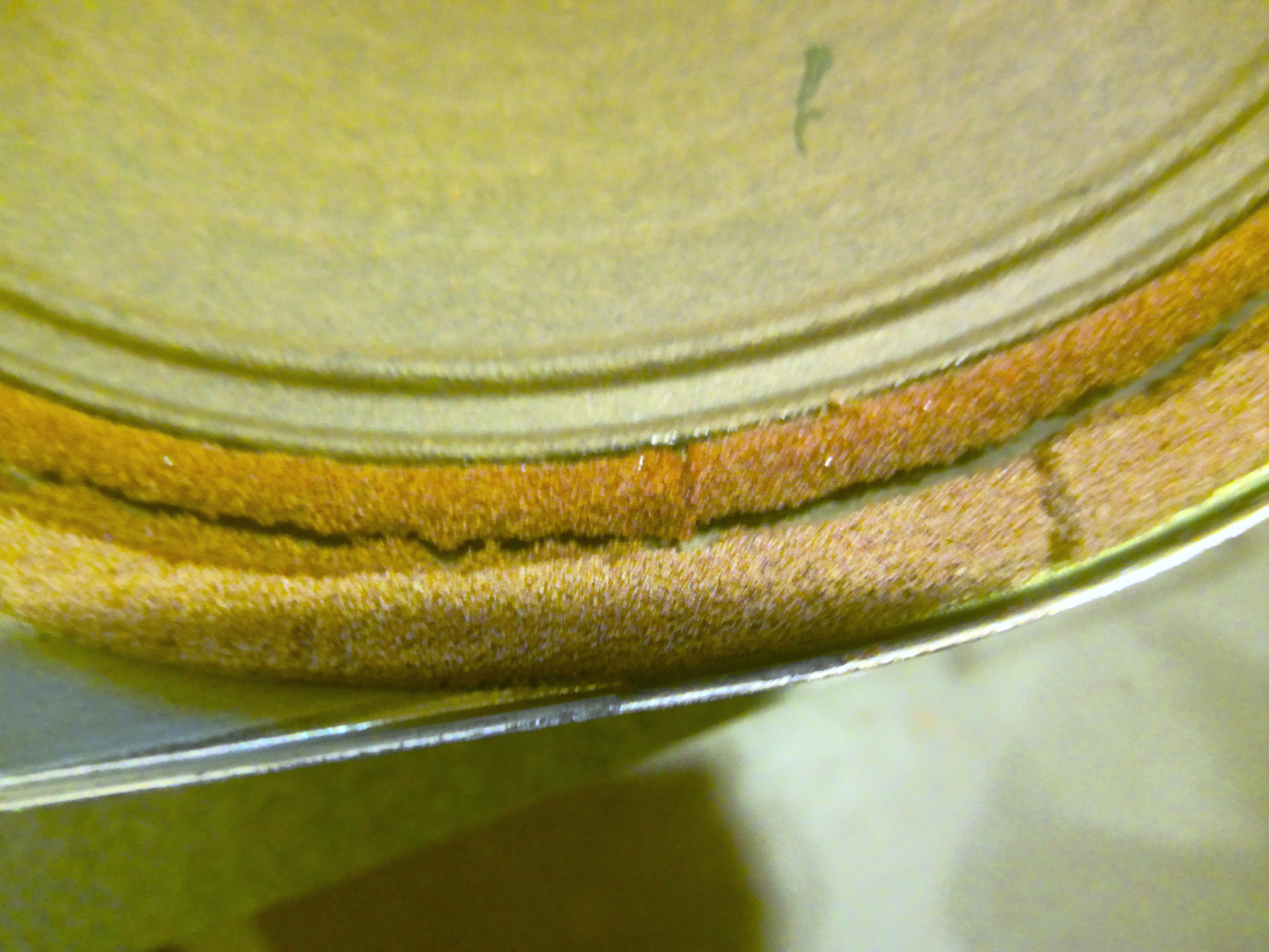

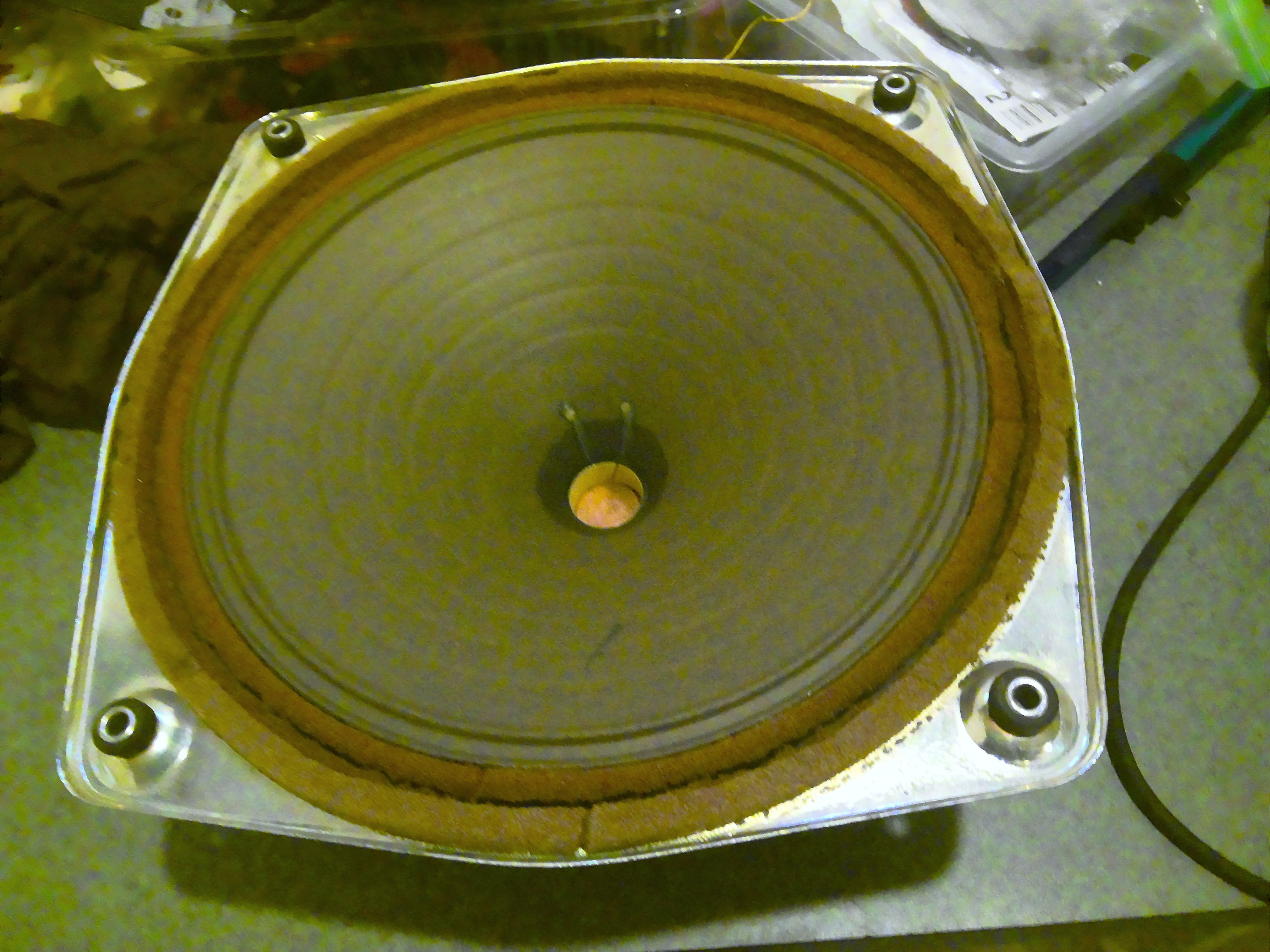

Well, I was afraid of it.
When reading the Radiomuseum thread on this radio by Rudiger Walz, I learned the woofer's cone rippled outside part that connects to the basket rim, and which is made from some sort of foam, disintegrated and the cone was loose.
Today after I put everything back to the chassis, I put it in the cabinet and played it. I heard bad rumbling and I realized I probably have the same problem.

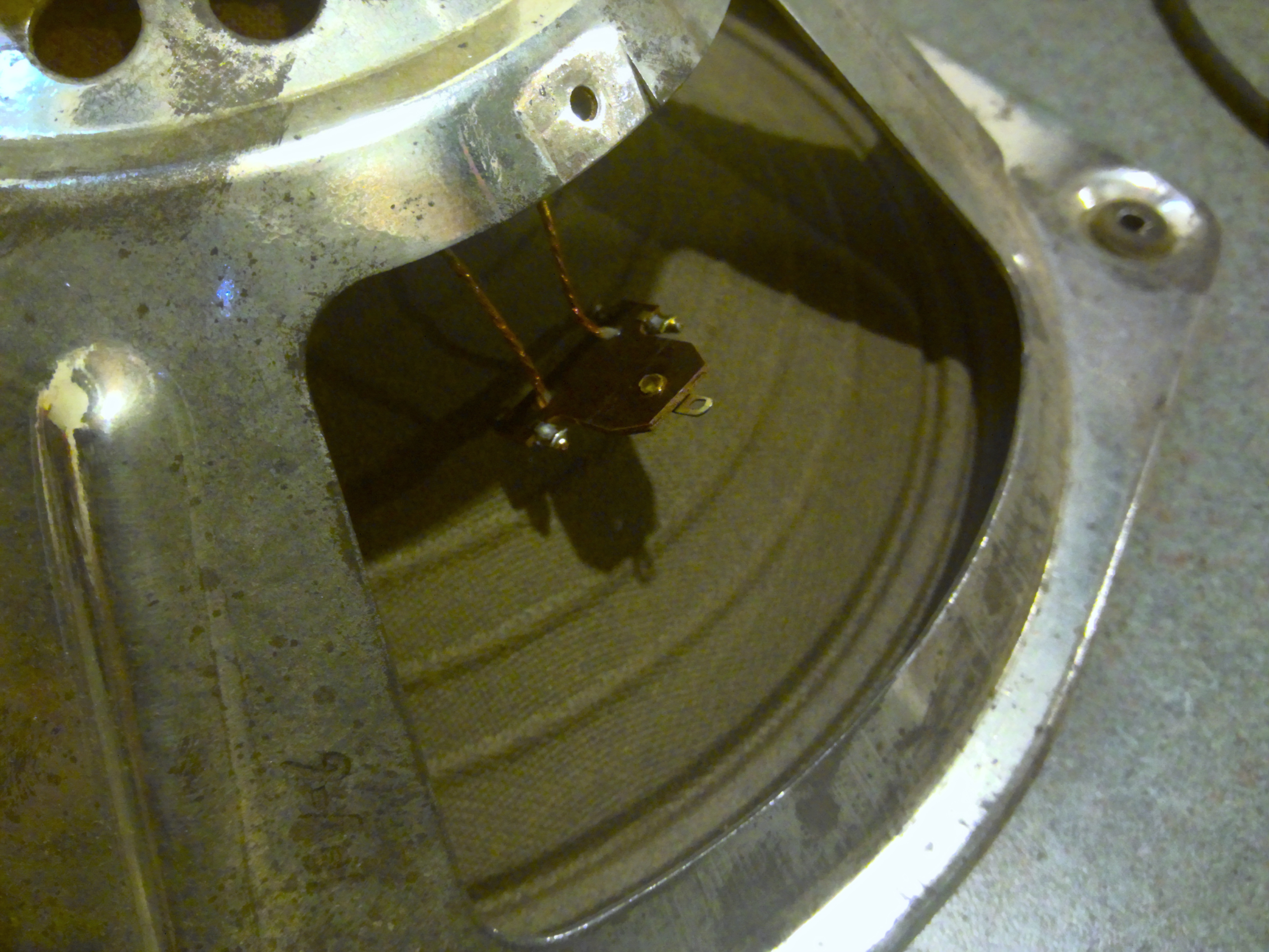

I disconnected the woofer and opened the cloth it is wrapped in.
I saw exactly what Rudiger and the other person who commented on his thread both described.
Not only that, but the soldering post that connects the wires and was riveted to the basket, cut through the rivet and was loose also.
So, the cone is in great shape, so I think sending the speaker to Dave in the Speaker Shop and asking him to supply it with a suitable rippled circle.
I think the soldering post could be just screwed with a small screw and a locking washer.

I called the Speakerworks who I was pointed by AJJ on ARF, they sell re-foaming kits. They have not come back to me yet and from talking to them I think they might not have what I am looking for.
So I called Rich and he said that he has a foam surround for 10" unit; it is wider than what I have but he would make it work.
And, considering that, if I were to send it to the oter shop to do, it would be $50 while Rich does it for $30 - the choice for me is well delineated.
