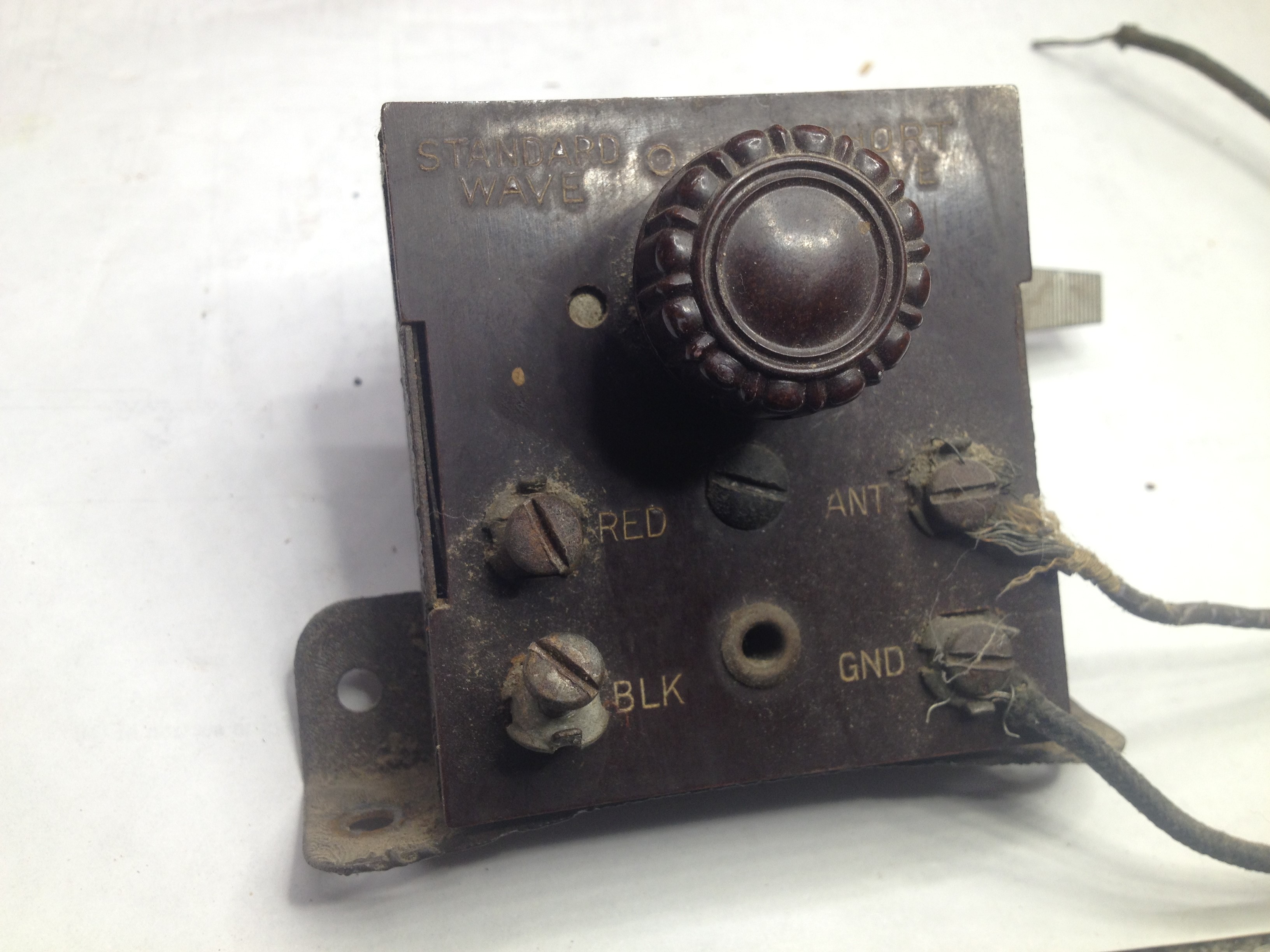

Something thats curious to me is the added on Band Switch you'll see in the photo of the back. Not sure its even a Philco brand, as there is no name, part# or anything on it. Would this have been some sort of option?  I did see this same switch in a photo on another 201X on the internet somewhere.
