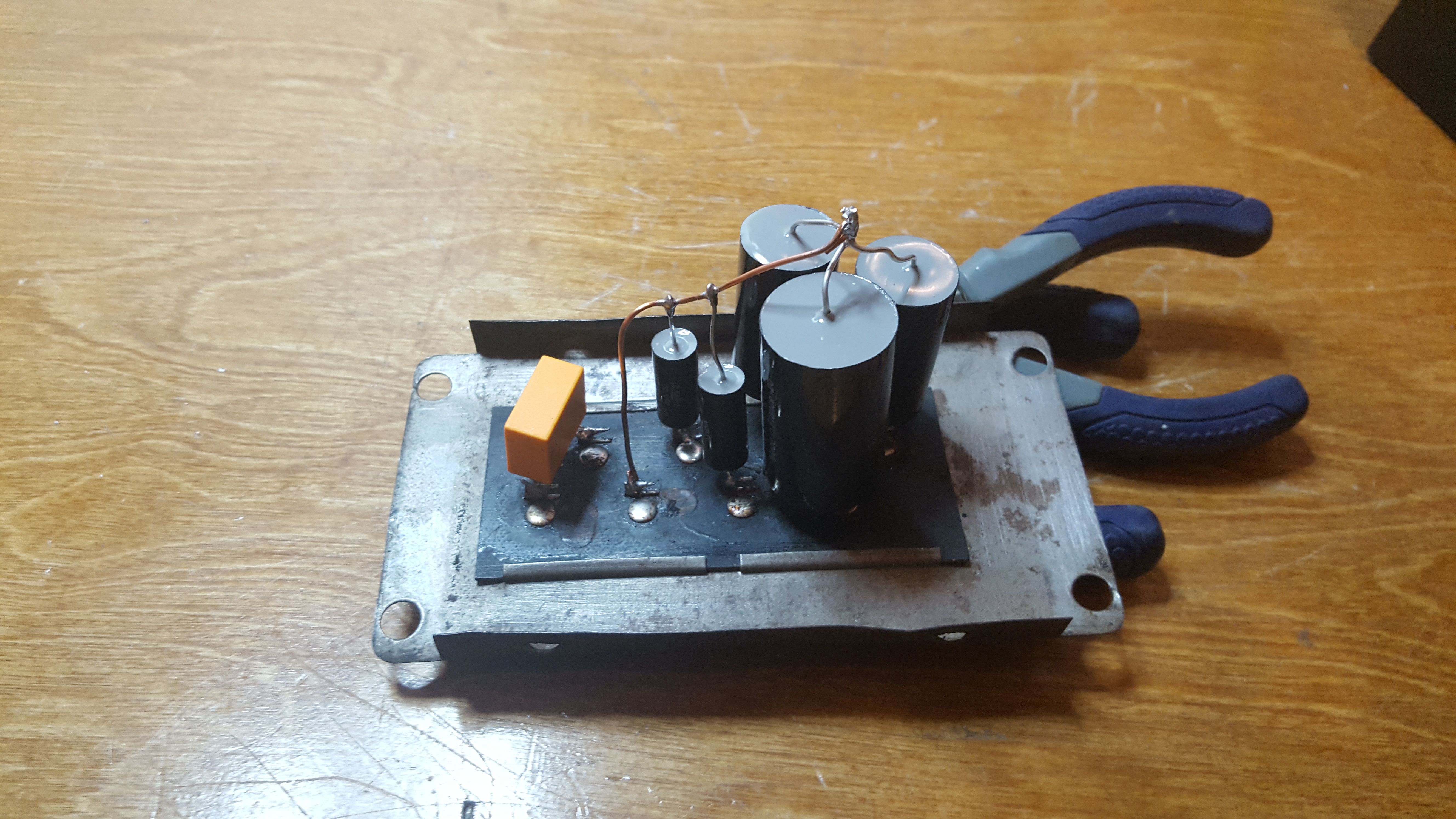

Question for y'all, I neglected ordering the .015 cap that goes from 7 to 8 in the cap can when I ordered the solen caps. I would like to keep going with this since the caps came in today. Can I use a .015 Y2 box style safety cap for that? The only one I have on hand is a .01 orange drop.

I think it should be Y-rated cap anyway. Yes you are OK to use it.
In the link I gave you earlier you could see I used a yellow disk ceramic safety cap for it. it is also Y2 rated. I used 10nF value (popular for these); it is not really important.
I agree. In the model 87 I recently restored, I used a .01 uF X1-Y2 safety capacitor to replace the .015 uF cap since one end of it connects to the AC line.

Just a little progress, managed to open the small can and install two .47 caps inside. Now to mount the large on and hook it up and then do the push pull install, still worried it wont handle the load. I cant find a substitute for the 71A tubes. They are expensive and would hate to burn one up when I get to testing.
