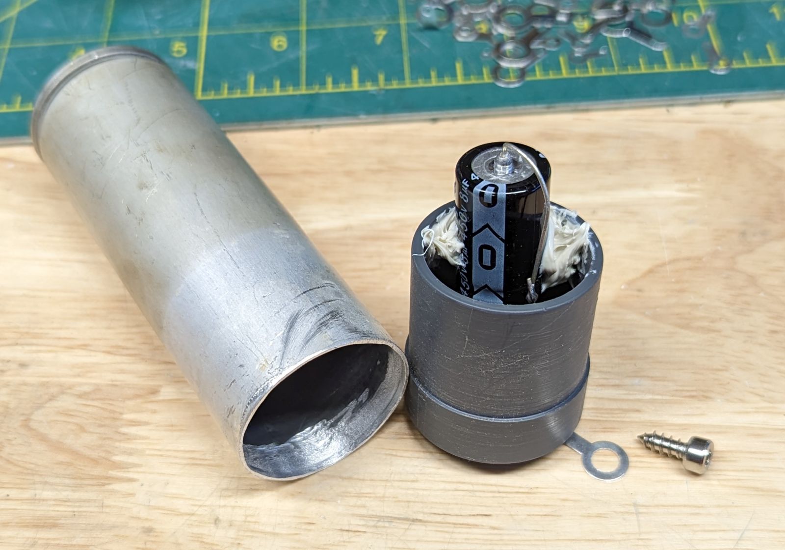

Cap stuffing!

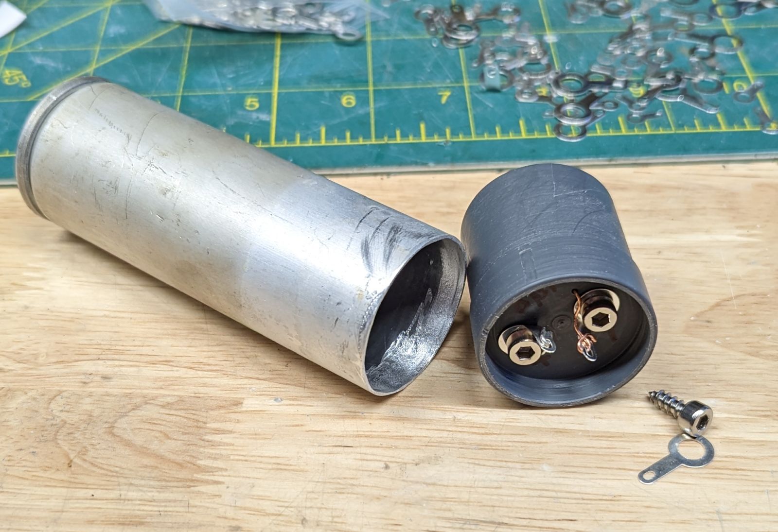

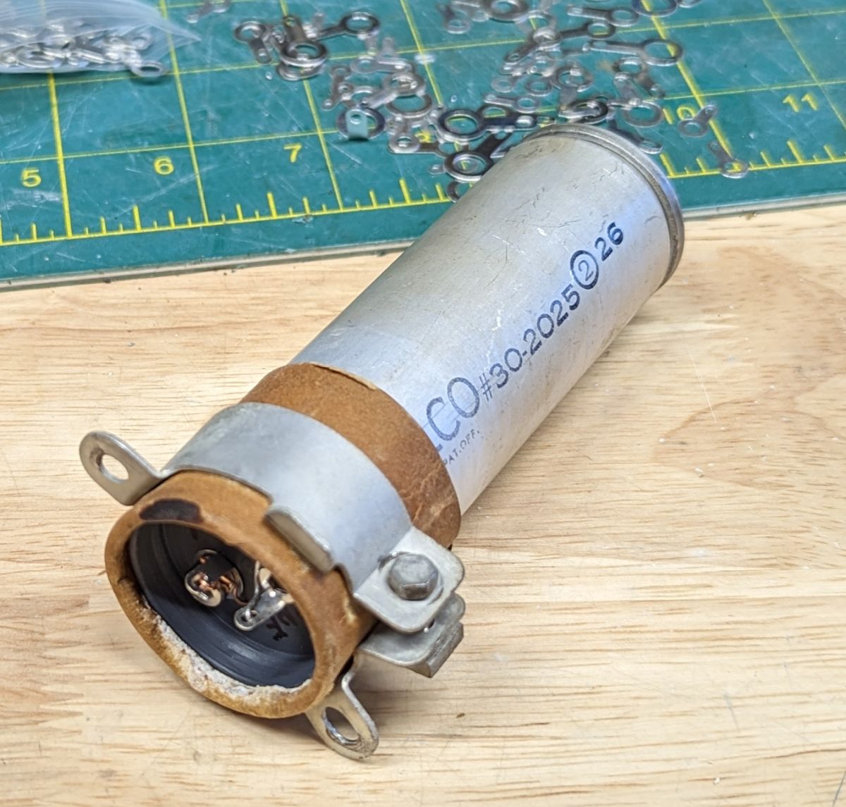

I've emptied all the Bakelites and gutted the e-cap cans, and I just received a bunch of new caps from JustRadios.
For the cans, I have a little variation: Just because I have the material and a lathe, I turned new bases from solid PVC bar. Cap leads come out the bottom and attach to screwed-in solder lugs. This includes the leads that would go to the trapped side lugs on the cans, so the cans are now isolated from circuitry.

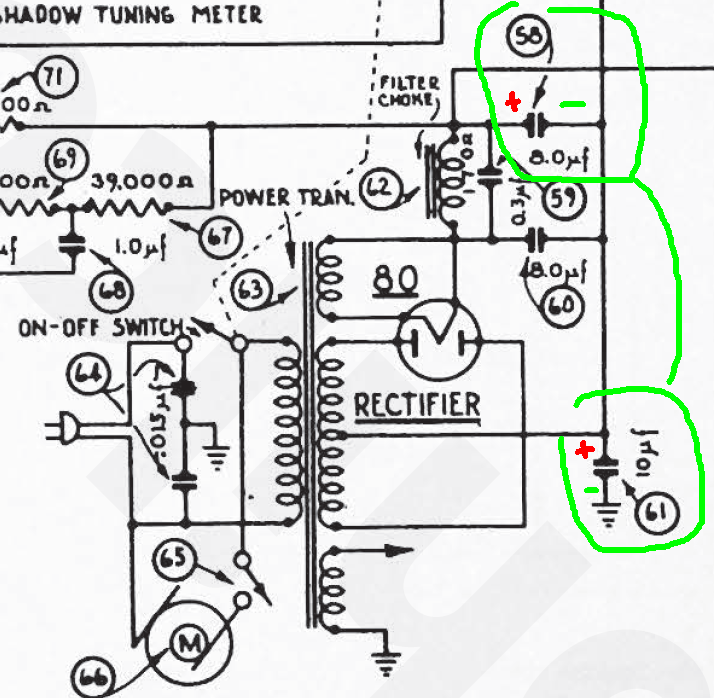

One can is an 8 & 10 μF combo. I was about to rebuild it by blithely tying the negative leads together... nope! Read the dang schematic, duh. They're in series.
New turned base with solder lugs for the 8μF ecap:
ecap secured with a glob of gooey glue:
Assembled with insulator and clamp-  solid:
Not the can above... but another can combines e-caps 58 & 61... in series.
It looks like you have the polarity of cap 61 reversed, the - should go to the center tap of the HV winding and the + should go to chassis ground. Always remember, the HV center tap is the lowest voltage point of the radio.
M R Radios   C M Tubes
Hmmm, so much for my understanding of grounds and center taps... thanks! I hate blowing up e-caps...

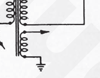

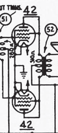

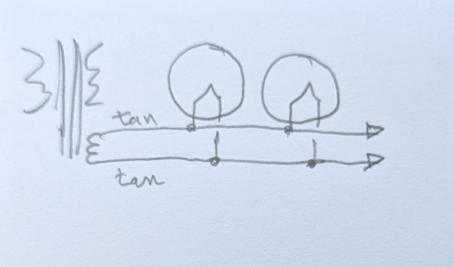

OK, a question about the filament wiring.
The 655 schematic has the typical format, with filament transformer winding grounded on one side, and an arrow off to the filaments. It also shows most of the cathodes connected to one filament pin AND ground.
I've traced all my wiring (I think), and see:
- NO grounding of the filament circuit anywhere,
- NO connections of cathodes to filament circuit.
Is there any deeper understanding to be had for this situation? I suppose it doesn't matter that the filaments are on their own floating circuit, but why show it differently in the schematic?
EDIT: I'm clearly missing something in my wire tracing, and yet further puzzlement: With all tubes pulled, BOTH sides of the filament circuit measure ZERO ohms to chassis.
How does THAT work?
655 schematic, at transformer:
655 schematic, typical tubes with cathode-filament-ground connections shown:
Actual layout in chassis- No filament grounds, No connection to cathodes:

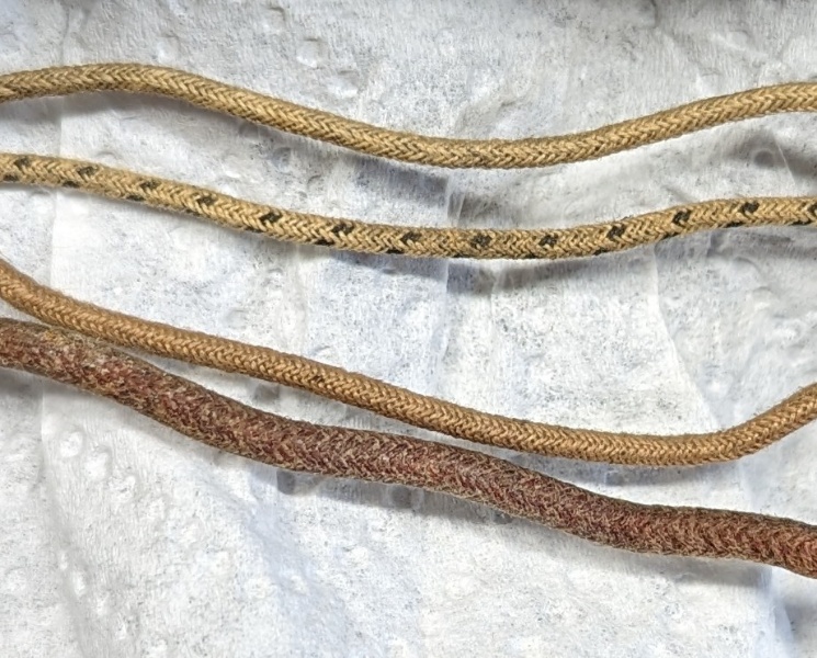

A comment on wiring colors:
I found the section here in Shop Talk on this subject, and extracted:
(starting 1934-ish)
RED . . . . . . . . . Filaments and odd wires
BROWN . . . . . . . Cathodes and grounds
WHITE . . . . . . . . B+ and screens of output pentodes
WHITE w/BLACK tracer and/or BLACK w/WHITE tracer . . . . Plates
GREEN . . . . . . . . Grids and screen grids
Reality in my 1936/7-ish 655:
Tan: Both sides of the floating heater (filaments) circuit, and a bunch of other places including cathodes;
Brown (and black): Leads out of the transformer
White, and white with black tracer: LOOKS like tan! But closer inspection and the pic below show it's lighter than TAN and could have been white once!
I lied. One side of the filament circuit is tied to the 6A7 cathode. And there are branches off to the pilot and shadow tuner bulbs.
But I'm still getting zero ohms to chassis from BOTH sides of the filament circuit, even with the bulbs and tubes all removed. So still puzzled.

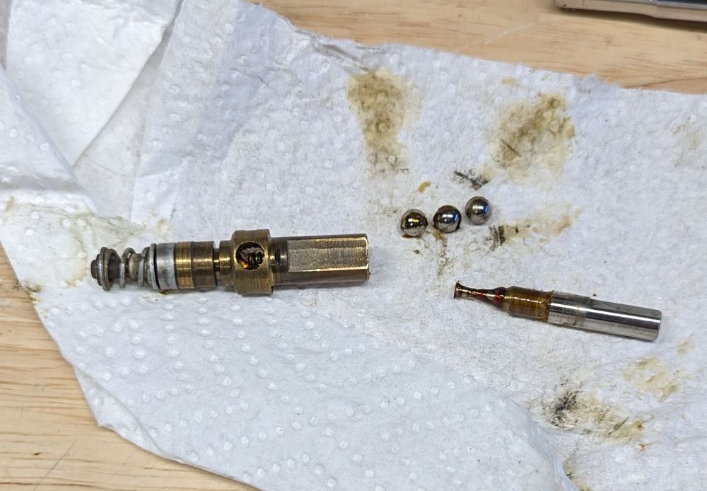

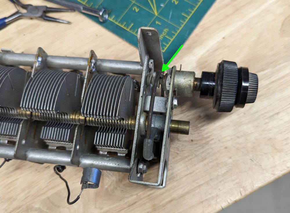

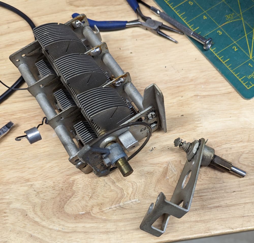

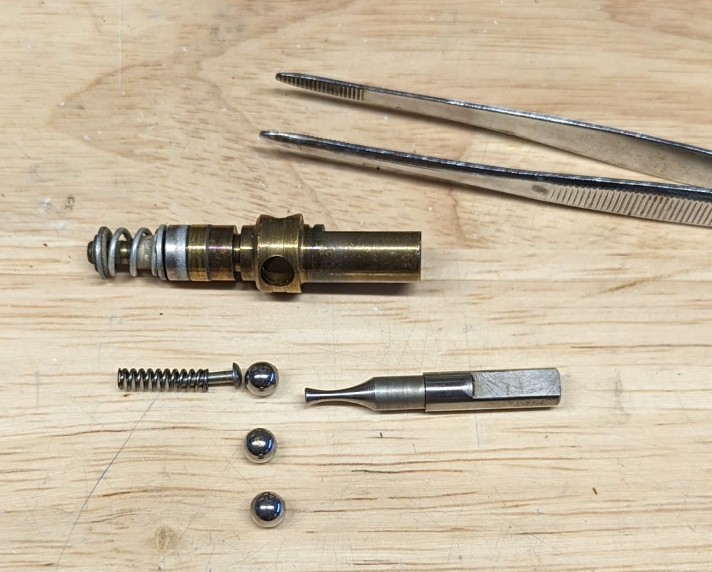

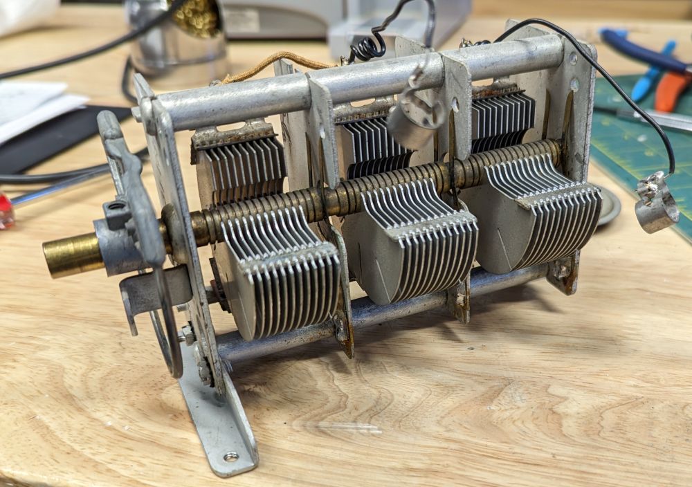

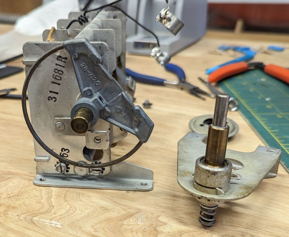

Tuner Clean & Lube!
The 655 has a friction drive from the main tuner knob to the "hoop", and a sprung-ball clutch drive thing for the fine tuning knob. Mine was pretty stiff, and the whole tuner was somewhat filthy. Parts were disassembled, cleaned, lubed and reassembled. Here's the result- smooth! Now waiting on new rubber mounts from Renovated Radios...
[Video: https://youtu.be/SdBKLcLTrZw]

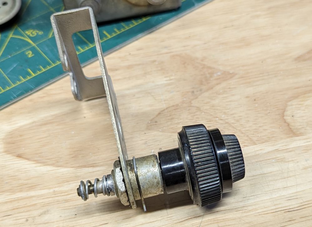

Hoop is trapped between a sprung plate and the bearing body- arrow:
Pull the shaft/bearing/bracket off:
Pull the shaft unit apart and clean the old grease out of everything. When reassembling, the balls ride on the arced part of shaft on right:
Reassembled shaft unit:
Tuner itself was cleaned with soapy water and a toothbrush. No need for dishwashers or ultrasonics:

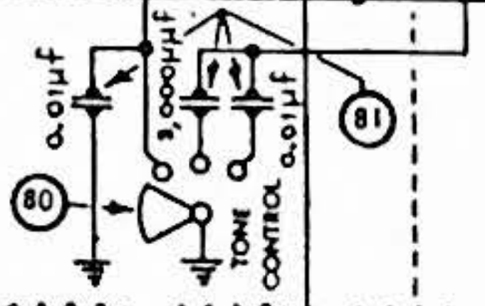

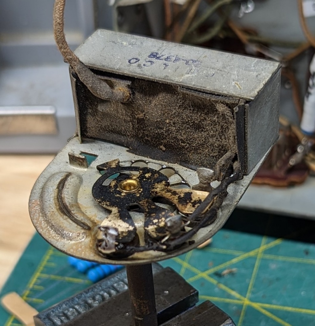

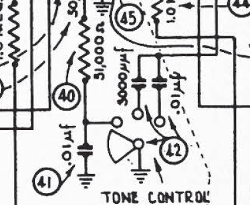

Working on a 655 tone control, 30-4378.
I have rebuilt all my Bakelites, is it the same process on this unit? Like to know before I dig in!
Am I right in assuming that it contains THREE caps? It has 3 leads into the wax from the contacts, and one coming out. The parts list says cap 41 0.01 is part of "Program Control" (tone control) 42, but there's no mention of the other 0.01 and the 3000pF caps. I think all 3 are in there, would make sense based on the leads.
And the insulation on the leads into the wax have turned to goo... guess I'm diving in there regardless.
The tone control:
Wires:
Answered my own Q. Looked at the 660 schematic with probably a very similar tone control unit... all 3 caps are clearly shown as part of the unit.
Patmat2350
Please stop creating multiple threads on the same subject radio. This is a violation of Phorum rules.
Read the following thread.
https://philcoradio.com/phorum/showthread.php?tid=4586
Thank you.
Many apologies- I saw it as a separate discussion topic (Philco tone controls), rather than something specific to THIS one radio.
I'll keep it all in one box now.
I looked at the complete 655 service bulletin.
https://philcoradio.com/library/download...%20235.pdf
It shows part (41) separate from part (42) which is the tone control with two capacitors.
However
Looking at the parts list, this states that part (41) is indeed part of (42).
So, yes, part (42) does indeed contain three capacitors - two .01 uF and one .003 uF (3000 pF, or as morzh likes to say, 3 nF).
Icon_smile
Remember, always study the service information of the radio in question so you do not make any mistakes. Of course, this does not count the times where Philco included errors in their service info...but isn't that what makes this sort of thing, ah, fun or something? Icon_crazy
