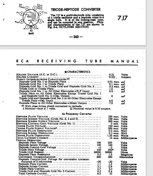

The following link is from the Philco Library on this Phorum and shows the version with the 7J7 Pentagrid Convertor.  Triode-Heptode First Detector.  (Edited 01/14/2025 for Correction to description of the 7J7)   I must apologize that in this post, I described the 7J7 as a pentagrid convertor based on my interpretation of the schematic in the Philco library.  After consulting the RCA Receiving Tube Manual, I note that the 7J7 is a triode-heptode (a heptode being a tube with a cathode, plate and 5 grids) tube, similar in function to the 6J8 other than the base design and pinouts.  The 6K8, a triode-hexode (a hexode being a tube with a cathode, plate and 4 grids) while different in design does the same function.   The difference between the triode-hexode or triode-heptode and the Pentagrid or autodyne detectors is that the triode-heptode or triode-hexode provides a "separate electron path" (sharing only the cathode) for the oscillator and mixer with the advantages of having both "tubes" in the same envelope.  The Pentagrid Convertor (Heptode) uses a "grid - plate" as the oscillator plate, but the "electron paths" of the oscillator and mixer are the same, passing through all grids.

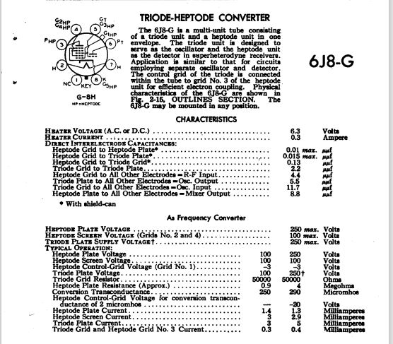

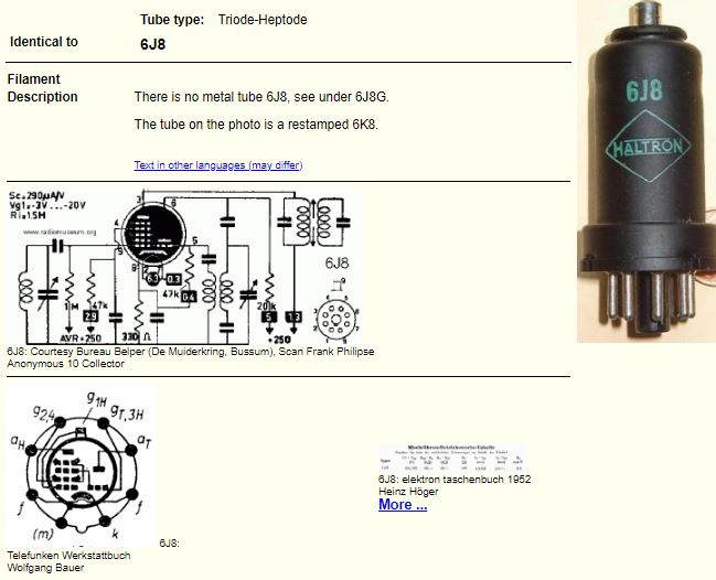

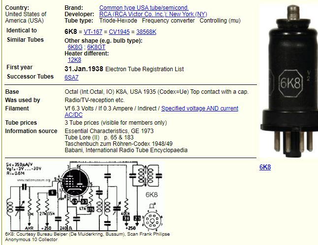

The same document states that there are certain runs with a 6J8 Octal tube replacing the 7J7.  Per the Radiomuseum website, The 6J8 is supposedly a Russian version of a 6K7 remote cutoff pentode, hardly the tube one would want to use as a convertor.  However, Radiomuseum also lists a 6J8 Triode Heptode, where the triode is used as an oscillator and the heptode section is used as a mixer.  This triode oscillator / heptode mixer configuration usually works better at high frequencies than the typical pentagrid convertor.  Remember, that in the late 1930s to 1960s or later, shortwave was to many people what the internet is today.  Shortwave was the window to news (true or propaganda) of the developing conflicts that culminated in WWII, and for many immigrants, news of the land that they left. (Edited 01/14/2025- The fact that the 7J7 and 6J8 are both triode-heptodes with similar construction and function other than basing, and the fact that Philco does not give tube pinouts on the schematic may be the reason why a separate schematic for sets using the 6J8 was not published.
The next issue is that your radio has a 6K8, which is a triode hexode, not a triode heptode.  These are not the same tube.  Is the tube location sticker still in your radio?  Does it state 7J7, 6J8 or 6K8?
To further complicate things, there is no insert in the Philco Service Document for your radio showing the 6J8 circuit.
The following may help:
Attached below are 2 pages from Radiomuseum describing the 6J8 and the 6K8 and showing typical oscillator mixer circuits with tube "pinouts":

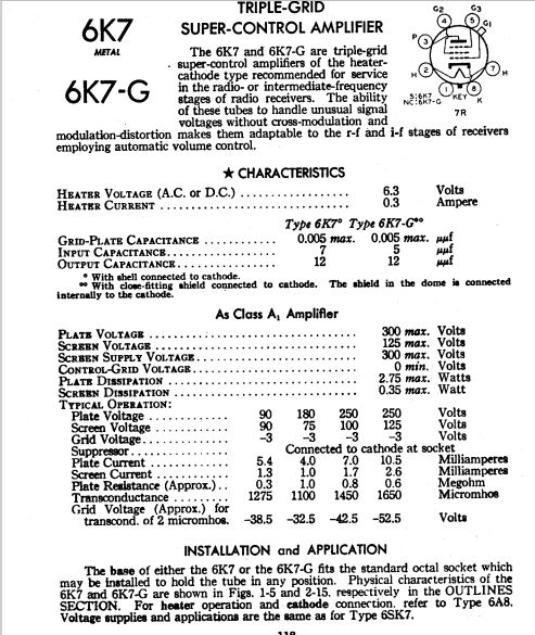

I also must apologize that in my previous post, I described the 7J7 as a pentagrid convertor based on my interpretation of the schematic in the Philco library.  After consulting the RCA Receiving Tube Manual, I note that the 7J7 is a triode-heptode (a heptode being a tube with a cathode, plate and 5 grids) tube, similar in function to the 6J8 other than the base design and pinouts.  The 6K8, a triode-hexode (a hexode being a tube with a cathode, plate and 4 grids) while different in design does the same function.   The difference between the triode-hexode or triode-heptode and the Pentagrid or autodyne detectors is that the triode-heptode or triode-hexode provides a "separate electron path" (sharing only the cathode) for the oscillator and mixer with the advantages of having both "tubes" in the same envelope.  The Pentagrid Convertor (Heptode) uses a "grid - plate" as the oscillator plate, but the "electron paths" of the oscillator and mixer are the same, passing through all grids.
Does the radio even work with the 6K7 as the convertor (the stage that converts whatever the chosen frequency to the IF frequency)?  The 6K7 is a "remote cutoff" pentode, used for RF and IF amplifiers, and is rarely used as a convertor (sometimes referred to as the 1st detector or oscillator mixer).  The 6K7 may be used as a mixer when there is a separate oscillator tube, as used in the first generation of superheterodyne radios.  The "sharp cutoff" 6J7 was used by Philco on 37-84 "entry level" superheterodyne as an "autodyne" oscillator-mixer 1st detector.  This "Autodyne" detector is generally unstable and is not used at high shortwave frequencies. Ever since the introduction of the 2A7, the first "pentagrid" (heptode) convertor tube designed specifically as a combined oscillator-mixer.  The heptode (pentagrid convertor) was the most popular form of convertor (Oscillator - Mixer or 1st Detector) used in superheterodyne radios.  Other popular Pentagrid Convertors include the 6A7, 6A8, 6SA7, 6BE6 and their 12V equivalents.

In the previous post, I posted the circuit diagram of the radio, and the tube pinouts for the 6J8 and 6K8 tubes.  Below, I provide the pinouts and description of the 6J7, 6K7, 7G7/1232, 6A8, 6J8 and 7J7 tubes from the RCA Receiving Tube Manual version RC14, ca 1940.

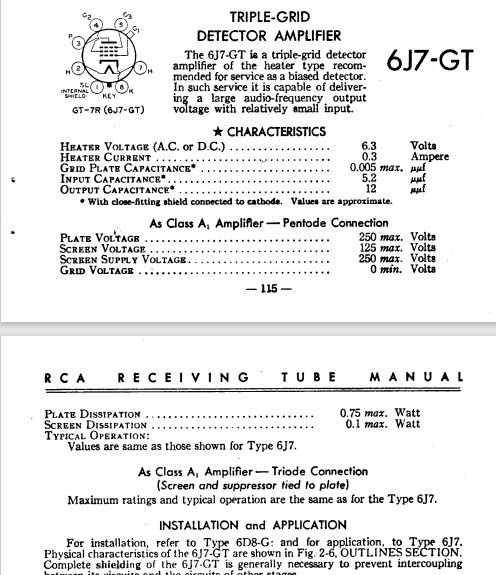

The radio indeed did come with a 6J7 instead of a 7J7, the tube socket is riveted in. Would performance increase rewiring the radio with a 7J7? Listed tubes are 1232 although it has a 7G7, 6K7, 7B7, 7A6, 7C6, 2-41's and a 84.

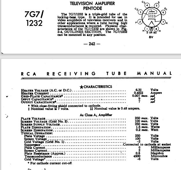

Sorry, I did not get around to posting Tube Diagrams in the previous post. The RMA Tube numbering standard is very confusing as there are numbers that sound similar but are very different.
The 7G7 and 1232 are the same tube, a high mu "sharp cutoff" pentode used as a TV video amplifier in early 1940s TVs. So the 7G7 is correct for your set, even though the tube diagram calls for a 1232 The 6J7 is also a sharp cutoff pentode. The 6K7 is a "remote cutoff" or "variable mu" pentode. The 6J7 and 6K7 have the same pinouts (Basing Diagram) but are used for different purposes. The 6K7 is usually used as an RF and IF amp in sets having AVC (Automatic Volume Control) controlling the tube. The 6J7 is used as an audio amplifier, Biased detector or "Cathodyne" 1st Detector (Oscillator / Mixer). The 6K7 is rarely used as a Cathodyne Oscillator / Mixer. The 6J8 and 7J7 are Triode / Heptode tubes used as an Oscillator / Mixer. The tubes have the same characteristics but different bases and pinouts. The RCA Emergency Tube Replacement Guide does show the 6J8 and 7J7 to be replacements for each other, however, the socket and wiring must be changed.

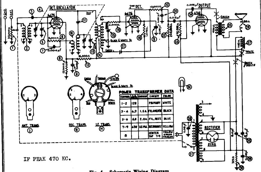

I cannot find any diagram or documentation for this model showing either a 6J7 or 6K7 being used as a 1st detector. THe only tubes documented as 1st detector for this model are either the 7J7 or 6J8.
Attached below is a diagram for the 37-84, showing a 6J7 used as a 1st detector. Look to see if there is a coil between the cathode (pin 8) of the 6K7 and a resistor with bypass capacitor, the other end of which goes to chassis ground. If so, then you do, in fact have a cathodyne 1st detector. Otherwise, this thing shouldn't be working.
