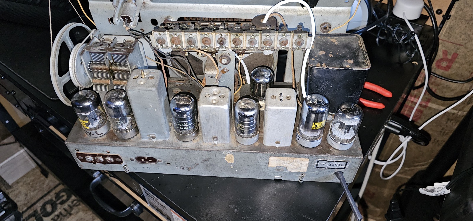

We'll guys I am at a standstill trying not to pull the band selector switch out. In the meantime, I am wondering about the tubes. I haven't done anything with the tubes and currently don't have a tube tester, and it appears my multi-meter doesn't check continuity. I am attaching a picture of the tubes and wonder if there is any way to distinguish them apart? Most of them I can't tell what number they are and one that stands out is 7C5 that based on the schematic should be 7B5. One of the XXL looks to be 7?7. I found a GE tube substitution chart that says a 7A4 can replace an XXL but "(May require components or adjustments besides those of Nos 1,2 or 3). The other adjustments include wiring change, socket change and shielding.

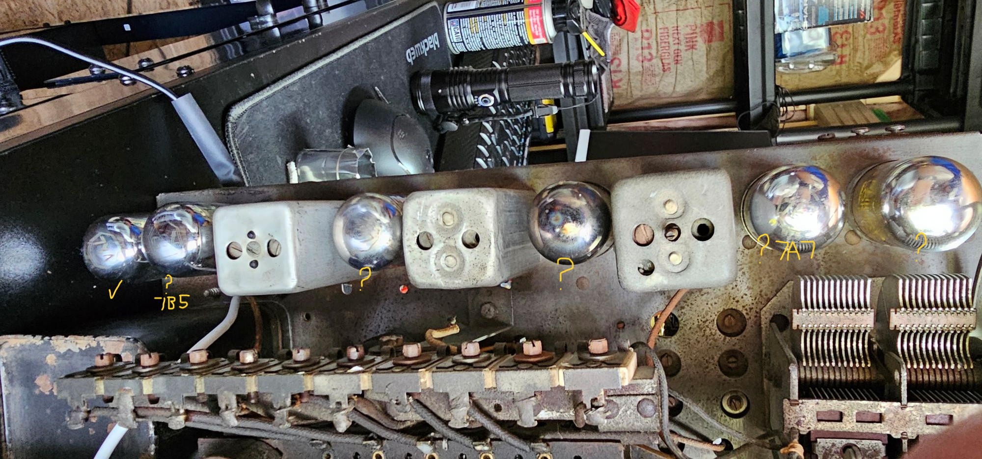

The GE chart shows a possible replacement for the 7B5 is 6K6GT/G with a socket change. 7C5 doesn't show as a sub for the 7B5.
So now I am wondering if when it was worked on prior if they were changed from original. All except the 7Y4(Delta) says Philco.
My main question is there a way to tell them apart? I am on the search for a reasonable tube tester
All the radio does now is a constant buzz/hum. Which it did the last time I changed the band selector while playing.

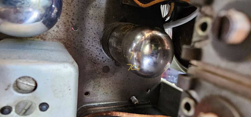

The tubes are all loctal, there's no need to change that. The trouble with local tubes is corrosion on the pins and they cannot be cleaned up with water without wiping off the label. Missing labels might show up if the glass is set in a freezer for about 4 minutes, then removed. Look carefully at an angle, usually on the top, where the tube number goes and you might see the number faintly. If you do get the number have a sharpie ready to mark the base. You may have to buy tubes to replace the unknown ones. Check with Bob Dobush at findatube.com. The symptoms you're getting may be from bad contact on the tube pins; clean the sockets with Deoxit and a brass brush on the pins.

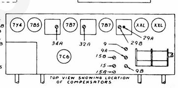

Thank you, Rod, for the information of findatube.com, I am taking a chance and ordering the tubes they were very reasonable. The freezer method didn't work and since a couple appeared to not match the schematic, I'll take the chance and replace them.

A 7C5 would work in place of a 7B5 but not exactly well. The pin diagram is the same, but the grid bias voltage and output transformer impedance would be different. the filament current of the 6C5 is only slightly higher There will be sound but possibly distorted. The 7B5 is the equivalent of a 6K6. The 7C5 is the equivalent of 6V6. You could likely use the 6C5 for now for testing purposes.

Most loctal tubes have the number etched into the glass on the top, ether inside an octagon or just the number by itself, the part that will wipe off with water is the label on the side. You can often tell what they are by looking at the elements on the inside, a, XXL, for example, is a stand alone triode, so the plate is rather small compared to something like a 7A8, a 7B5 would be in-between, and the plate would be roughly oval shaped. An Ohm meter should be able to tell you the continuity, the heater on a 7B5 is pins 1 and 8, cathode is pin 7, an XXL or 7A4 would be the same. There should be a pair of XXL/7A4 tubes next to the tuning capacitor, one is the oscillator, the other the mixer. The IF amplifier tubes are 7B7s, so those would go between the IF transformers. The first audio tube is a 7C6, and that goes in the socket closest to the front of the chassis, you can tell that apart from the XXL/7A4s by the fact it's got a rectangular box shaped structure bellow the triode plate, those are the diode sections. One issue that many of these tubes have is intermittent contact between the tube pins, and the socket contacts, so cleaning the sockets, and pins is a good idea.

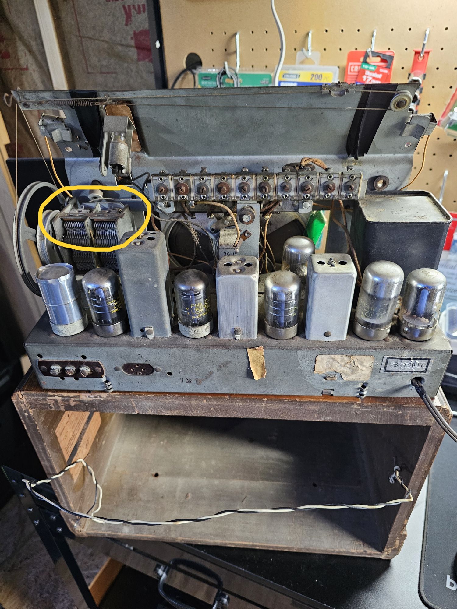

"Finally, a quick and dirty is to connect a long wire to the RF Stator of the tuning cap (make sure that your band switch is in the Broadcast, Manual Tuning (second) position."
I am still learning the Technical wording of parts of this radio, see the picture I attached and hopefully I am right in guessing it is the tuning cap? Also is one of the loops on top where I would connect the wire? Thanks

First off, apologies, I may have mixed up your case with Ken Aroyo's 52-942 However, 2 things. First, look at the 2 tubes on the leftmost side of the chassis, behind the tuning capacitor. They should both be 7A4s or XXLs. I can't tell what the first one is, as there is a shield over it. The second one is likely not an XXL. XXLs are triodes which have much smaller diameter plates than Pentodes like 7A7s or 7B7s or Pentagrid Convertors like a 7A8 in the picture, this tube looks like a 7A7.
One XXL is the local oscillator, the other one is the mixer. If you have a tube other than an XXL or 7A4 in either of these positions, all bets are off. If you put a 7A7 or 7B7 in the place of an XXL or 7A4, you won't smoke anything but it likely won't oscillate or mix. This configuration of a triode mixer and triode oscillator is rather unique in "modern" (1935 or later) sets. The other unique part is that this set has a 2 stage IF section. This is why some folks comment on how good this set is at "DXing". A pic of the tube layout is below:
The leftmost tube has a shield over it that looks homemade. For the shield to work, it has to be electrically connected to the metal base shell. Yours looks rather corroded. Clean the corrosion off with fine sandpaper unless you think that it is oxidized cadmium (Cadmium is quite toxic). The "LokTail" connects to a contact in the socket that is almost always grounded. You can also clean the tops of the tubes; the printing used for the tube type is quite stable. It's the printing on the side (the brand name) that tends to come off, even with water. I hold the tubes upside down when washing the top of the tube if I don't want to get the sides wet.

Secondly, yes, touching a long wire to the terminal of the Mixer section of the tuning cap should allow you to tune a station if the oscillator is working. This is the part I meant for Ken's troubleshooting his set, but it could work for you. There are 2 sections to the tuning cap, the mixer / RF and the Oscillator. Usually, the oscillator section is the one closer to the shaft. touch a 25 foot or longer wire to the Mixer section of the cap. Ig you can now receive a signal, then troubleshoot the antenna section of the set. There are antenna coils and the "B" section of the band switch. The "A" Section controls the oscillator.
