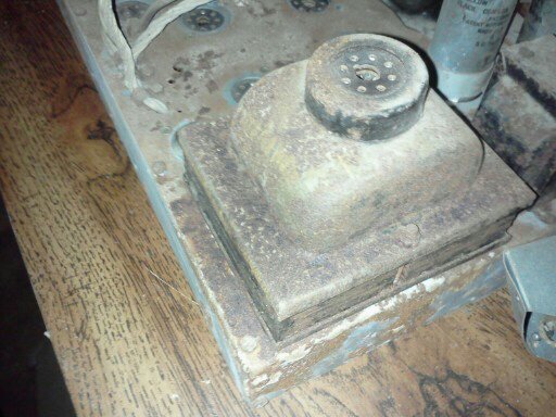

Just remember, do not disturb the single bakelite block in the upper chassis, part (97). That does not - repeat, does not - contain any capacitors. Instead, it contains the coils for the 10 kc audio filter! Leave it alone.

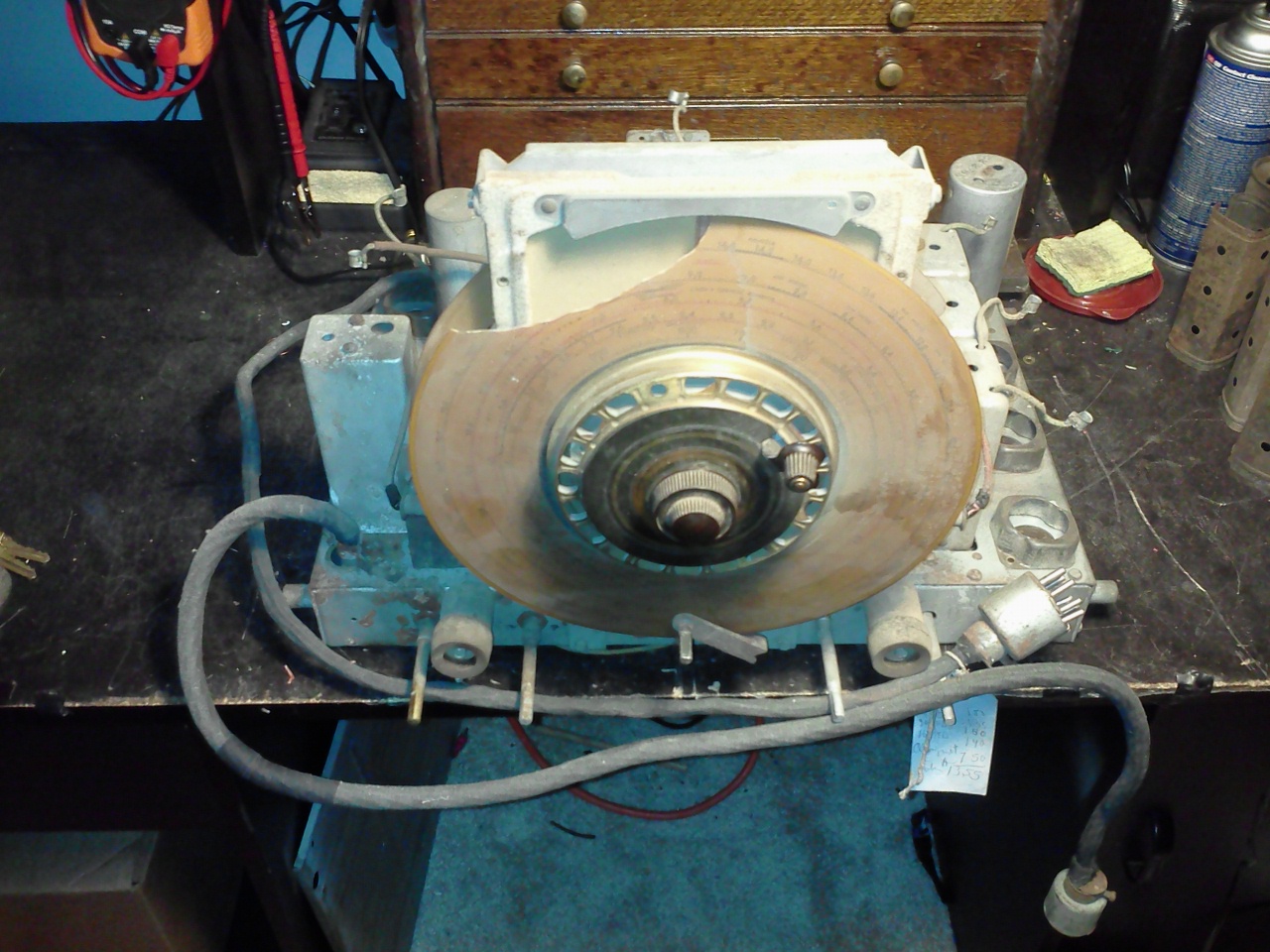

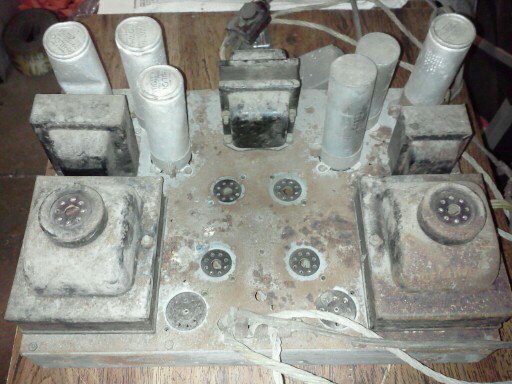

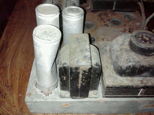

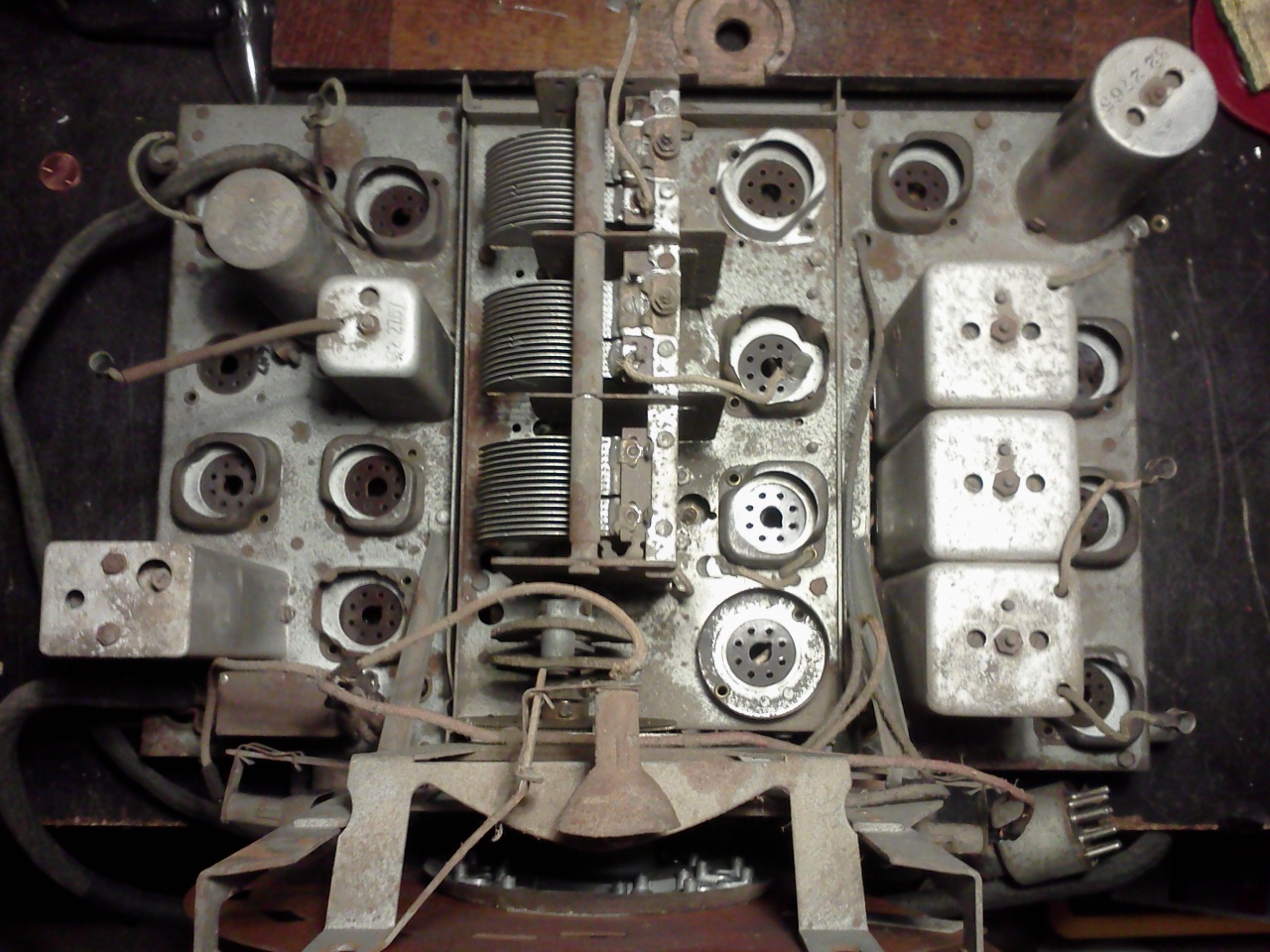

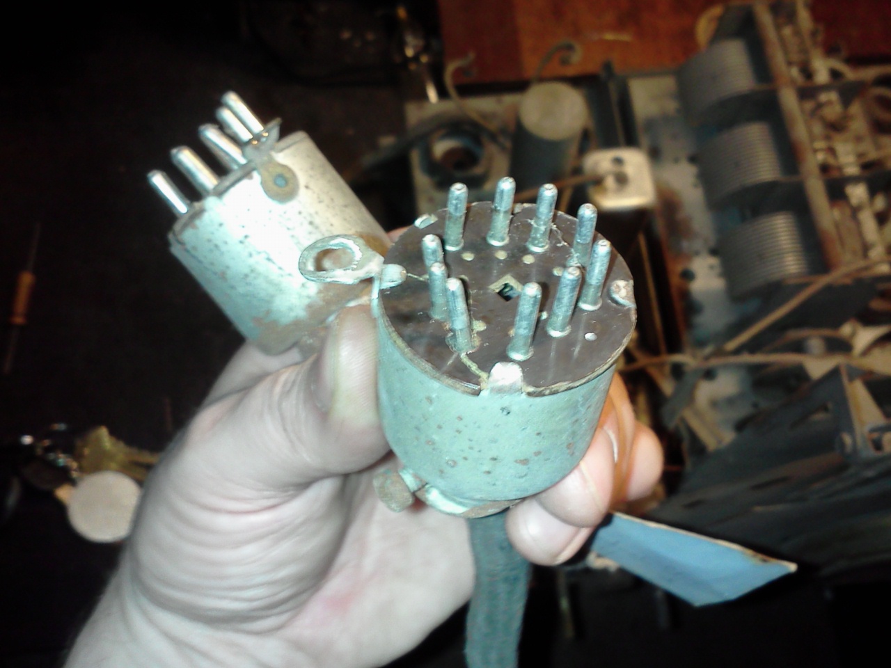

Here are some pics of the tuner chassis. If they come out properly. As you can see I have my work cut out for me.

BWC, looks like someone tried to "reform" one of those electrolytics.  Due to holiday, your caps will mail out today. Those sockets don't look too bad. I would carefully realign the bent pins and hit the fiber board with crazy glue. If you want to go nuts, mix up a little epoxy and fill in where part of the board is missing.

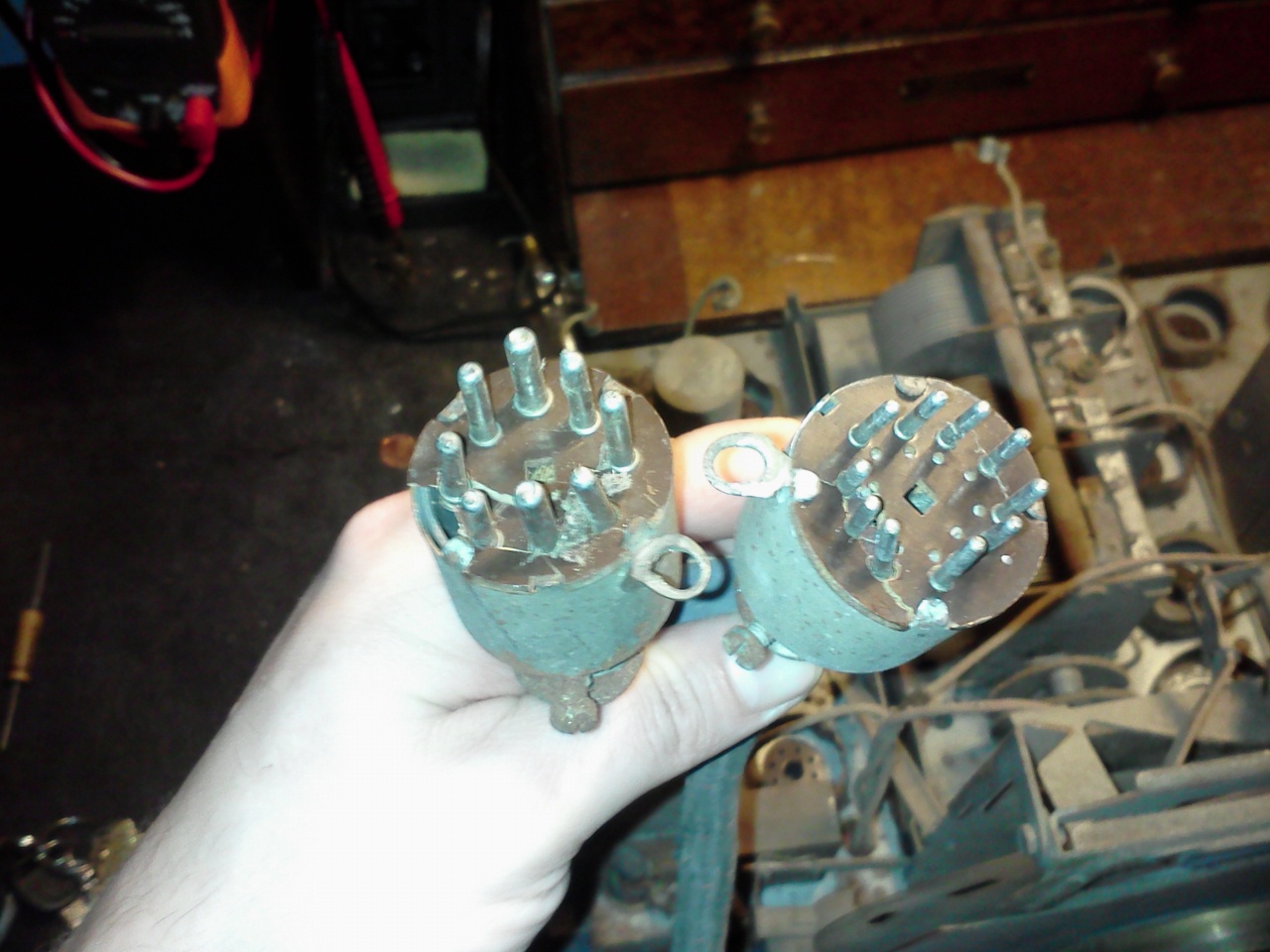

Preserve as best your "umbilical" plugs and sockets. Wire can be replaced, but plugs and sockets, that's another story. Agree replace, restuff, whatever all the elecrolytics and paper caps at a bare minimum before even thinking about bringing set up ever so slowly with variac.

Quote: Is there any chance of obtaining replacement umbilical plugs? Somebody (not me) broke these. Probably prying them out of their sockets with a screwdriver.
There may be source for similar plugs elsewhere but I wouldn't count on finding them as they were likely proprietory to the Philco 690s and maybe only the 38-690s. Most of the two chassis sets I have seen use a 7 pin plugs and sockets to tie the cable to the chassis. I would take the plug apart and try gluing and filling the wafer back together with two part epoxy, preferably high heat epoxy without metal fill in it (do not use metal filled JB Weld) you may have to clean the phenolic material up good before you do. If it's really bad you may have to make a duplicate of the original wafer and replace it altogether.

I found some suitable material to reinforce the existing wafers. That "reformed" lytic has been straightened and restuffed. I managed to clean up the mangled shield bases and they will now accept shields correctly. Now all I have to do is locate two shields
