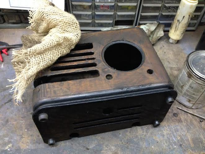

Well,
I mustered up the strength to get back into this Halson today. Well, yesterday but whatever. I rebuilt the cabinet, glued and clamped her and today I began stripping and then... YES! I am grain filling the cabinet like I should have. Took 2 coats of grain filler and still might need another coat.
#71
U rock dude!
(I take it you also had to buy a sack of potatoes to get some burlap) Icon_lol
With your speed I think we will see the finished box by tomorrow.

#75
Ok I grain filled this sucker good and have put on the medium brown toner instead of dark walnut, I just have to do the top and bottom and the dial surround, Clear her and she will be re-rebuilt
