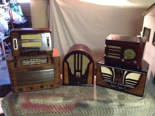

It and my 45 fell off the table while i was taking pictures of all the finished radios. I left the room without looking. Maybe tomorrow.
Here is it before it fell (5 minutes after I reassembled it and put the grill cloth in.)
But here it is all finished, Icon_lolIcon_lolIcon_lol
