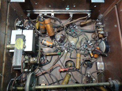

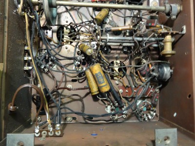

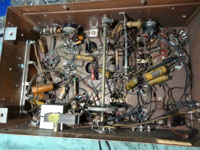

Ron,
Here are some shots of the underside of my chassis as found. I only have one shot from after I did a complete rewire (82 MB ZIP file):
https://drive.google.com/file/d/0B-05OmK...sp=sharing
- Geoff

Many thanks to Geoff, thirtiesradio, and Sam for the photos - those do help a lot!  Merry Christmas!
