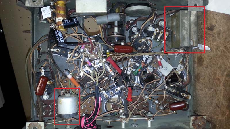

I have started to restore a Model 19 Code 126 Cathedral that I picked up at a thrift store over a year ago. The electronics are really not in bad shape.
I have been spending a lot of time just tracing wiring and trying to understand where the parts are. I have replaced a couple of the bakelite condenser blocks and trying to move onto the others. I am not choosing to restuff, rather replacing each using a small terminal strip with the capacitors soldered in. The space that it opens opens was is just too tempting. It seems so much easier to trace the wiring.
BTW, in the picture, those maroon mylar caps are not mine. It seems the previous owner tried experiementing by jumping several of the bakelite blocks with those capacitors. I don't know what they strategy was there, but I will be removing those.

Hi Mark & Welcome!!!
Well let me see the round thingy is the inductor for IF the wave trap. The square thingy is a can with bypass condensers usually 3 or 4 inside. The autodyne circuit was used because the pentagrid tube wasn't designed yet. Remember this 1931-32. It was also cheaper as it only use 1 tube instead of 2 (separate mixer/osc tubes).

Can't answer your 77 tube question but can tell you the bakelite block caps are not all that hard to stuff. Here's a thread showing how. The bypass cap can looks similar to one in a 60MB I'm working on. I was able to bend the metal tabs on one end, slide out the caps which were in a tar block but had a piece of fish paper around it so it just slid out. Then stuffed new caps in the can and closed it up. Don't know if the one in the 19 is the same though.
