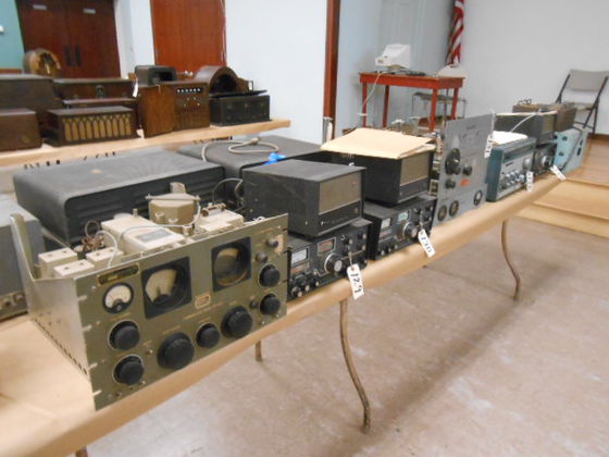

Here's a pic of the back corner of the HRO at the auction. It's at the end of the table, that yucky green thing with the coils on top. If you look closely on the side there are two holes. On the bottom is a square hole and topside is a round one about 1 1/4" around. That is one of the ones that got repaired (filled in) as it is not suppose to be there. The square hole is where the ant & gnd connections connect.
