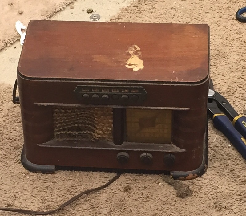

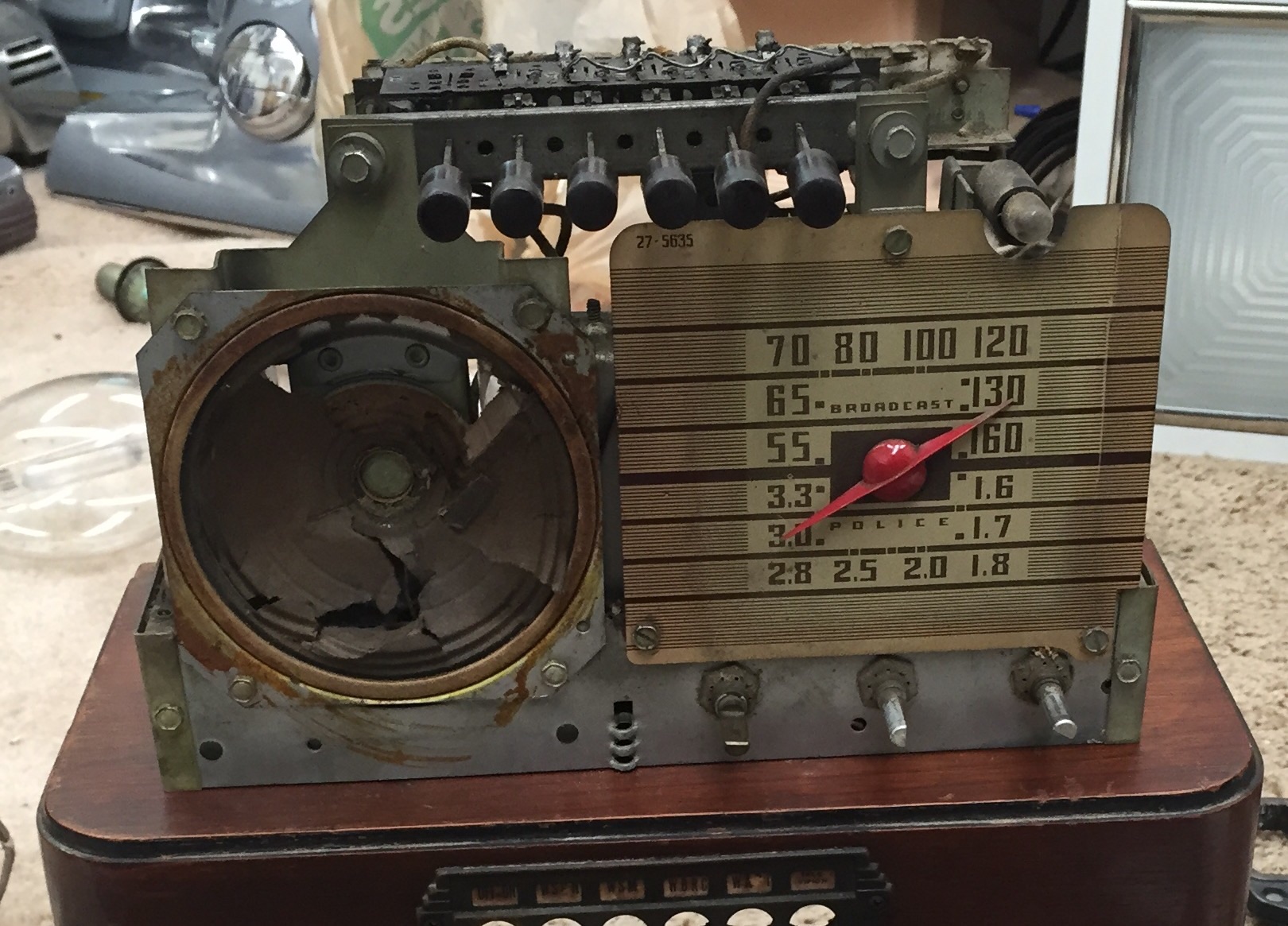

I picked this Philco 41-225 up at the AHRS today for $10. It's going to need a little work, a new cord and such. The speaker's caved in, but the veener is very nice. A little GOJO and I'm sure it will clean up nicely. I blasted all the dust out of it with some canned air.

This thing's speaker is toast. Does anyone know the power and resistance for it and where I can get a new one? How much does reconing cost?

Well the original FC is 500 ohms which is pretty low. I suspect that's done so there isn't much voltage drop across it. What most later AC/DC set use is a 1000 to 1500 ohm resistor @ 5W. When don't have the FC in the circuit you will need to up the value of the filter caps. The FC provides some filtering the resistor not so much. So replace those with 47mfd @160v. This will give you a nice clean power supply.
As for the recone I'd guess about $45.

The current electrolytics are a Cornell Dublier dual cap at 30 and 50 mfd and 150 volts.

The CD cap is replacement. Original was a dual 20mfd 150v.
