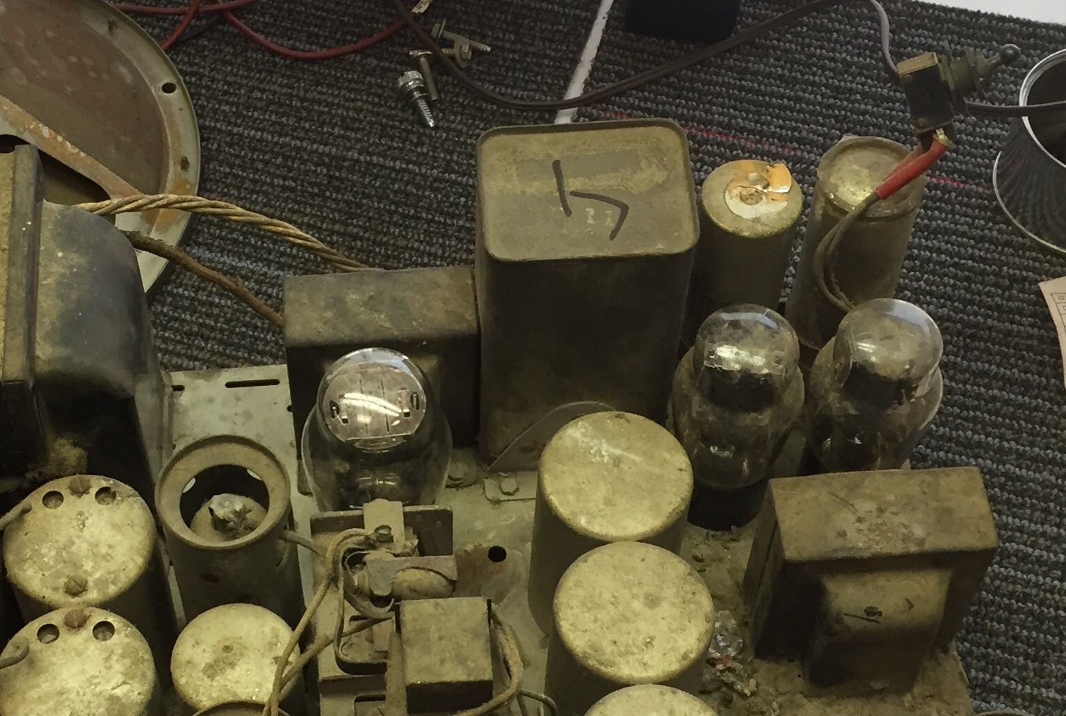

As found, this radio had a 5Z3 Rectifier, but the schematic says it's supposed to have an 80. I've also heard that some other versions of this chassis have a 5Z3. Which tube should I use?

Hi Dave
Double check the code # on the chassis tag to be sure you have the proper schematic. It will read code 121 or 122 ect... Either will work but the 5Z3 is rated at higher output current. And it consumes more filament current (3amps/ the 80 is 2amps). Generally the 80 or 5Y3 is used on sets with smaller audio output stages, the bigger sets and consoles w/ larger output tubes used the 5Z3 or 5U4.
The schematic on the inside of the cabinet says to use an 80 tube.
Slave to an RCA Victor CTC-25
What is the big rectangular can next to the cylindrical philter cans? Other 16B's I've seen do not have this.
(05-11-2015, 08:18 PM)TheUniversalDave1 Wrote:  What is the big rectangular can next to the cylindrical philter cans? Other 16B's I've seen do not have this.
It looks like a capacitor to me.
