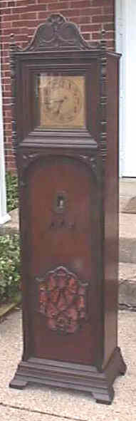

Looking for some help in identifying a tall case clock ( I believe a Sessions clock) and a Philco radio combined.
It's obviously from the 30's. But who made it? When? and exactly which chassis is in it? are questions I'd like to answer before approaching the current owner with an offer.
It was suggested to me that third parties made these?
Could this have been a generic case, I noticed what looks like a cap (& hole) to close holes near the dial?
Also below the dial looks like maybe it was filled?
Thanks for any help identifying this.

Well for starters it's not a Philco cabinet or clock. Don't know if it was an after market cabinet or it was a clock / radio from a different manufacturer. Would take a guess and and say in was make somewhere around 1928-33. Didn't see many after that. The Philco chassis is  from 1937 and looks like a 37-610. To me not worth much at all.

that's not right radio for that
some one defiantly put that in. that's why you have other holes in it
unless you really like it and can fix it
250. is too high if had original radio maybe
sam
That's a 1930-31 vintage cabinet and a 1937 Philco chassis (as said, probably a 37-610 chassis).  Don't waste your money on this creation; real Philco tall clocks aren't that rare nor expensive ($150-200 for a nice one).

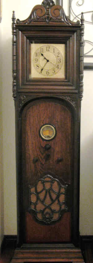

Honestly, what attracted me to this was the idea of the clock radio, and this cabinet
Since then I've done a lot of research and found there were many makes and models of these.
Surprised me since i had never seen a single one before.
This one seems to have started life as a Sessions clock with a Zenith radio.
Factory made? there is no record of it.  I have found another example of this model along with others that ALL
share the same radio (Zenith_Zenette)
After talking with the owner, and the thought that this might be just stripped and thrown out, I offered about 1/3 of what he was asking and he accepted.
BTW Ron is right, it is a 37-611 (with a variation from the schematics I've found)
Initially I will fix the cabinet and restore the 37-611...hopefully.
I'm trying to find the original chassis and possibly put it back to the way I believe it started out.
Though since no one seems to believe that it was made by the factory I'm not sure if I shouldn't just clean it up
and keep the philco with it. The Zenith has an RF stage so it most likely would be a more sensitive radio but the
Philco has 3 bands.
The photo attached is a unmolested version
In the short term I need to find a speaker for the Philco, right now it's connected to a AK speaker in poor condition.
Output transformer 200ohm primary (4000ohm imp)
I have ordered all the caps and some out of tolerance resistors I noticed.
As I mentioned above the chassis varies from the Philco factory 37-611 schematic.
In center of the chassis there is an additional bakelite cap not shown on the chassis layout or in the parts listing
Along with a few other components not listed. I looked for any updates but could not find any for this circuit change.

The 1937 chassis has been restored, along with the cabinet including carving replacement sections of the speaker grill.
I could not find the 31-32 Zenith Zenette to put it back to where I feel it started life.
Given the value of these (clock radios) and it's undocumented past, I decided to just go ahead and set it up for the 1937 Philco since that is what was installed in it way back when anyway. The extra holes have been removed.
Here it is:

looks great nice work Icon_clap Icon_clap Icon_clap Icon_thumbup
I love this set, great work ! Not sure the DNA really matters all that much. Always room for one of these in just about any home; don't have one myself yet.
