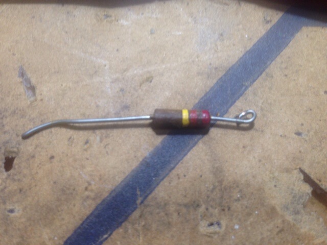

i am snowed in today so I am re-capping a Tradio for my uncle. I have a resistor with a brown body, yellow stripe, red stripe , red stripe. I only have the list for body, end , dot.
Where can I get the one for these and what is its value?
Thanks guys
Kirk

Looks like 220K. red-red-yellow= 22x10,000 = 220,000 Ohm = 220K.
measure it first, see if it is in the vicinity.

Thanks, I now have grey, red, brown with a 10% tolerance. That is 8200 ohms?

820 Ω.
You may want to download this link. It has a lot of good information. Resistor codes are on Page 73.
