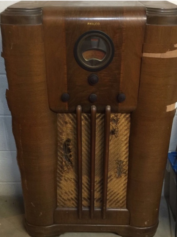

Philco 38-5 veneer issues, what is this wood?

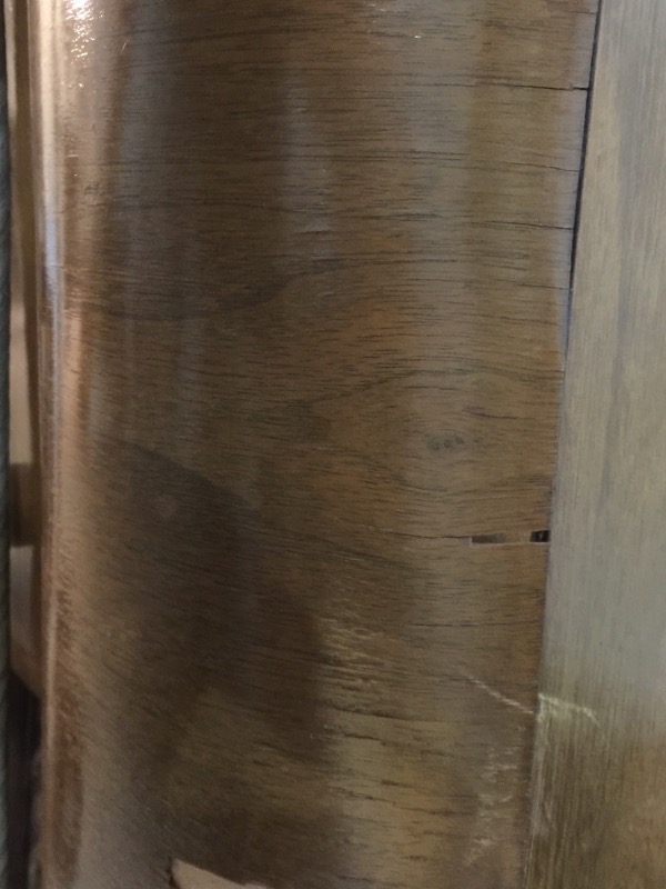

First the good news.  I only paid $20 for this radio.  Electrically it appears untouched.  The veneer is all there and the finish is good.  The cabinet appears solid.  Now the bad news... the veneer is peeling rather badly on both vertical side pillars.  How do I get it clamped down and re glued?

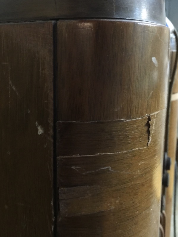

As I look this cabinet over, it appears that it was largely assembled with screws and glue. Is that correct? I am considering trying to disassemble the cabinet to deal with the veneer issues. Am I insane? Your input is gratefully requested. If I do so, I think I can reglue the veneer to the side columns. Has anyone ever tried anything like this? That seems to be the only way I can get a good fit and a good glue job on the veneer.

 I don't know how rare model 38-5s are but it may be worth holding out for another cabinet. You could disassemble the cabinet to repair it, sometimes it is necessary to do that, but it is a long process so it's best to make lots of notes and or take lots of pictures whilst you are dismantling it. I would not even suggest doing this unless it's a rare or valuable model.   There is one potential problem that I can see, one of the missing pieces of veneer is broken across the grain on the curved pilaster (side column), on a flat piece like a cabinet side this isn't a big deal but on a curve the veneer is under tension so the two ends might pop up again even after they are glued down, plus the crack will always show. In cases like this it may be easier just to make a parallel joint along the grain and replace that section of the veneer with a longer strip.

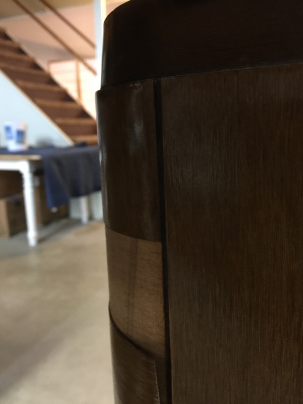

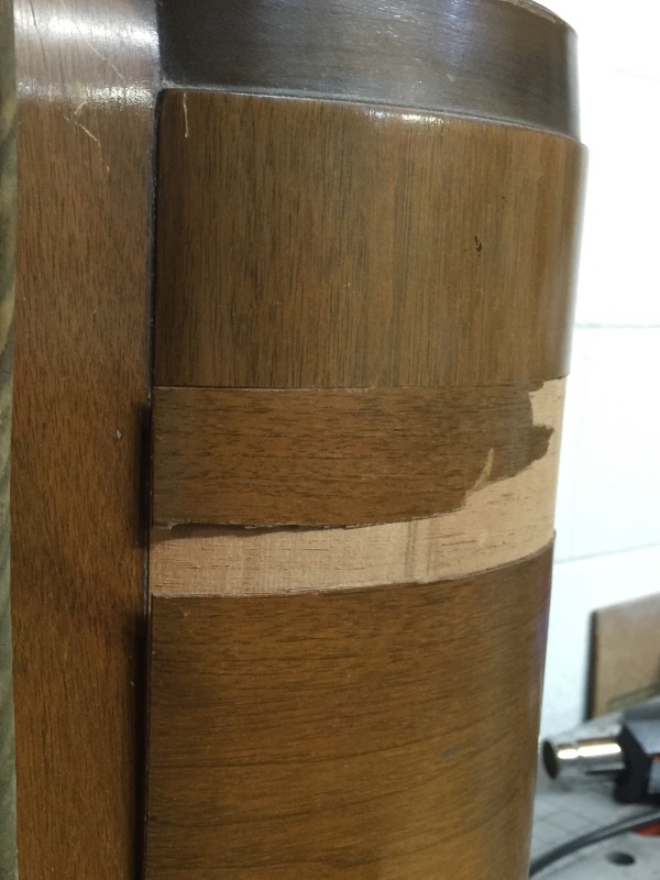

Any idea why Mr. Hagman no longer recommends this technique? This technique is on my short list of possible options. I have gone as far as getting a cheap iron from Goodwill. The big concern is in getting the edge to stick down where it is on a inside corner (such as the inside edge of the pilaster where it meets the front panel up higher). That is why I am considering disassembling the cabinet.
My second closeup is one such example.
Having pulled the speaker mount board, I think that disassembly is not going to be required. I can access most of the edges that concerned me. The worst part is that on the left hand side, some of the veneer is almost shredded by the cracks along the grain. I will try to see what I can do with it. I have wet the veneer down with a spray bottle to increase its flexibility and I also think I will tie it all together with masking tape. What have I got to lose?

 Bob Andersen uses a modified version of this, he applies watered down PVA glue to the veneer and whatever you are gluing it to, then lets them dry first. He then uses a heat gun to heat the bottom of the veneer and what you are gluing it to, and presses them together starting on one end and working his way to the other end. I have not tried it with a heat gun but did with an iron, the problem is that you must apply the iron on top of the veneer to heat the glue, which can dry out the veneer, and make it shrink and split across the grain, which it did with me. Another option is to use contact cement, which works the same way but without the heat, unfortunately you can't easily reposition it once it is down, which you can do with the PVA glue by heating it up again.
  This only applies to gluing the veneer down, if it joints in the cabinet are all shaky and loose you may have to dismantle it to repair it.
i am now seriously considering either finding a cabinet from a donor or else using peel-and-stick veneer.  If I go with veneer, does anyone know what the wood is on the pilasters?  I have heard either mahogany or else walnut, from so called experts at the fine woodworking shops.
