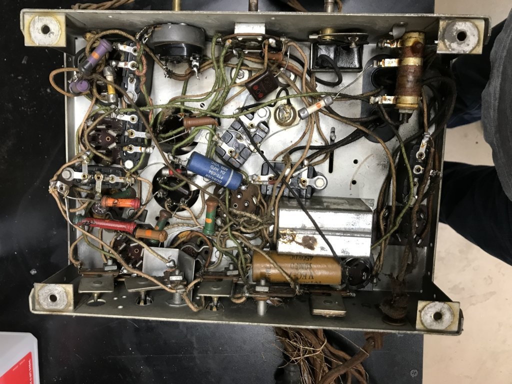

Thanks for your response and information sir. So I removed the chassis from the cabinet and began checking it out. The obvious things I saw was a tear and hole in the speaker, not a big deal if the coils ohm out, and the missing electrolytic condenser. Someone has obviously been in this and made some changes. The condenser was replaced with two, one on the top and one underneath. Both old repairs based on the cap appearances. I also found a bare wire where the schematic calls out a flexible wire-wound 200 ohm resistor.
 The big wire-wound resistor tests good, and only four of the dog-bone resistors are testing bad, high. I'm going to try and replicate those and watched a u-tube video showing one way to do it. I got Steve's tools for helping to re-stuff the Bakelite condensers and plan to try and keep this looking as vintage stock as possible. I put an ad in the wanted section and hope someone will have a can I can get to re-stuff for the missing one up top.
I also see a cap and resistor that appears to have been added between the oscillator transformer and the 6A7 tube, reason unknown? This brings up a couple of questions from me:

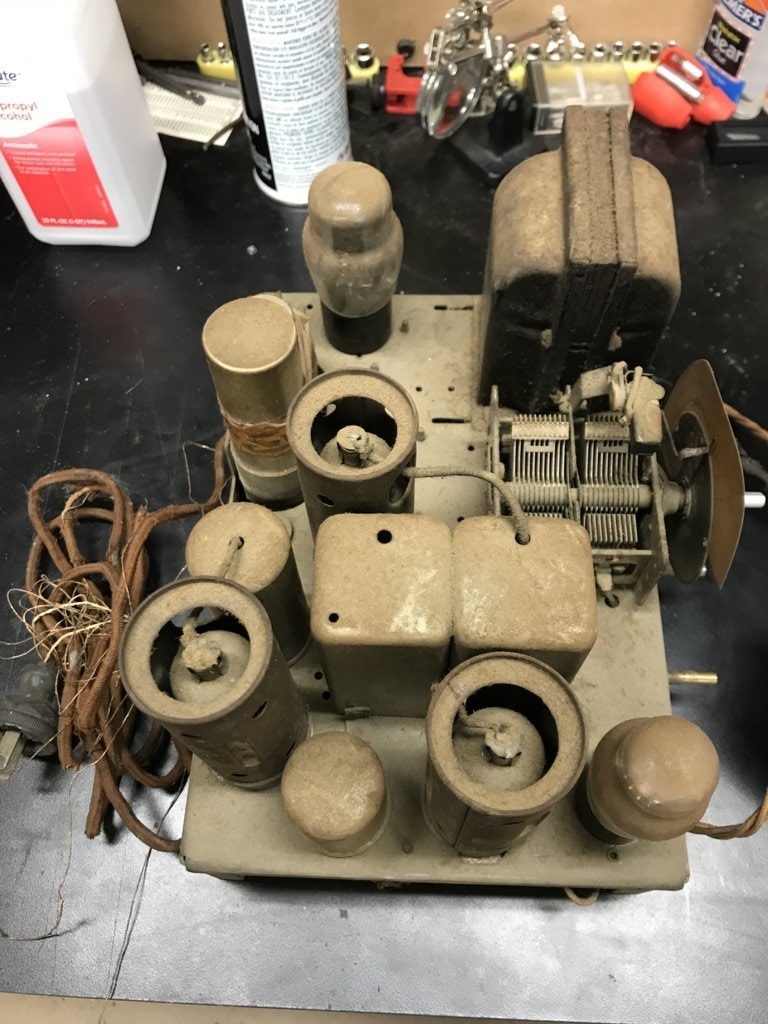

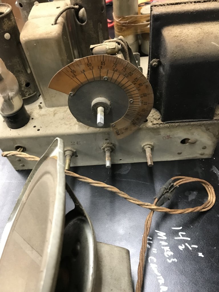

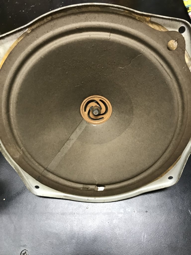

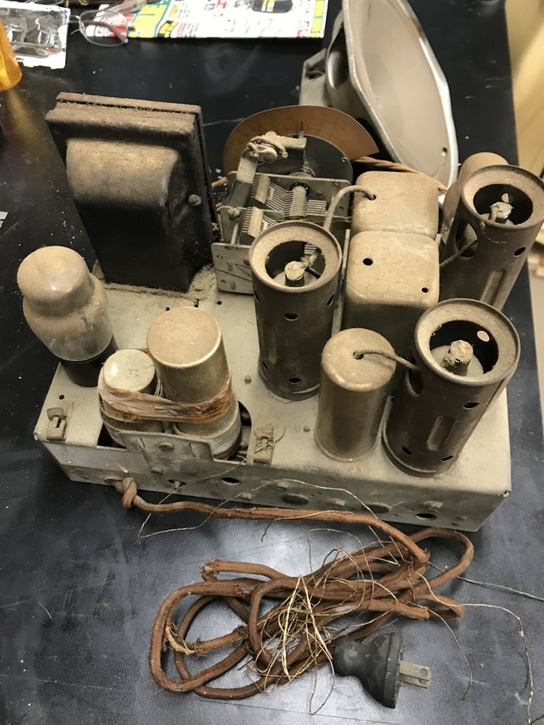

Okay, so here are some photos of what I'm working with. Obviously a good cleaning is forthcoming for the outside. The dial indicator is pretty decent, just warped, maybe a heat gun can straighten it? Also the speaker cone looks like it may not be the original with that one tab sticking out?
Gregg Icon_thumbup

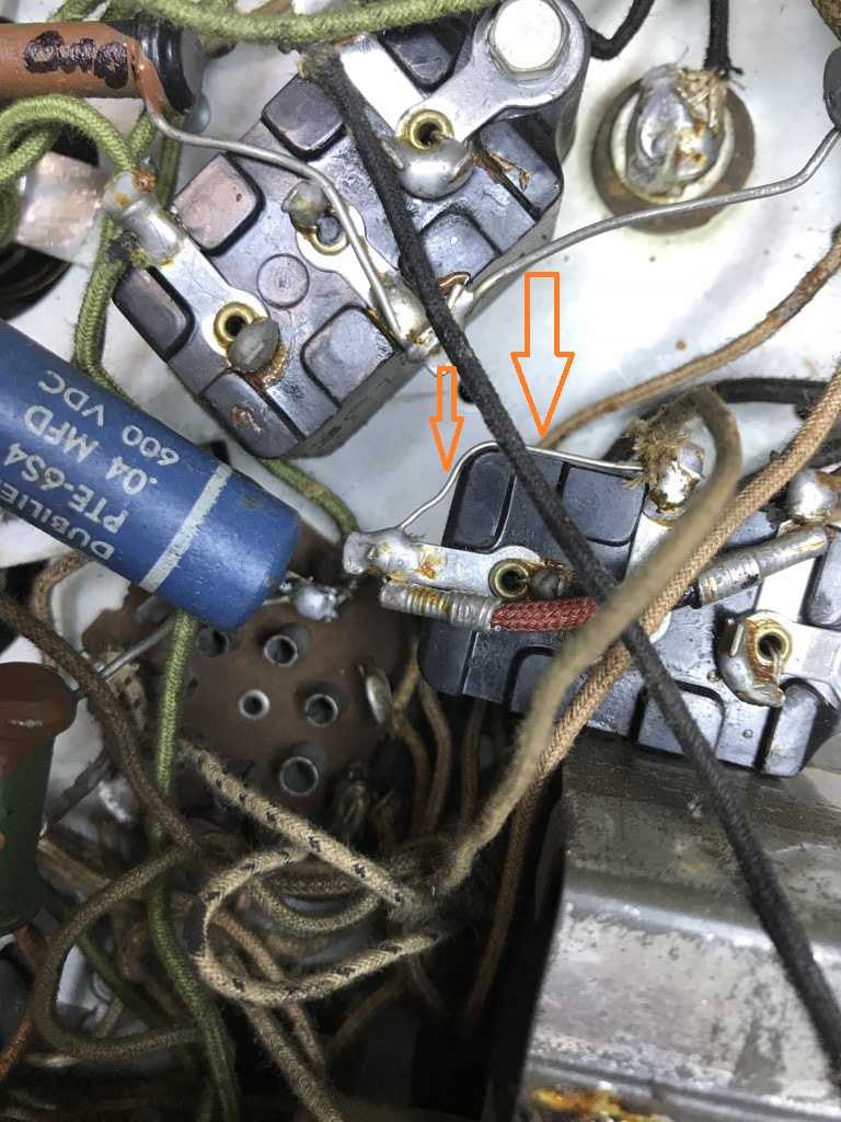

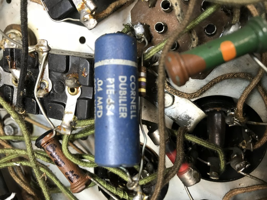

And here are a couple showing some changes someone made, beside the Electrolytic cap deal.
The wire vs. resistor on the condenser and the cap and resistor going from the Oscillator coil to the 6A7 tube (kind of a bad picture, but the solder glob going out of frame is where the cap attaches to the brown wire going down to the oscillator coil :
Gregg Icon_thumbup
Have used a heat gun but be careful keep the heat low and don't get the dial wet.
Seen a number of Philco sets w/ the tab.

<The wire vs. resistor on the condenser
No it's wired correctly. #8 has two sections that the bare wire is used to connect them in parallel. When restuffing use two .1mfd caps.

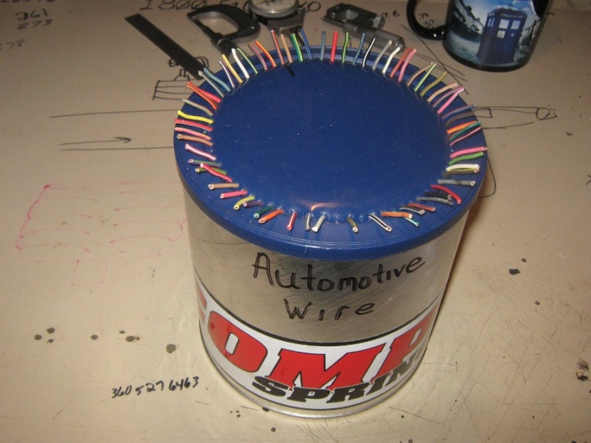

i give these away as christmas gifts ... an example of an easy storage means to lots of wire.
all the wire is spiral dropped into the can and you pull out the amount you want.  i have a much larger can i use , one person i know uses a big old cheese ball container,, you see them at the store sometimes , they are about 2ft tall with a big lid.

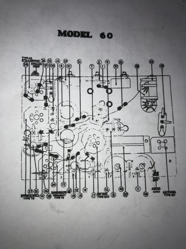

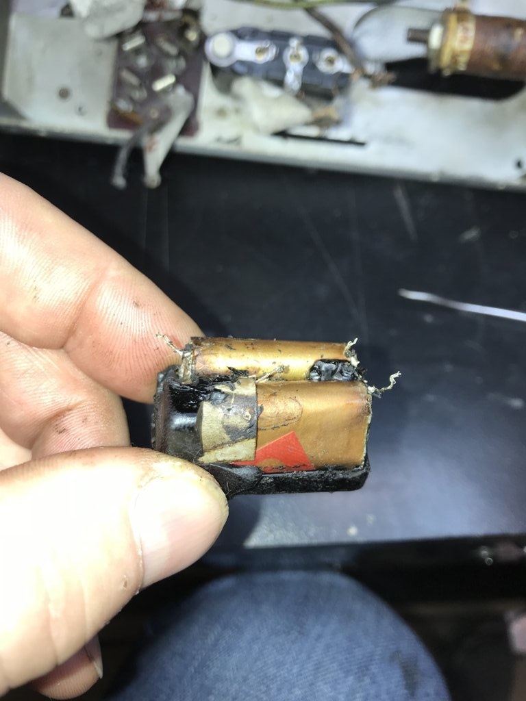

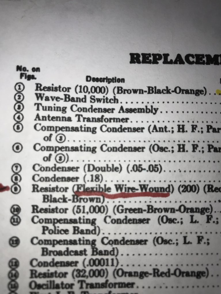

Gentlemen I have another question tonight< I was in the process of re-stuffing some of the bakelite caps. and came across something confusing, and I'm hoping someone can clear it up for me. Item # 8 on the diagram shows to be a single .18uF cap. There were four leads coming up from inside the condenser body and when I removed the insides, there are two caps in there. See the diagram and description and the photo of the caps that were inside. This is the condenser that has the wire-wound resistor on it, that also has a bare wire going from one end of the resistor back to the center terminal of the condenser. That same center terminal has a wire going back to the condenser bank. I posted a photo of that wire earlier in the post with arrows pointing to it. Anyway, what is the second cap it there and where is it on the schematic. I realize I haven't posted the schematic, but since the 60 is fairly common most of you guys I'm sure have it already. Thank you for any help!- I added the earlier pic.
Gregg Icon_thumbup
This is supposed to be a 4989-Z cap which is two 0.09uF caps, connecting the middle pin and the pin opposite the screw makes it 0.18uF.
Thanks Mortz, that definitely makes sense and is apparently what I have, but is definitely not the way it is shown on the schematic I have. I also am confused by the bare wire and the lead going into the condenser filter can. Do you have a schematic that shows this better, so I can better understand it?
