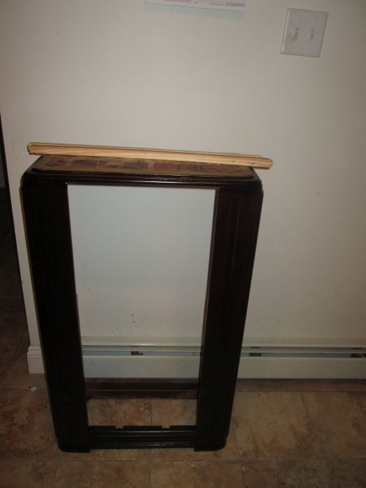

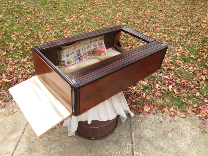

Couldn't find any reliable pictures of this set so I went with what I thought it looking like while I was removing all the old gunk that was on it. Best I could tell all the trim was dark with some highlights. Top and sides were medium walnut. Today it was ready for toning. Finished up gluing, striping, and sealing. Made the replacement grille bars but still need to tone and notch them to fit the cabinet.

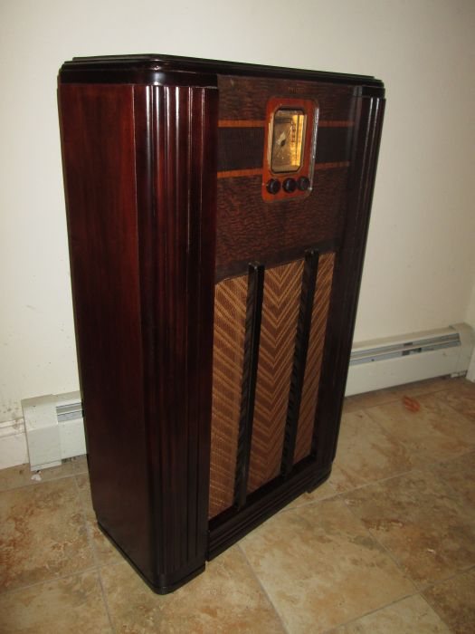

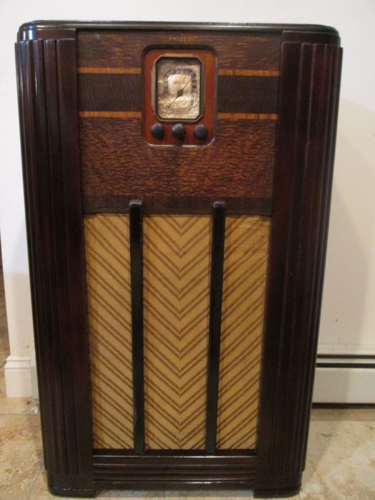

Well it's all back together for now till I find a dial for it. Cabinet is done and chassis is working both could use a couple of small tweaks. This is what it looked like 8 or so yrs ago when I got it. https://www.flickr.com/photos/53710524@N...ateposted/
It's a seldom seen set else I wouldn't have fixed it up. Want to be able to supply the gallery a pic or two so it would a real pic instead of the drawing. I've only seen one other on the net but it had a what looked to be a dealer added push button tuning assembly. There was some discussion if it was a franken set or not. The 38-17T do turn up every once in a while.
Looks good. How do you manage to refinish cabinets in cool weather?
Incidentally, I see your place has the very same radiant baseboard heat as our house has.
Looks good. Yes the dial will need replacement but ....

Thanks! Just watched the weather reports. Had a four hour window of opportunity perhaps the last till spring on Sunday. Report said 0% precipitation and partly cloudy. They lied. Just as I applied the last coat of clear it started to drizzle. Gather it up and brought it inside, no white spots so all was well a little smelly but ok.

The refinished set looks great. Good job Terry!
