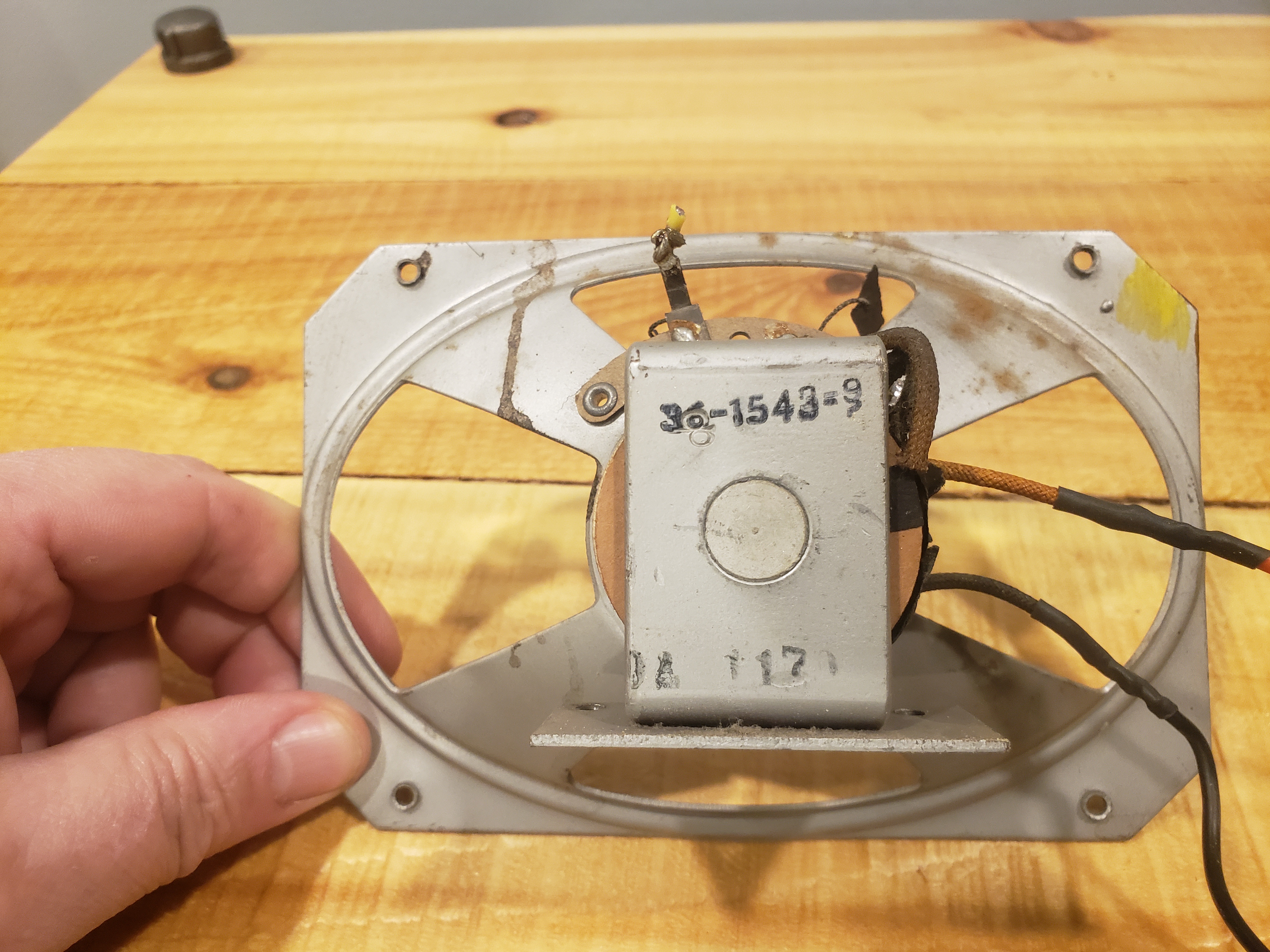

Does anyone have any suggestions for an alternative to the 36-1543-9 in this set? Field coil measure 1600 ohms. No idea how many ohms the speaker is. Voice coil and cone are toast.

Oops, OK that is the model, 42-345

Radio must be pretty compact. I have never seen one of these, but the Schematic is available on Nostalgia Air. Typical Philco, the tubes are out of a car radio, including the rectifier. This is not a bad thing. This should be a fairly nice radio. A modern 4X6 speaker would sound better than the original.
Thanks John. That's very helpful. If I were to replace it with a modern 4x6, where would I attach the leads? (I'm not super savvy with this stuff. Yet.)

Look at your old speaker. The 2 solder lugs directly on the frame of the speaker are the "voice coil" connections. The new speaker will have the same thing. Connect the wires from the "secondary" of the Audio Output Transformer" to these solder lugs. Polarity is not important because this is not stereo. There are 2 wires from the frame that go to a "winding" on the Field coil (generates the magnetic field, your new speaker will not have this). Ignore these. These are connections to the "hum bucking coil". As to the 2 long wires on your old speaker, these are for the Field Coil, and don't exist on your new speaker, but must be dealt with. The simplest thing to do, if there is room in the radio (and I bet that there is not) would be to mount the old speaker, or at least the field assembly (after you cut it away from the frame of the old speaker) somewhere inside the radio. For example, if the cabinet is big, mount the entire speaker frame either behind the replacement speaker or ion the underside of the radio. If there is no room for the frame, mount the field coil somewhere on the chassis, near the power supply area and away from the tuner. Consideration must be given to electrical and heat safety issues. If there is no room for the field coil, it can be replaced with a 1600 (1.6K) Ohm 5 watt (or better yet, 10 Watt) resistor. Again, consideration must be given to locating this resistor as to electrical safety and heat. If you can obtain an aluminum encased chassis mount version of this resistor, this will be good. If you replace the field coil with a resistor, change the two power supply electrolytic caps, labeled 57 and 49A to a higher value start with 20uF for both caps. If there is too much hum, increase to 33 uF for cap 40A. Do not exceed 33 uF for the cap labeled 57 between the 7Y4 cathode and center tap of transformer secondary. the cap labeled 40 (likely in the same "can" as 40 A should remain at 4uF or 5uL. Don't go much higher or this will put too much load on R42.

"The 2 solder lugs directly on the frame of the speaker are the "voice coil" connections."
The existing speaker only used one lug of the voice coil. Interesting.

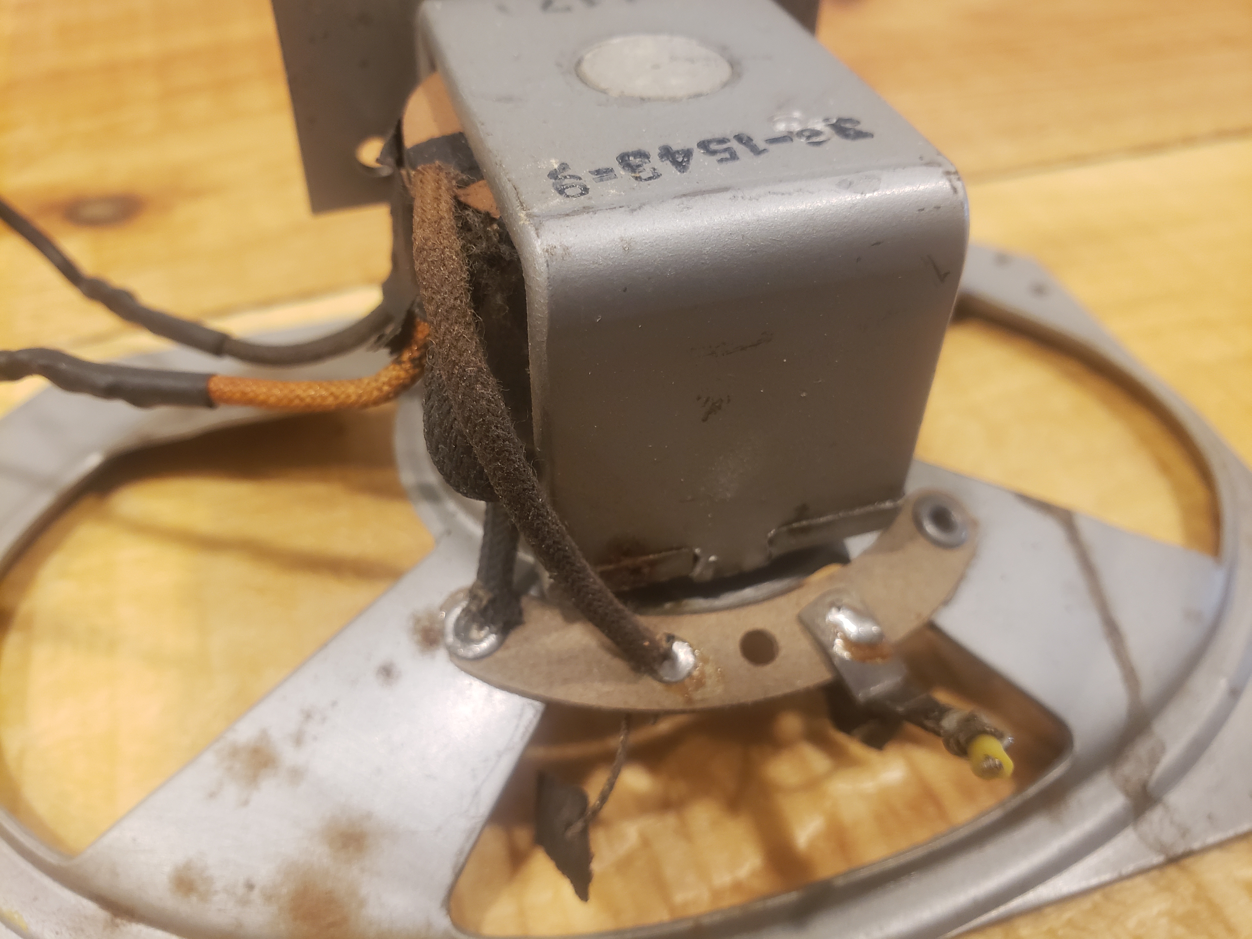

Hi Cdoyl,
Look at the old speaker carefully. There are 2 "coils" in that field coil. The one with a high resistance of 1600 -1700 is the one connected between the + terminal of the 2 Caps, 57 and 40A. The other coil is the "hum bucking" coil which you can either leave out of the circuit or put it in. However, if you use it, polarity is important. one direction will "buck" the hum; reverse the connections, and the hum will be boosted. Use the best of the 3 options. The Voice Coil does have 2 connections. one may be directly to the frame of the speaker. Car radio manufacturers did this a lot in the 50s, and Philco was a major car radio manufacturer.
The Schematic that Ron Ramirez shares in his link shows the connection between the hum bucking coil and the transformer to be grounded to the chassis.
If you can post another pic of the speaker with the voice coil and hum bucking coil connections more visible, this will be helpful, as well as a pic of the wiring extending from the Output Transformer secondary.
John, MrFixr55
Here's another angle.
One end of the speaker voice coil is connected to ground (the metal frame of the speaker) through the hum bucking coil.
I believe I would try and find a speaker from another Philco. Models 42-340 and 42-345 use the same speaker. A 42-340 parts set shouldn't be too difficult to find. You would want one with a 1700 ohm field coil.
Hi Cdoyl, Yes, that pic clears it all up, and Ron confirms it The reason that you have only 1 wire for the voice coil is because the other lead of the voice coil connects to the "hum bucking coil" of the Field. the other end of the hum bucking coil conects to the speaker frame which is screwed solidly to the radio chassis at 4 different points. One lead of the output transformer secondary is likely connected to chassis ground in a similar manner.
Getting another speaker from a Parts Set is the cleanest way to go, but by using the existing speaker for its field, connecting the one existing voice coil lead to the voice coil and connecting the other voice coil lead to chassis ground using an existing screw and a ring terminal will allow you to enjoy the radio now until an exact replacement is found.
