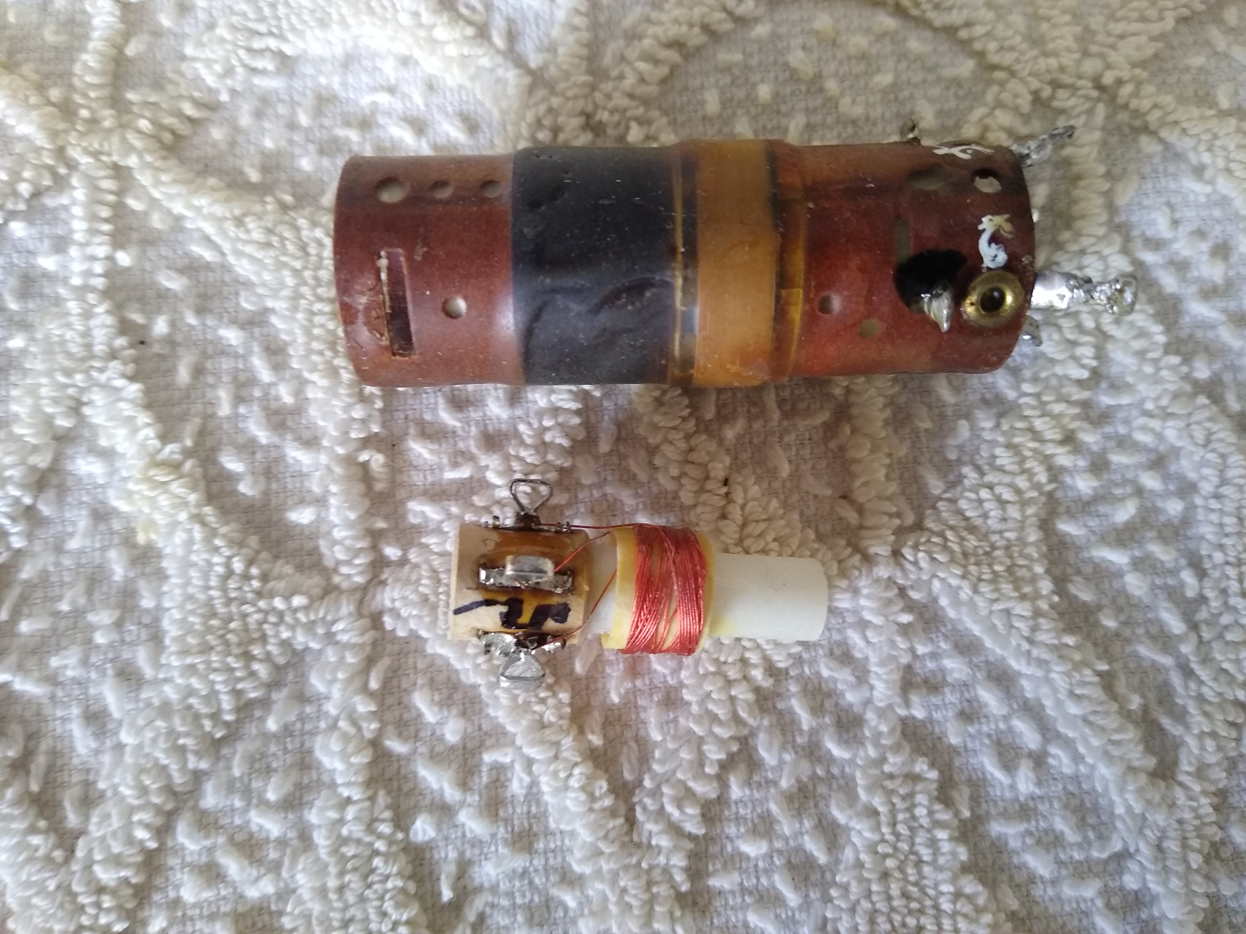

Revisiting this topic , Coil was bad on one winding. I ordered the Universal RR:  The new coil restores functionalit but two symptoms.

If the old oscillator coil has not been physically damaged as to obscure how it is constructed then rewinding the oscillator coil could be done to get the radio operating properly.
Rewinding is a process of most exactly replicating the wire size, the number and direction of the turns and using a new layer of plastic sheet to replace the celluloid sheet that may have caused wire corrosion...

Sadly the old is too far gone. I noted I put a side radio next to the Philco and set it for aprox 1000 kc.. The philco was creating interference squeling at arounf 600kc,, (I assume the OSC might be producing, but moving the slug creates zero affect.
