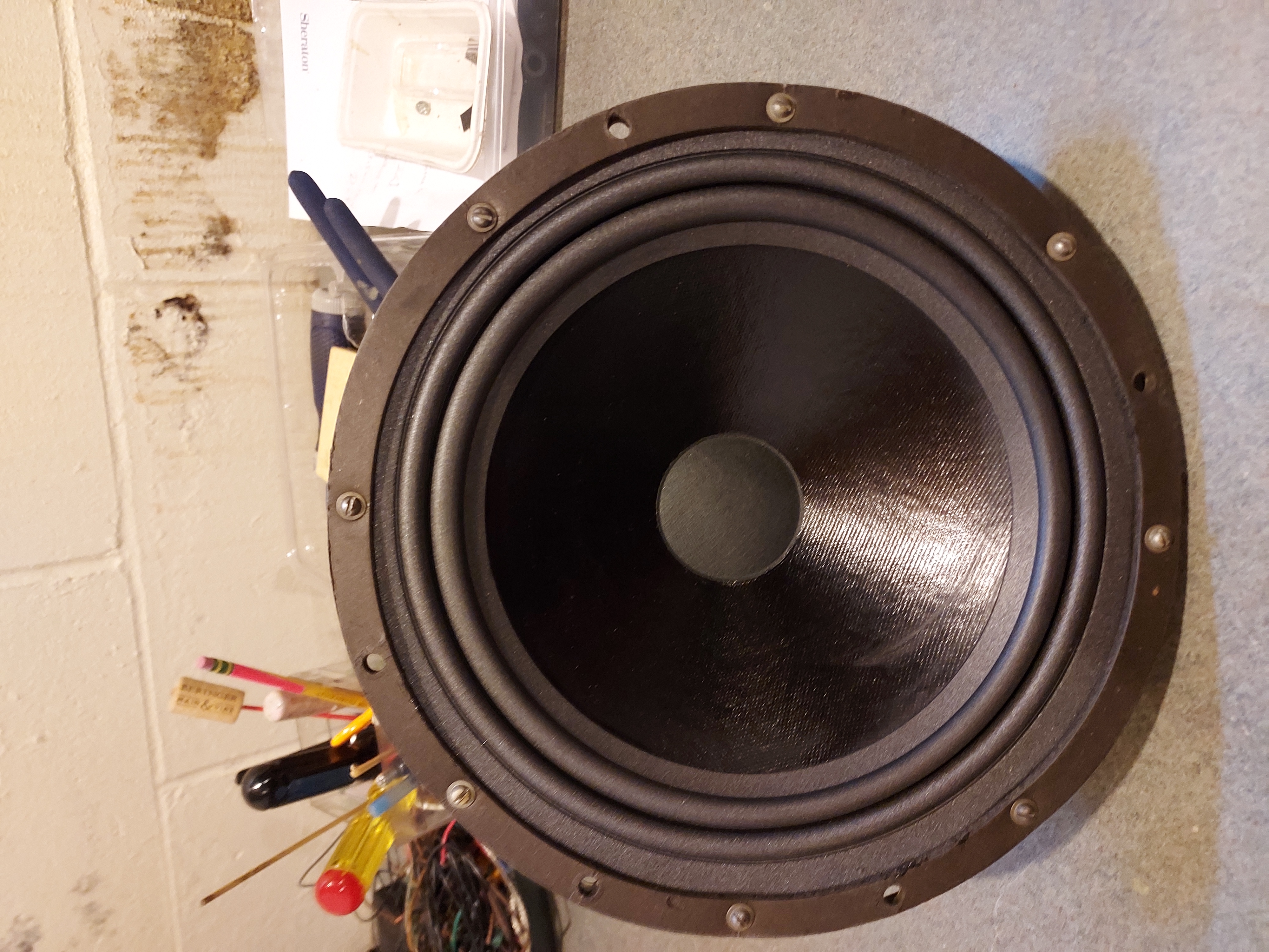

I have just finished aligning that radio.
So, I guess, maybe tomorrow I will detach that speaker, pack it and ship it on Friday. I looked at it again....I really think it needs a good cone and new spider. Even though it sounds OK.

Hello morzh,
That radio chassis is coming along nicely !
Yes I agree about the cardboard also I have notice some these old seakers are fairly brittle !

The speaker is on its way to Rich Stamer.

Has been a while.
The speaker came back from Rich Stamer.
Can't wait to hear it converting electrical signal to acoustic waves.
It took Rich a bit as he was going through hip replacement. He is feeling good, going through physical therapy and moving about, doing work on speakers. Even though he said he was pushing all the work 'till February, mine got done nevertheless.
So hopefully today I will assemble the whole thing together as the chassis's been taken care of.

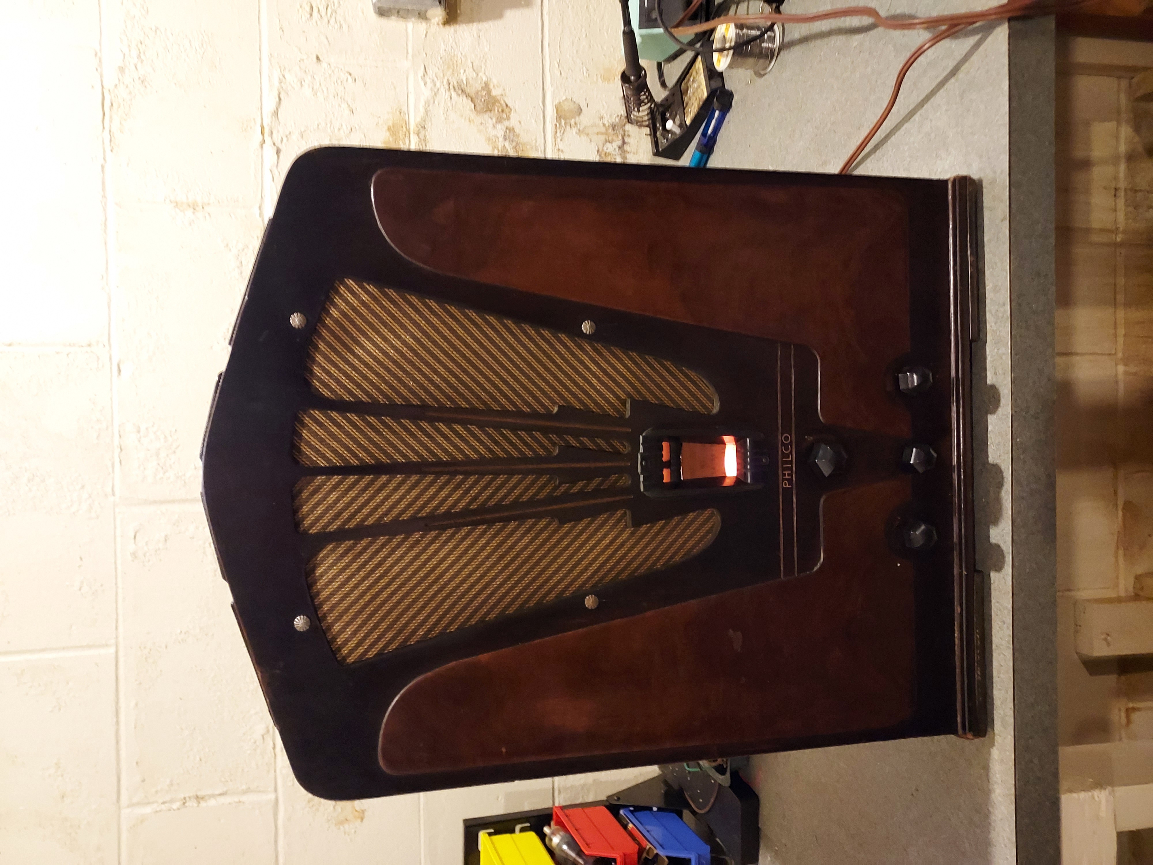

BTW, this 16's grill cloth: is there just one kind of chevron pattern (color-wise) or are there more than one, and which one should i order? Including the size?
Mike Katz has this
https://radiogrilleclothcom.square.site/...se&q=false
I have not found any chevron in Richmond Designs.
The standard sizes in Mike Katz's place are 20-1/2"x10", 20-1/2"x15" and 20-1/2"x25".
I measured 14"x11" as the cloth is glued and not stapled, so no extra is needed.

Finished.
I glued the grill cloth yesterday. This was somewhat more complicated than the others I've done. The frame is cardboard, but not rectangular, so stretching was a bit more involved. I used push pins and a smooth surface cardboard box with saran wrap on top (to prevent the glue, if coming through, to glue to the box's surface; I use 77 spray glue), stretching as I went, sticking the push pins to hold the cloth to the cardboard. Other than that, it went fine.
These are the results.

Really nice looking!! Great work on the chassis too. If that speaker has a modern spider and is 8" or bigger, I'm sure that that thing will sound great with the 2 42s in push-pull Triode Mode
Does the radio have a phono input? I know based on all the restuffing that you likely don't want to put a phono / MP3 jack in, but I bet it would sound great with a direct input!
Congrats on the great job!!

The speaker in the shouldered tombstones are 10" ones.
Yes it has modern spider, and this thing sounds amazing.
No, I do not have the phono input. I, after all, have a 38-690 tuned to the transmitter. And yes, it would sound great.
