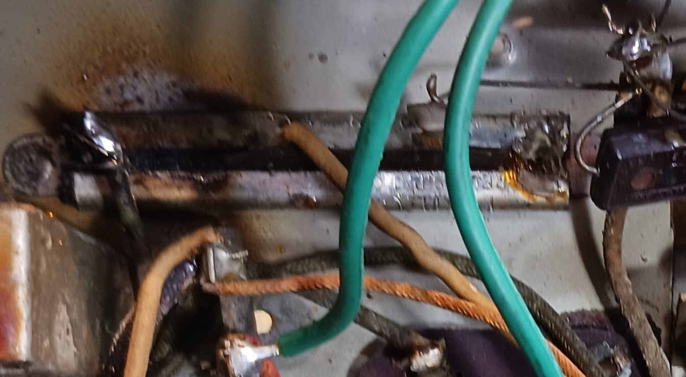

I'm part way through the electrical restoration of a 41-255, fixing some previous old repairs, etc., and I see some indications of heat and possible arcing on the multi section Candohm style resistor (pic below) labeled 61 (33-3393) in the power supply section of the schematic (below). The resistance values are close to those listed but I'd like to replace it with discrete resistors, though I need a reality check on power dissipation (no info on the parts list or the 1942 Philco parts catalog...). I've sniffed here and over at the ARF but find varying information.
The filament string has its own winding so not a factor; the 84 rectifier is supposed to be good for ~60ma. Is it safe to assume worst case is 60ma through each section of that multi wire wound? For each section of ~150 ohms, 30 ohms, and 15 ohms, I come up with drops of ~ 9V, 1.8V, and .9V, so I figure dissipation of ~.54w, .1w, and .05w. I already have some 3w and 1 watt resistors on hand and figure that should be adequate. Just looking for a reality check here to make sure I'm not wildly underestimating what I need, since the original resistor seems like a huge overkill for that dissipation. Unless of course Philco just took advantage of what was on hand or perhaps it was easy to adjust the taps for any need, regardless if the required dissipation required was minimal.

I think that you are about right. The entire current of the B+ supply passes through the resistor. It is essentially the cathode resistor for the pair of '41 output tubes. At 180V (The output voltage of the power supply), the current draw across that resistor is about 44 mA. Throw in the current from the other tubes and you approach the max current allowed for the 84 rectifier.
If you believe the RCA Receiving Tube Manual (and there are disparities, such as the cathode resistor being 330 Ohm for 2 '41s in push- pull as opposed to the 192 Ohm total resistance of the Candohm), the voltage drop should be about 14V. Multiplied by 0.06A (max allowed current for '84, RCA says 0.050A, but hey, Sylvania developed the tube, not RCA so we go with your #s). The resistor dissipates 0.8W. However, considering the pic of your Candohm, 3W would be prudent, especially for the 146 Ohm section.

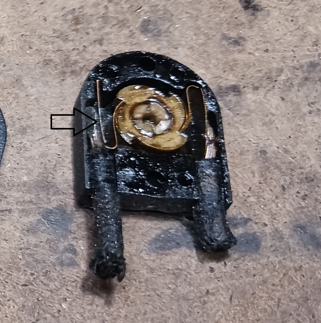

Thanks for your thoughts and suggestions; they are most helpful. I just happen to have a 3W 150 ohm resistor on hand, so that's what I'll use for the 146 ohm section. None of the resistors in the chassis were ever changed. They're all the porous type and all were out of tolerance. I've already replaced the resistors you mentioned with 1% ones that I had on hand. The previous old work consisted only of snipping some wax/paper caps and wrapping the leads of the new ones around tie points, so a lot of clean up and reworking of those as well as proper electrolytics and line filter capacitors. I'm also making the changes noted in the Philco literature for improved sensitivity and bass compensation. I lucked out on fixing the original pushbutton power switch, which failed due to one wire lead not being soldered to the copper contact inside the switch body.

Just an update for future reference... I've finished the electrical restoration of this radio and made some measurements (all with 122V AC line) in the power supply section. Overall current draw was ~395ma on the line side. The rectifier output measured 272V (vs 265) and 196V after the filters (vs 180). When measuring across my discrete replacements for the multi section R61, the 150 ohm resistor was dropping 9V, so about 60ma current as expected and just a tad over 1/2 watt. The 33 ohm resistor was similar, 2V, so about 65ma, .13w. When I removed the original multi section, I found that in addition to the apparent flash marks and scorching, the insulating paper was burned away over that same section of the resistor body.

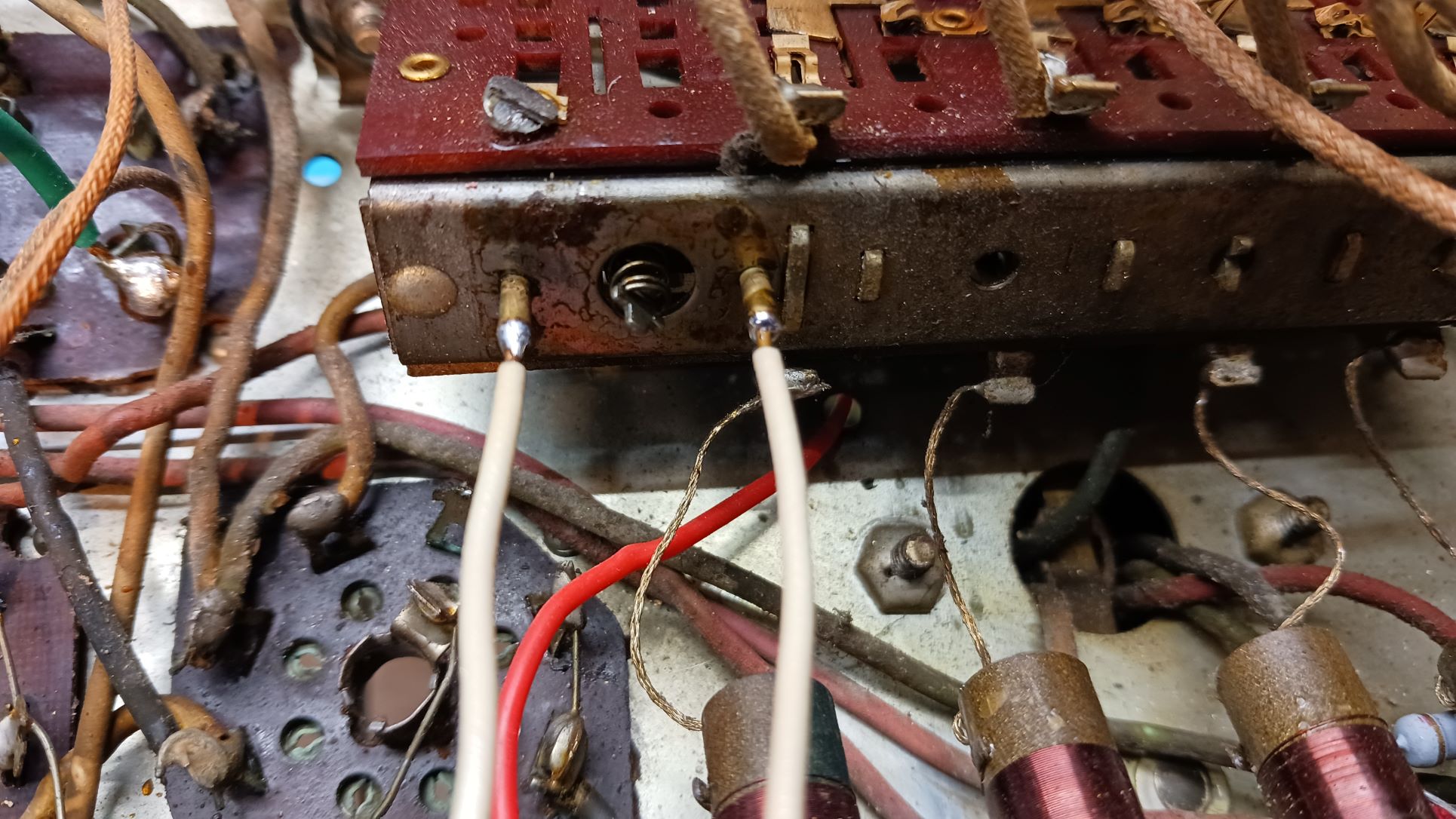

Also, regarding the failed pushbutton power switch, I attempted to replace the switch body with a similar one from Lowe's as detailed in a post here on the forum, but ultimately there was enough mechanical difference that the switch only operated correctly intermittently. That may be because of production changes to the switch available from Lowe's or perhaps I missed something. In any case, when I examined the original switch, I found it had failed because the wire lead on one side was never soldered to the copper contact in the switch. I soldered new leads to the contacts and re-installed the original switch. Instead of using epoxy to hold it in place, I soldered two sections of wire into the remaining sections of the original mount rivets so the rivets would stay in place and to act as a guide for sliding the switch body on. When the switch body was back in place, I twisted the wires to hold the switch in place. Some time later, I realized I should have cut the heads off small machine screws and soldered those into the rivets so I could put nuts/washers on, but hey...

If that contact was supposed to be soldered, you won't be able to coach or discipline the assembly line worker who did it, as the radio is 80 - 82 years old.
I have seen versions of that switch where the connection is made by push in, similar to those cheap version backwire outlets (the ones where springs and not a screw tightened wedge secures the connection)
