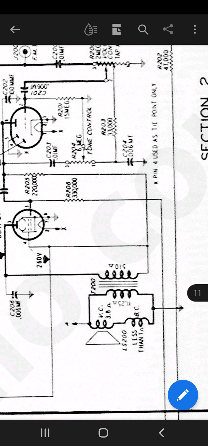

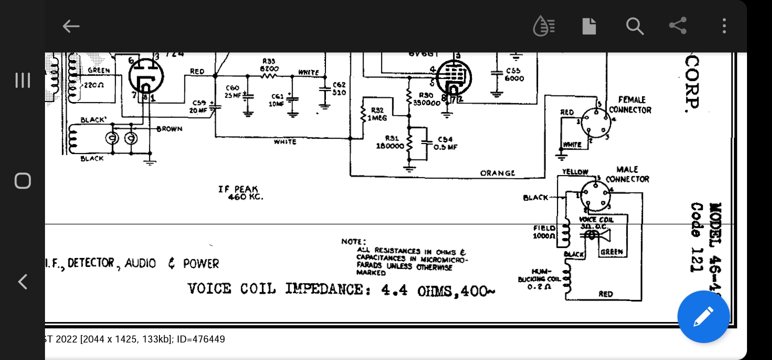

My problem is, I've seen three different versions of the schematics that all have different values for it.
One says 510 ohm, another says 1k and a third I found says 3ohm

You are looking at different parts.
510 Ohm - is the primary of the audiotransformer.
3 Ohm is probably Voice coil.
1000 ohm is the field coil and this is the value you need.

The schematic I see says -75v through 1kohm to ground, is your connection to ground. I am looking at this https://philcoradio.com/library/download...6-1947.pdf
What is your source schematic?
I have both that schematic and the one from radiomuseum.com
